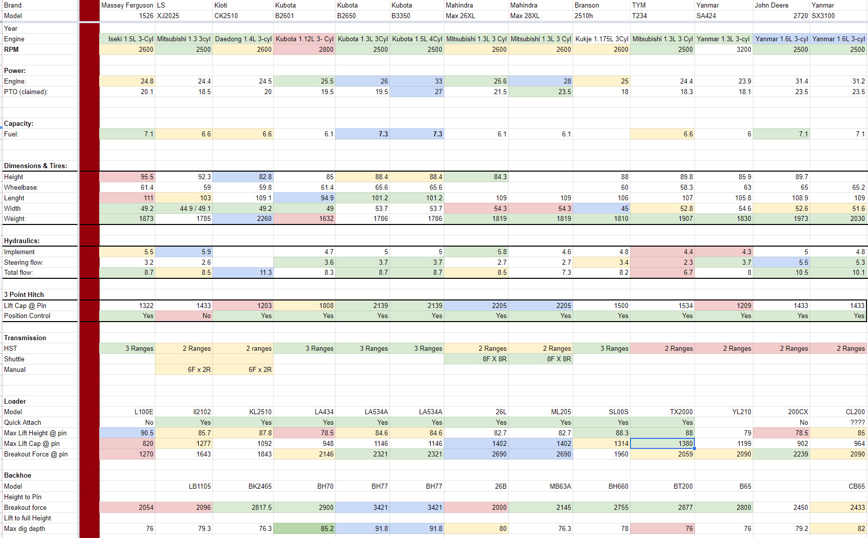

Use time and try to have as much fun as you can with this process.
You could keep your current mower and fix the irregularities of your yard with the tractor latter.
One of the reason I didn't get a SCUT was because I wanted more lift capacity and being able to pull at least a 54" box blade or Land plane.
I would narrow my search to the following:
Branson 2510h
Kubota B2650
Mahindra Max 26XLT
Massey Ferguson 1526
LS XJ2025
Any of those would be very capable machines, and nimble enough to work around your house without destroying your yard.
You need to try those and see for yourself.
It would be good if you could have a list of thing to look for
I can tell you, on paper, the most capable of those is the Max 26XLT, followed by the XJ2025 and the rest.
But to me, the Kubota is the nicest machine of all. Better control valves, decent capabilities, better components integration, fit and finish.
The only thing is the price, but 0% financing could help.
Attached my old spreadsheet, hope it helps.

Wow, thanks I'll read that and consider the bigger tractor.
