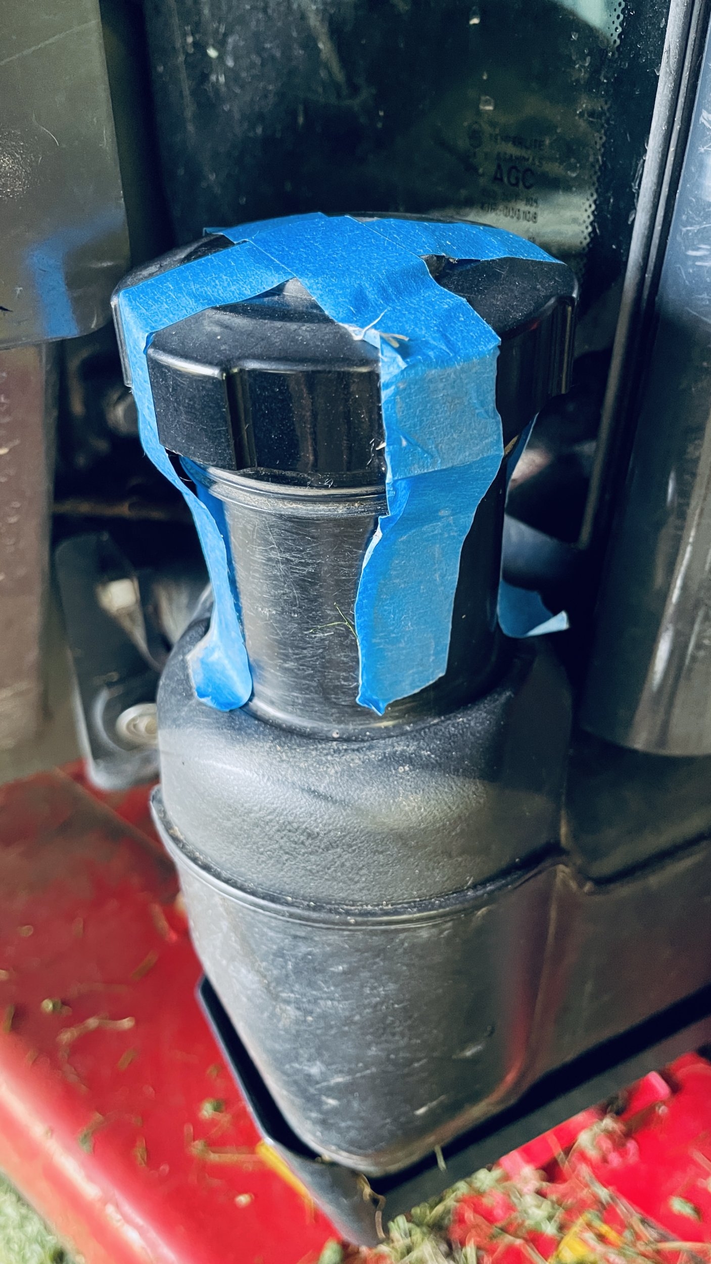

Sadly, the Saga continues...
I was feeling so optimistic that this was going to be the cause, the grass WAS a tad shorter than norm as I did rush this mow job by a day or 2. I did go about 45mins, albeit I didn't have the A/C on. When the sluggishness kicked in, I took the mower and tractor out of gear (kept at idle) and opened the fuel cap. Nothing, I was expecting a vacuum of sorts.
I hopped back on and wound the RPMs back up, I could immediately tell it had some zip so I began mowing again, maybe for 2 minutes then the RPMS started dropping, especially on the tight turns or in higher grass (not that I would classify this as tall grass to begin with!).
So to defiantly rule out the fuel cap, I went in the house and got some tape, unscrewed the fuel cap 99% of the way, so as it was rocking on the plastic threads and plenty of gap now to escape any possible vacuum buildup. Again, same thing, good for a couple of minutes and more sluggish on tight turns or slight up-hills. AC was then put on, with a little more noticeable engine RMP droppage/sluggy-ness.
   / Massey Ferguson 1740M Hydro: LOSS OF POWER when hot! #84
Well at least you have now ruled out the venting issue. However, it sure seems to be fuel related as you noticed an increase for a minute or 2 which to me seems to rule out a software thermal heat protection mode.
