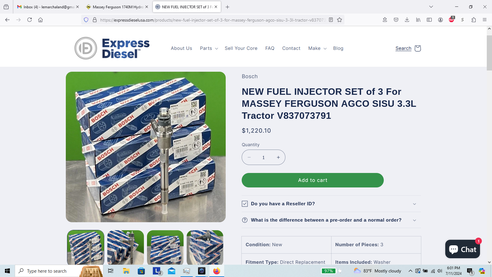

$1200 each for fuels injectors?
Or all three for $1200; but I wouldn't be surprised to see a dealer bill out $1200 each as there may be some programing recommended for each new injector. On some common rail diesel engines the serial number of an injector has to be programmed into the ECU as the serial number contains a code for the flow performance of an injector.
