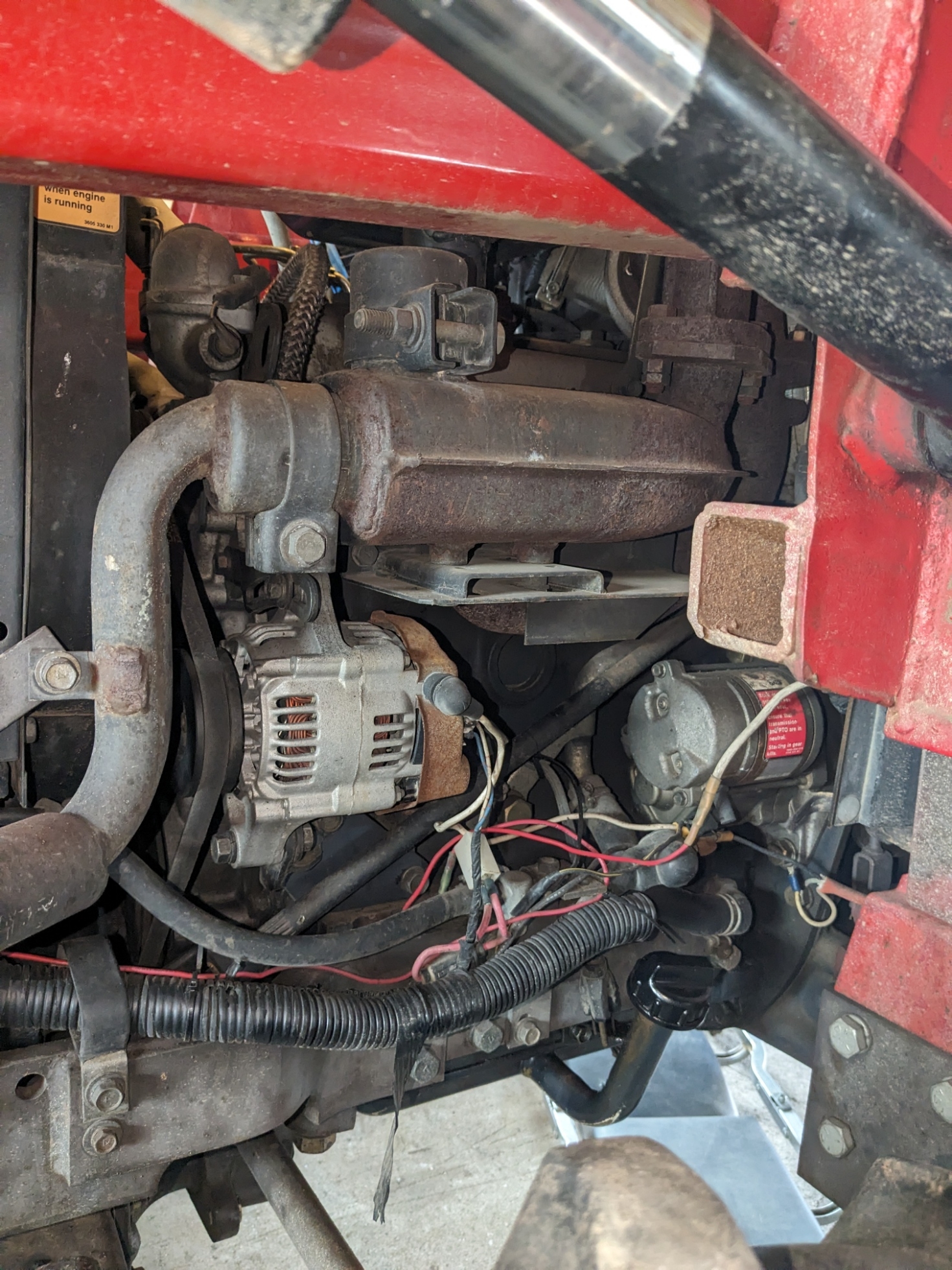

I recently purchased this 2000 era tractor with 1250 hours on it. I did not notice a knocking when I ran it before purchase. However, once I started using it, I started to notice that after 2-3 minutes of warm up, a knock develops. No change in horsepower or smoke from the exhaust is noted. I thought before I start digging around I might post a question to see what everyone thinks. The individual I bought it from States it has always had this sound and it was never really looked into it or get worse over the few hundred hours of use he had it. I, of course, fear the worst in that it being a spun bearing or a deformed piston with a wrist pin issue.
Thanks for any input!

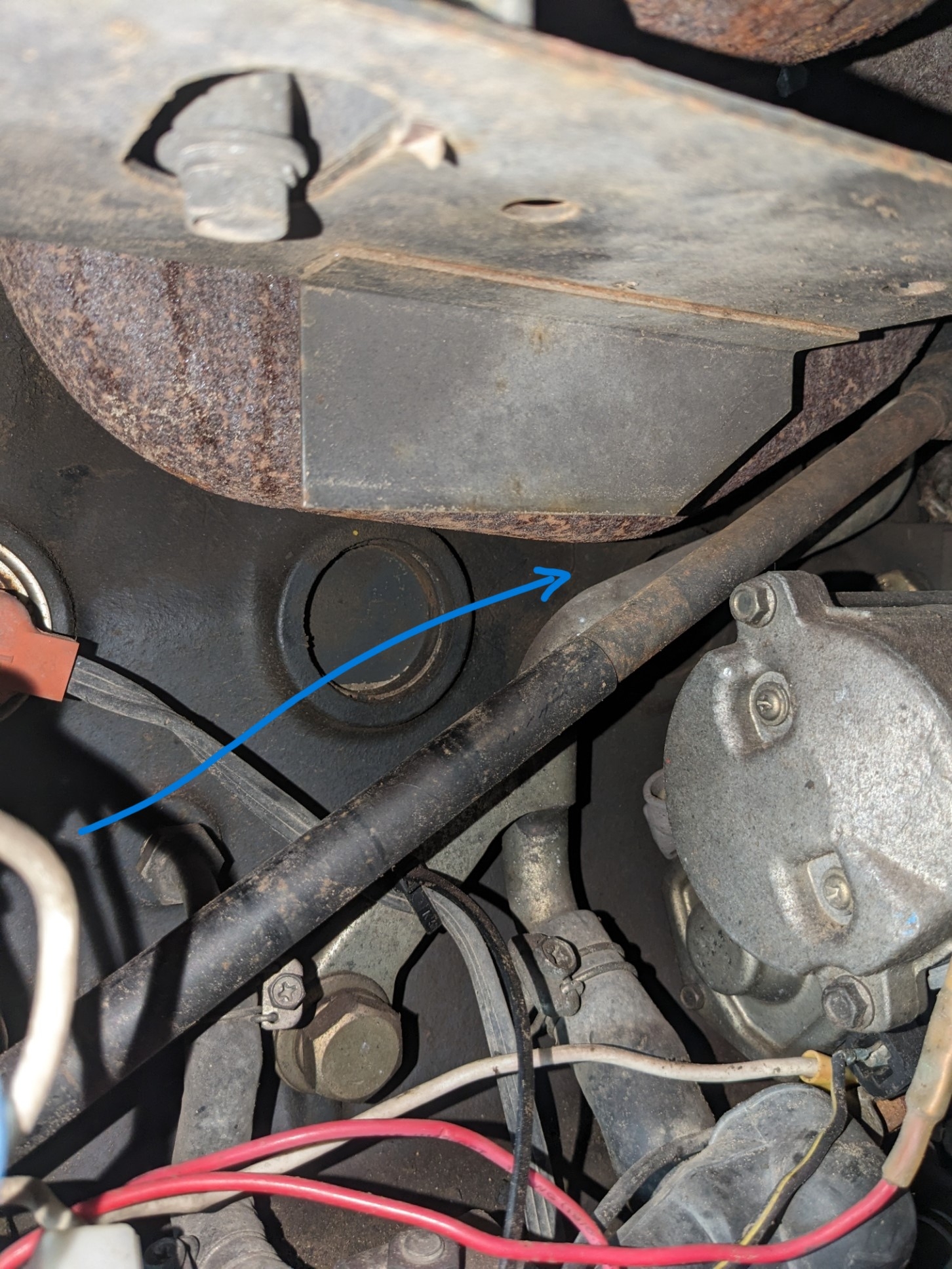

well i got a stethoscope on it this AM and tried opening and closing lines to injectors as well. Opening and closing lines one at a time reduced rpm w/o a reduction in ticking sound. Probing all over engine elicited normal sounds from valve cover, and no indication of ticking rhythm @ oil pan (main rod knock location?), however, right around top of combustion area on rear cylinder I located the tick. again this AM, when starting, it needed about 30sec-1 minute until the ticking SLOWLY and GRADUALLY (over another 30 seconds) began, therefore I think it must be related to heat in combustion area and not oil viscosity, as oil would not heat up by that time.
any ideas guys?
thanks!
