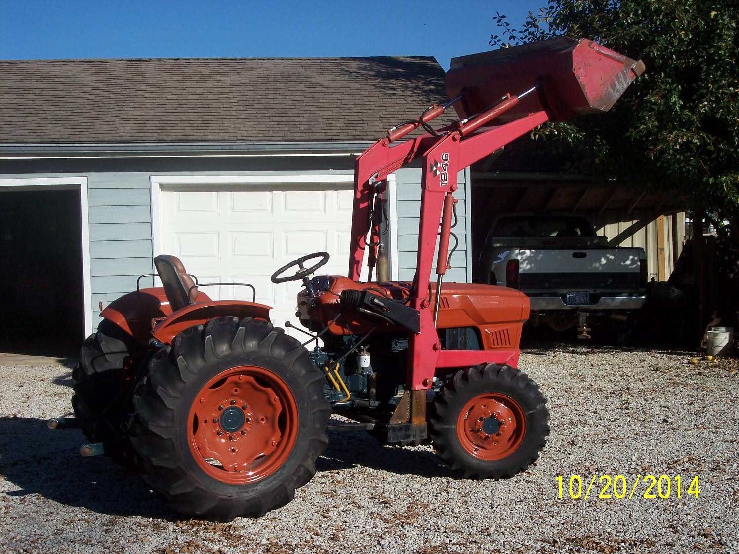

I've got a Massey 1246 loader with a Nimco valve with hoses removed. Nimco seems to keep a REAL low profile. Can someone give a picture of where the ports on the valve should go to the loader? Thanks

Just an update. Got it all fabricated, mounted and been using.
Bought a Massey 1246 loader and fabricated mounting brackets for Kubota L305DT. Works excellent.
Found a seal/set for valve, part number 71512160. Had all the internal parts for the valve.
