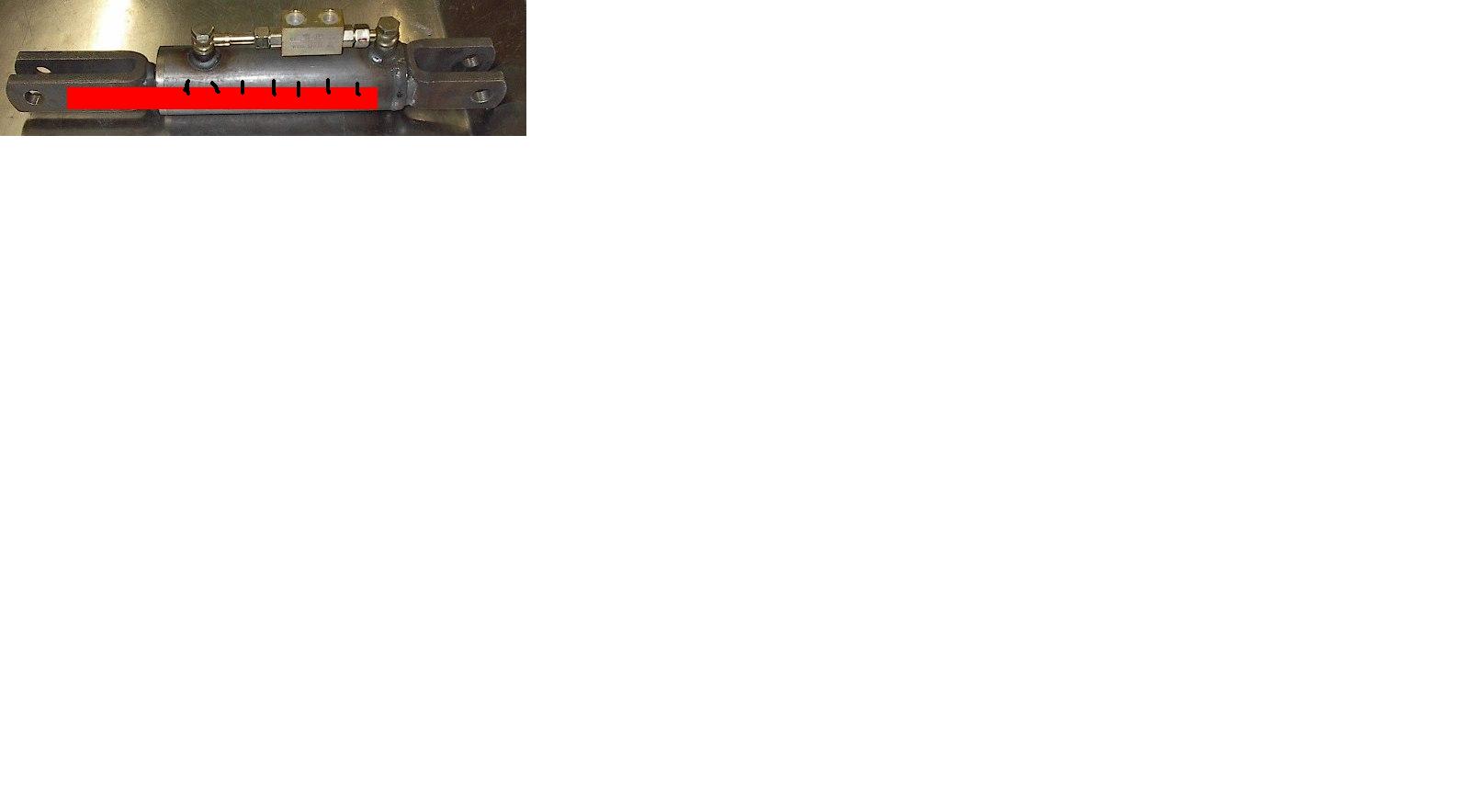

I made a top link indicator years ago.
I only used it for a little while until I got a "feel" for where to set the cylinder. Also marked my FEL indicator but same thing...after a while you get a feel for that too and you don't really need one. Pictures below are of the top link indicator and the fel marked shaft. The indicator is much like the drawings you guys posted.
Rob-
Rob-
Now there's Pride in your work......Nice 3RRL !

Thanks for the compliments guys,
I thought I'd posted a thread about making the one for the top link, but I couldn't find it?
Anyway, those indicators are now under a bench somewhere in my barn because I really don't use them anymore. Some of the old pros here were right when I made mine, that sooner or later you will get a "feel" for when your implement (or fel bucket) is set right. Plus, with the hydraulic top link, it's sooo easy to re-adjust on the fly until you get the desired results.
