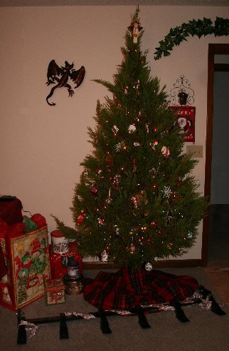

I'm not allowed to put it on until after Christmas, how is that for torture?
The folks at Markham even tied a Christmas ribbon around it and attached a personalized gift note. It looks good under the tree, but I can't wait to get it installed!

I would not be able to resist!

Did you shake it to see if that was what it really was :D
That is classic. We know where you will be Christmas morning.

The torture is going to be the pain you will feel when you go walking into that room at night, in the dark, bare foot, and catch your baby toe on a tooth of that toothbar.
I have enjoyed the beans out of my Markham bar for hundreds of hours.

I had the foresight to envision that exact same scenario! Instead of moving it to a safer place, I moved it to the floor on her side of the bed in hopes she would stub her toe and tell me to get it out of the house. I'd know EXACTLY where to put it, too!

Funniest thread I've read in a long time. Love the ideas of putting it on the floor on her side of the bed, and putting it IN the bed!!! That's a fine looking toothbar. I can't believe they put tensile around it! Really makes me wish I'd gotten one of those. I like that look better than a train under the tree too. Very festive.

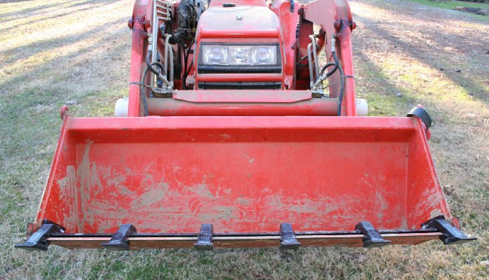

Just to finish off the thread with a couple of notes and pics...
The width of my LA463 bucket was 58 3/8" as others here have noted. The toothbar was 1/2" shorter than that, instead of 1/4" as advertised. I used two 1/2" galvanized washers on each side between the toothbar and the side wall to make up the difference.
I drilled my holes in the front of the slot in case I ever need to do the flip into the bucket technique. I installed the toothbar and used a 1/2" center punch to mark the holes, then removed the toothbar. I then drilled a small pilot hole from the inside and stepped the hole up to 1/2" using several intermediate bits from the outside. I did not need to oversize the hole using a larger bit to get it to work (I had them on hand just in case).
I did not weld on the 3/8" plates on the outside, but did install them. I will have them welded later.

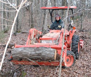

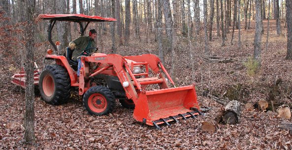

Overall, a very easy installation. I used the toothbar to move some logs and dug a hole for fun. That little bit sticking out there allows you to haul a lot more brush in the bucket alone. I can't wait until this summer to see how it digs after the sun has baked the clay soil around here into a layer of rock!
Here are a couple of pictures of the toothbar installed and moving some logs. And yes, I made the ultimate mistake back on day 1 (pic 3)!
