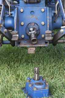

... attaching a couple of pictures... including pointing to the "reverser"... wandering what these are worth?

I would be willing to buy the reverser if you would sell it separate or perhaps the whole tractor depending on where you are located. :thumbsup:
Hate to separate the reverser from the tractor... the reverser making it useful with standard SAE PTO...
Quite a ways to Virginia... from just south of Lincoln, Nebraska!

You should be able to get $1500. maybe more . I make reversers for the S370. They run $900 new. I have parted out around 10 s370 tractors. I've sold a couple motors in the last 20 years. Other parts on a 2wd go real slow. FWD parts are the most in demand parts, but it has slowed down the last few years.
