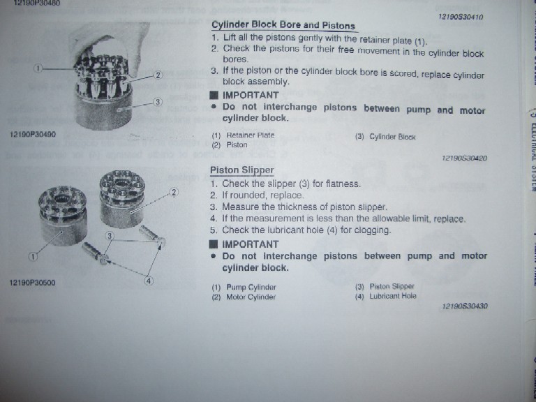

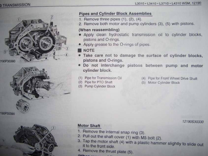

Ben,
I have a hst trans equipped tractor and love it. I also have a straight gear tractor with no syncro's. I love it too. Different machines with different purposes.
But on repairing the hydro, the housing isn't part of the pump. It just, well houses the working parts. There isn't any wear surface on the aluminum housing, so your worry isn't well founded (at least for the Kubota HST's shown in my book). If you are familiar with hydraulic piston pumps, you know what that looks like. That is the main variable displacement pump and motor that is the heart of the HST. (See attachments 1333 and 1335 from the Kubota WSM)
There is a charge pump that supplies the variable displacement pump. (attachment 1334) It uses a gear/rotor like an oil pump for an engine. Very reliable. The steel gerotor assembly can be replaced or the housing it is in. (I don't know if that is iron or aluminum. It is probably steel as the torque spec is 75-90 ft-lb. I do know that an aluminum housing oil pump in a car or truck engine can last 2-300,000 miles, so that's not a big concern if it is Al).
The seals are o-rings, a couple of press in seals and flat gaskets. They are not part of the pump / motor at all. The seals in a HST are only to keep the fluid in -> just like a gear transmission.
I'm not saying that gear transmissions are bad, no not at all. Just pointing out that HST's are not any more difficult to repair than anything else. In fact, they are probably easier. Honestly, it looks like it would take 1/3 the time to rebuild that a gear trans would and it doesn't take a press to get the gears off the shafts.
On your comment on computers and plastic. I agree to a point. Todays automotive computers have more computing power than a 1970's mainframe. By far. They are also more reliable by several orders of magnitude. The engines they control produce 2-4 times the power across a broader range while emitting less than 1% of the noxious gasses all while using 1/2 the fuel. So what point do I agree on? I don't like plastic fenders or hoods!!
jb
