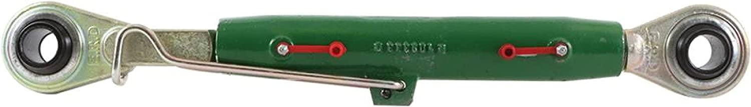

I'm looking for a better top link but don't have rear remotes. I currently have a standard one with a lock nut that needs threaded separately, which is double the work. I've found some with a handle that doubles as a lock, which seems like a good idea. Several variations on the design, but basic premise is the same. Interestingly, they all seem to be advertised as brand specific, most commonly JD, but others as well. Anyone have one? Any negatives?
/ Manual Top Link Options #2
The new Holland ones like on my brothers tn60 I like the best, which you mentioned. The handles serves both purposes, to adjust the link and serve as a lock

Agrisupply sells mechanical top links for both blue and green machines. I saw a . Pretty good collection of both Cat 1 & Cat 2 in Petersburg yesterday.
/ Manual Top Link Options #14
I used to see top links that had a hand crank handle on the side. Real easy to adjust. At one time they were popular aftermarket on older JDs for category I/II, so they may still be available somewhere.

So i have a bunch of thoughts on this!
As far as how you easily shorten a manual link, you pick up your implement and then set the rear of it down on something above ground level. Random rocks, tree stump, curb, etc and i would guess many implements have room onboard for a brick or 4x4 piece of wood etc to make this happen anywhere.
