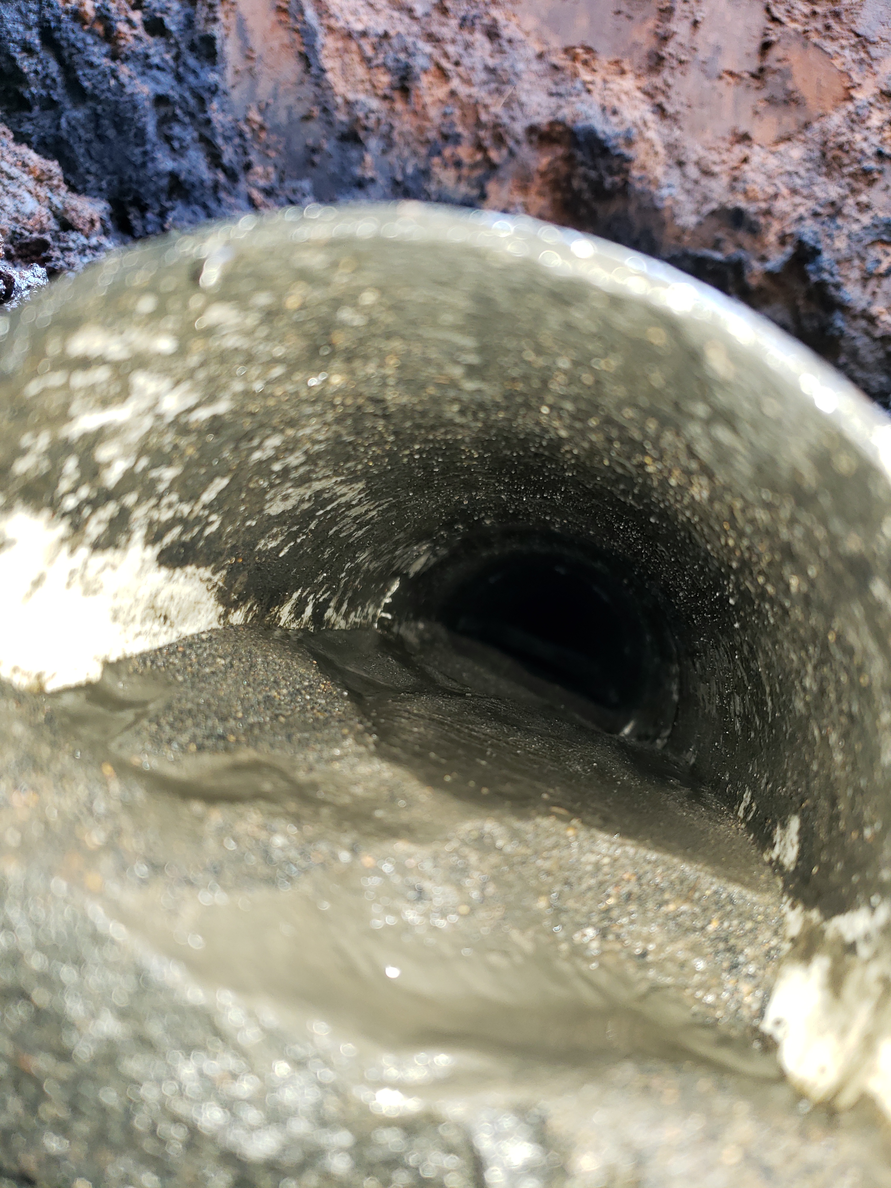

Our installs here range (as required by officials) range from the cheapest gravity system, up to advanced treatment units with sprinklers and chlorination. A typical install will require at least a single 1500gal tank, if not 2, 1000gal tanks. I don't think people understand why the tanks are that size and it has to do with time...... Time for bacteria to do the job, but with an active system, the 'time' factor is reduced substantially. The other factor is non-biodegradables that must be pumped periodically. Much of that comes from washing clothes and people misusing the system.
What shocked my family member is after I built remediation devices into the system, there is no odor! We have an inspection port so I can see flowline in the laterals and there is zero odor when that cap is removed.
When I started my learning, I went all the way to municipal level treatment plants to understand the process and this has driven my ideas. Anaerobic digesters are common for the first stage, followed by very aggressive aeration and agitation, but that can bring wastewater into acceptable BOD levels within hours of entering the plant. In many cases, the effluent is simply sprayed onto a rock bed where mother nature finishes the job.
We have a lot of people around here building on only 1-2 acres and have no foresight about the wastewater. Basic systems here generally require a minimum lot size to allow enough room to build a completely new system if ever needed. This is why advanced systems are required on some lots. No room! Or they have next to no percolation and no room for a lagoon either.
I think I just get frustrated with both the officials and home owners. Officials require maint contracts just to install a filter! I realize why, but it detours home owners and their system will eventually fail as a result. Home owners will avoid every expense they can. I think old gravity septics will become a thing of the past because something as simple as a tiny aerator can double the life of a system.
I had to explain this to my family that the soil should never stop "taking water". Yet, word on the street is lateral fields "wear out and stop taking fluid"....What gives? That black sludge in the pipes and surrounding area is NOT your poo! That is waste from bacteria. Aerobic bacteria don't do that! I will have to see if I can find pics.....lol
Attached is a lateral in FULL failure. This system now runs clear! I can see the white bottom of the pipe at flowline. This recovery process cannot be achieved in a few hours though! I guess it could be that my efforts should be towards fixing these rather than new installs, but I won't do it cheap! There was premium fecsue and irrigation over this system so digging the whole system was the last option. I had to rely on my own confidence because no one believed it could be fixed.
