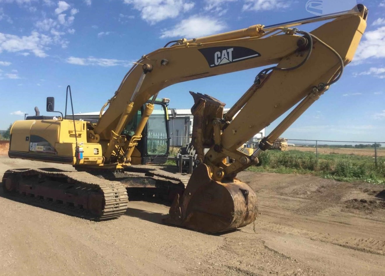

Yes guys, 27T as in 54,000lbs. 34", 48", and 60" buckets, hydro thumb, and would like to work. I think most are just talking about insurance. I will deal with that, but I am more interested in what work I might consider. I know the type of work I have done in the past which is very large municipal storm sewers, roads, bridges, etc, but I am not looking for that level of work. I think ponds are a free for all where any hooptie digger can show up and make a hole.
Hey Bob, sounds like a real nice (and huge) machine. Can you share some pics?
Main thing I am wondering.... is how you propose to transport that machine to customer jobs? Obviously you would need a CDL, Semi tractor, and heavy duty lowboy trailer. Is this something you already do on the regular? Do you need permits for a load like that?
Post some pics!

Pic of toy.

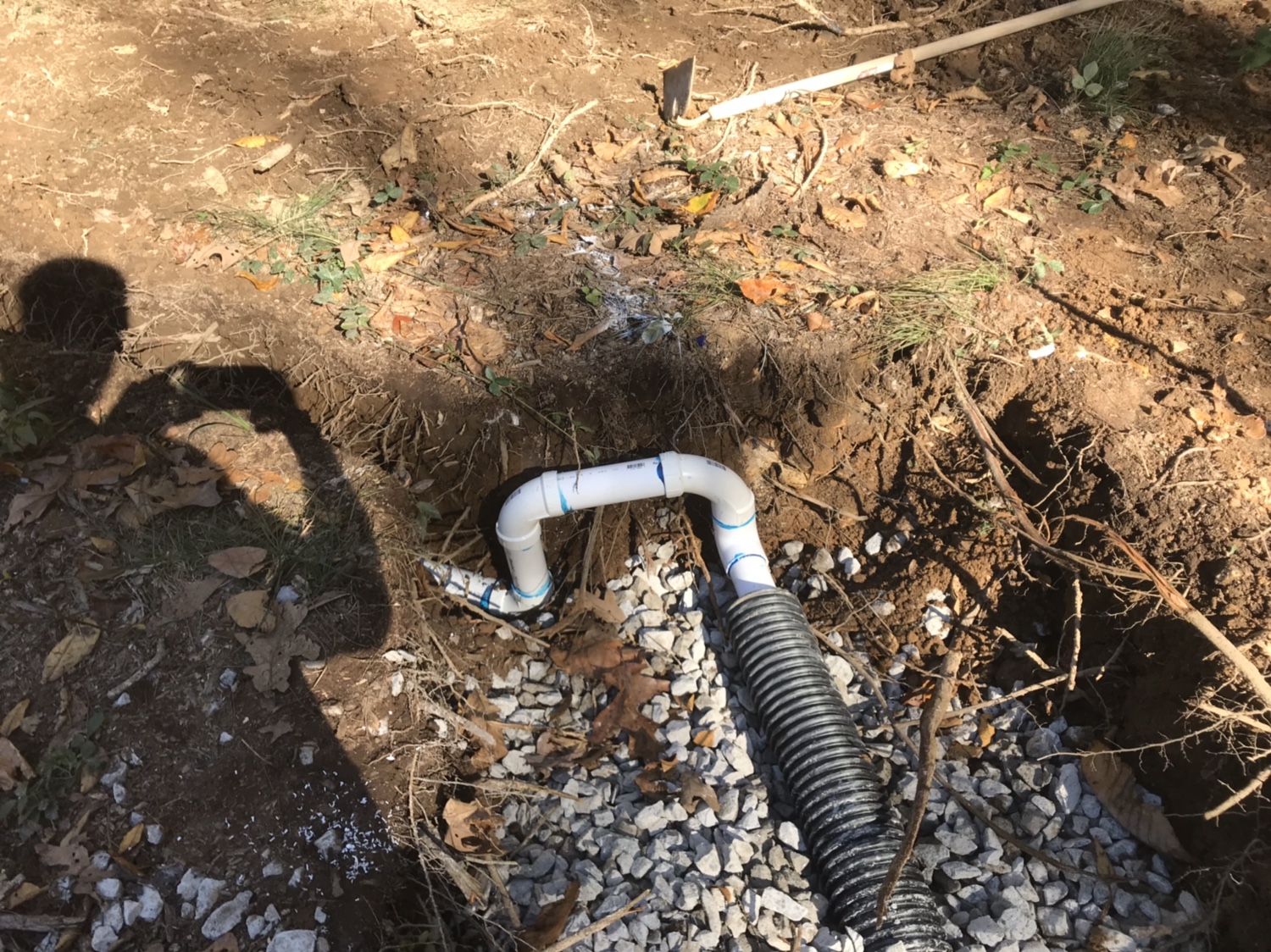

The local septic inspector made me put this in a septic pump line. If you wanted a freeze, choke and break point all in one lick it was mission accomplished.IMG_9167.JPG
