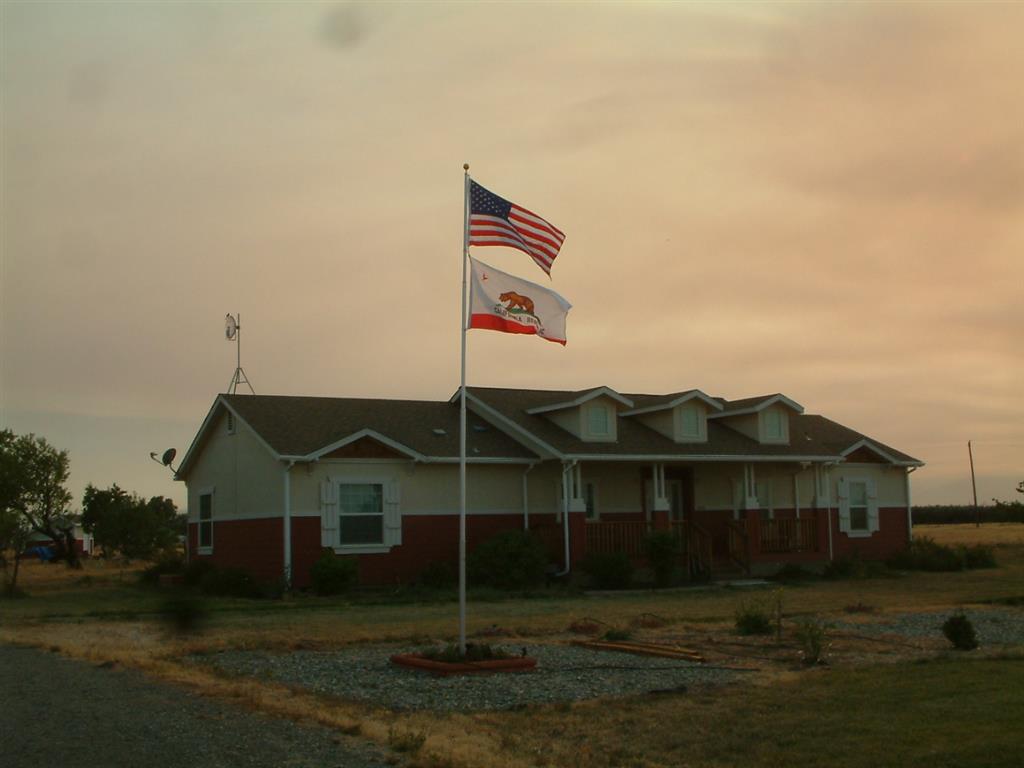

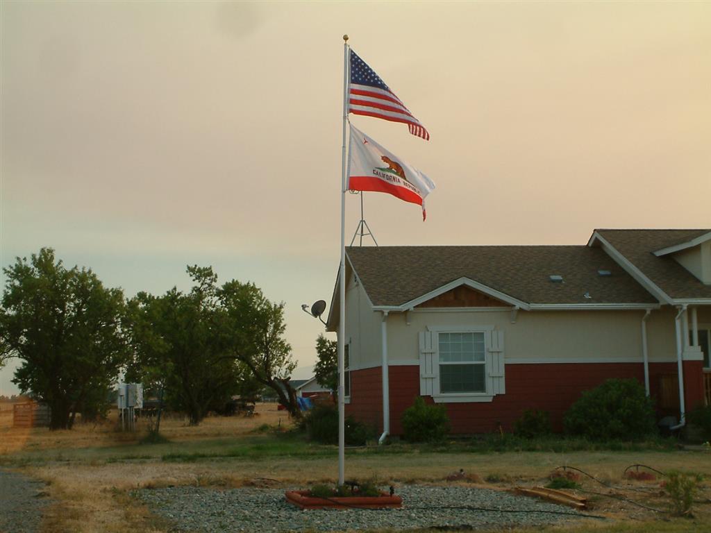

On a windy day, can the flag be removed from a telescoping flag pole easy enough, or is it a bit of a challenge? I sure like the idea of no rope to mess with.
Sure. No problem dropping the flag pole in the wind. Wind blows like heck up in the North Sacramento Valley. Shredded both flags in less than 2 years. Here's the pole on the day my brother and I installed it. I bought the pole at the Feb ag show in Colusa CA from the flag lady there. My brother bought the flags. He was visiting from the hometown, STL, and wanted to do a project at the ranch while there. Put a solar powered LED spotlight near the foot of the pole so I could fly the flag at night.
Good luck
   / Man lift for fel #43
View attachment 476815View attachment 476816
Good luck
That looks straight enough. I thought they might bow more than that on a windy day.

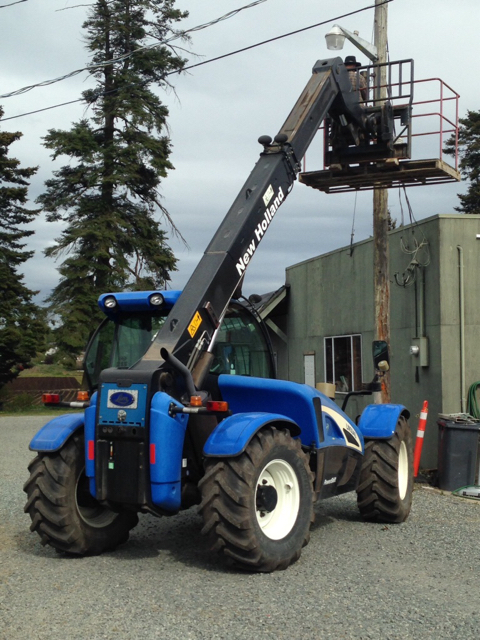

   / Man lift for fel #45
Go rent a one man tow behind manlift from a rental shop. Your idea is a recipe for disaster. Sorry to be so blunt but in this case it may save your life.

You guys not understanding.....that step ladder would be strapped SOLID to the platform, it would be no different than getting on the ladder in your garage, other than the visual effect of you being up higher...it would be a 6ft step ladder btw. BUT, I am old....and actually having harder time with ladders than I use to, not that I've ever been a fan, tend to cramp my feet. SO I'm kind of changing my idea. I've revisited an idea I had about buying a warehouse ladder for my barn. Wish I had done it long ago, just changing a light bulb there is a challenge with moving extension ladders etc. Then it occurred to me there is no reason a warehouse ladder couldn't be lifted with the forks. I've come across a warehouse ladder too, going to look at it next week. With it on the forks......step on it, left forks up...not back and forth with tractor, just straight up, keeping level. Then I just climb the stairs to the pole. Believe it's the route I'm going to go since I'd have to spend some time/money for steel/ on the other idea, and I get the use of the ladder in the barn.
