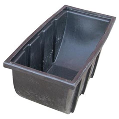

Could you use tire dip tanks such as these cut down?
   / Man I need front fenders #22
It seems like it might be easier to mount a mud flap/mud guard off the loader mount OR the front edge of the cab rather than a steerable fender on the wheel itself.

Yeah, well acquainted with local fab shops, they live off local farmers. Nothing they are real interested in doing since plastic is involved.
Why do they have to be made of plastic? I would think something like a piece of 16 or so gauge sheet metal rolled in an arc would work fine. Maybe weld 1 x 1/8" flat bar to the edges of the sheet metal for re-enforcement. The extra weight of steel shouldn't be a concern. If it was done right even the aesthetics wouldn't be bad.
