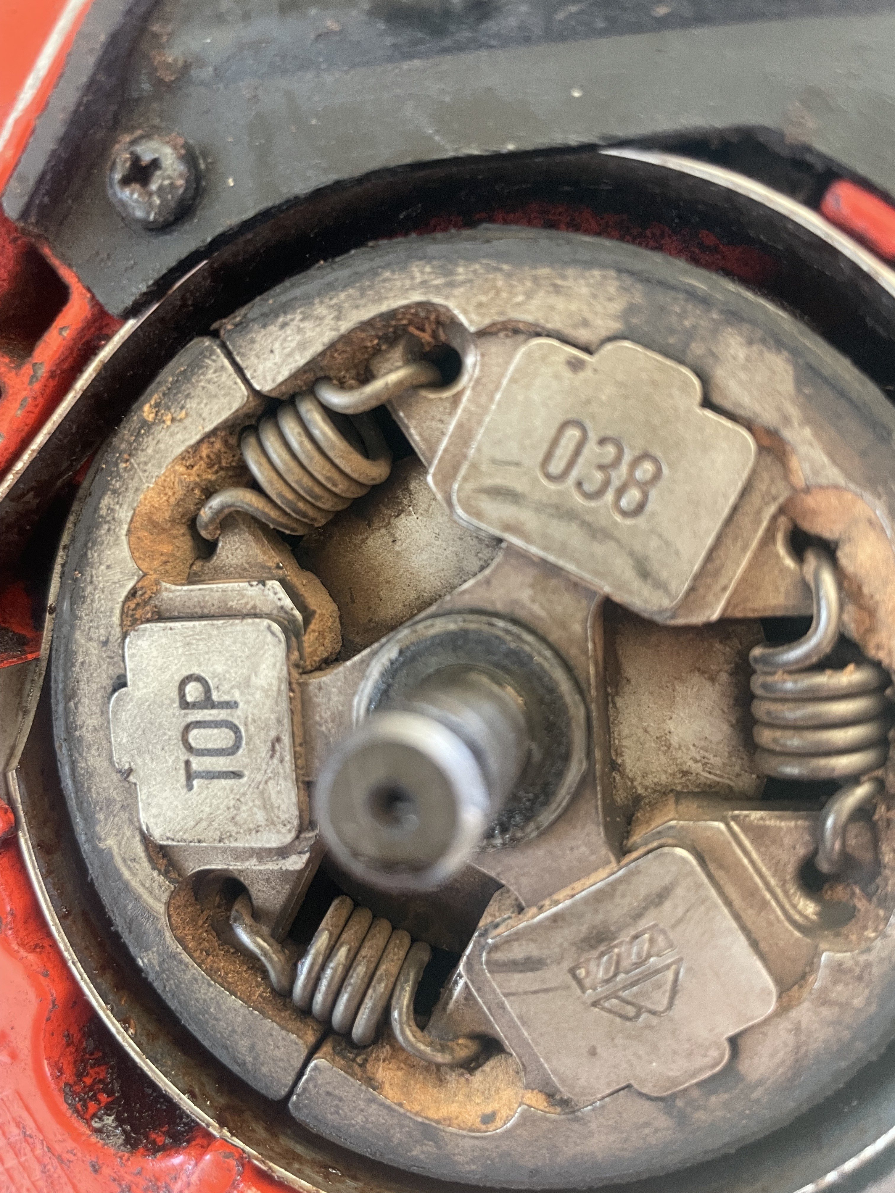

Looking for the best place to find a replacement clutch drum(sprocket)
   / Makita (Dolmar) Clutch drum parts help. EA 7300P #2
The clutch drum part number is 957 223 092. Dolmar/Makita doesn't have a lot of aftermarket part following so may have to find OEM. If the drum isn't damaged should be able to just replace the rim
Ya bearing are good the teeth are not good anymore
   / Makita (Dolmar) Clutch drum parts help. EA 7300P #5
Usually occurs with the rim is allowed to wear down past its usable point, and the chain drive links eat into the main spline housing.
It is a two piece and the sprocket disintegrated.
   / Makita (Dolmar) Clutch drum parts help. EA 7300P #7
SLE equipment has them for a decent price, I've ordered from them before, they usually have decent prices on Dolmar/Makita parts.
   / Makita (Dolmar) Clutch drum parts help. EA 7300P #8
Are you saying you just need the replaceable sprocket rim? Not a clutch drum the rim goes on?
If so only like 5 bucks and 3/8 7t standard aka large prob what you have on there.
   / Makita (Dolmar) Clutch drum parts help. EA 7300P #10
correct thanks
Can get oem or aftermarket. Standard 3/8 7T about anywhere.
Just go to local dealer. There they might get you for 10-15 sometimes for oem ones.
