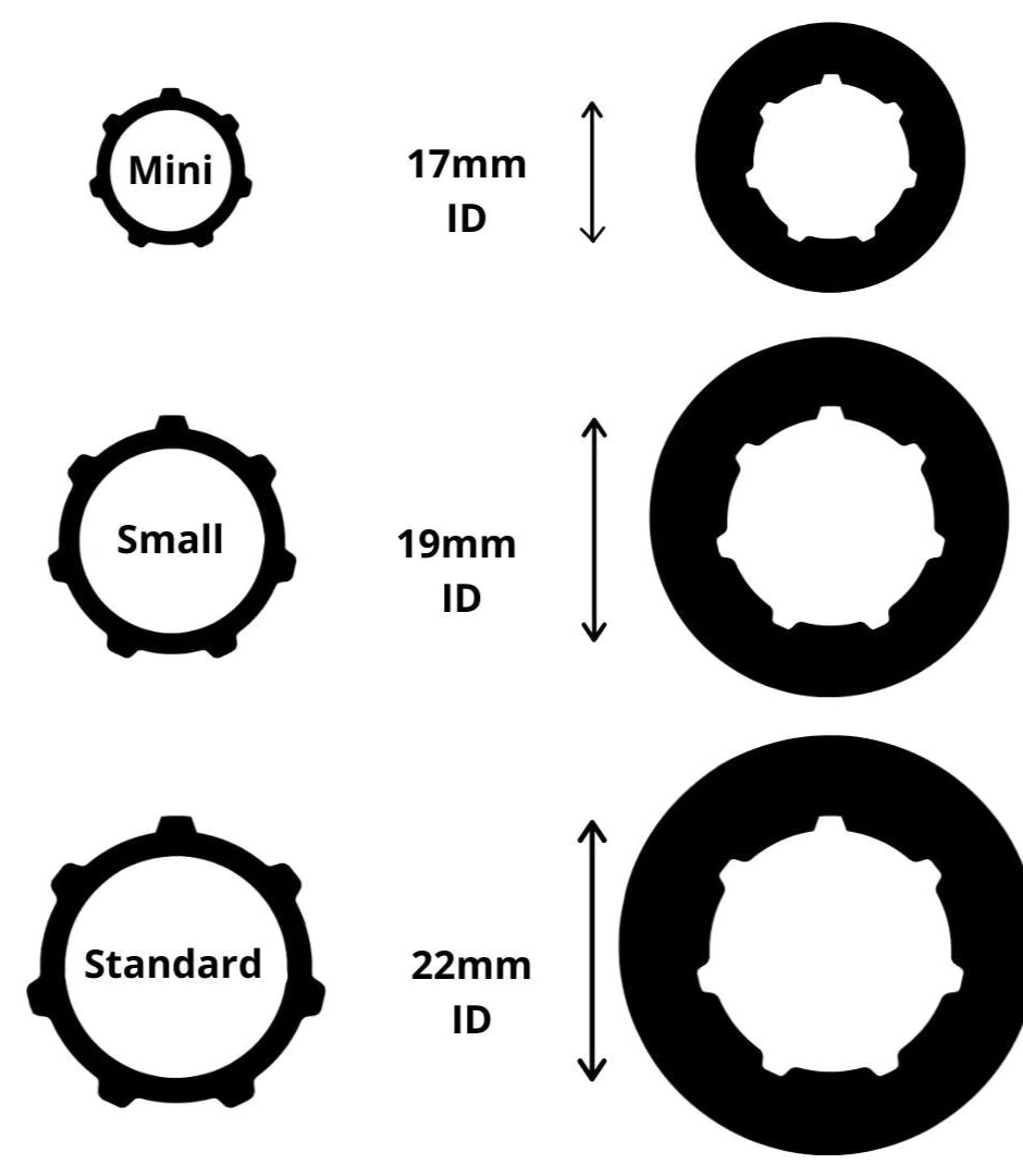

There are three common spline sizes for the drive sprockets: Mini, small, and standard. To tell the difference:
Mini: Approx 5/8" ID
Small: Approx 3/4" ID (penny fits inside, a nickle does not)
Standard: Approx 7/8" ID (nickle fits inside with room to spare)
