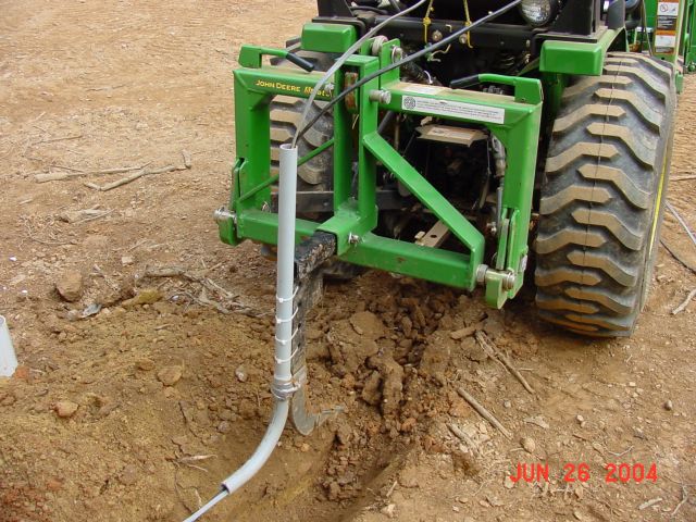

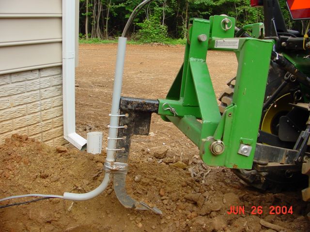

I used 3/8" on mine...here are two pictures.
Kenny,
Nice setup, home made cable layer, did you make that ripper or are they for sale? does that stiff uf cable feed thru that conduit smoothly? I can hardly push it thru!
Randy,
I'm sure you can do it a little cheaper but for sure you can also add your own custom features, I would add some rings for trailer safety chains and a place to hook a limiter chain between the adapter and the tractors draw bar to prevent the 3 pt from rising above the safe operating limit.
Then think of some other things to customize it.
Here's a pic of my flexpoint, which I can't remember what I paid for it, but might have been close to $200.
And BTW welcome!
/ Making my own 3pt. hitch #5
Kenny,
I made it, It's only been used to lay about 200' of cable, but it worked perfectly. Depth was about 14" or so...I did run the ripper through the path I was burying the cable twice first to loosen the ground before laying the cable. The UF cable had no problem feeding thru the 1" conduit.

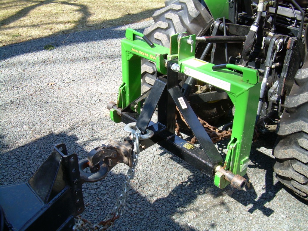

Here's is one I built.
I used 2x2x1/4" wall tubing and the 1/4" flat-stock. I that sitting around. I had to buy the pins, hitch tube, HF flipable ball mount, and shackle mount. I probably have $30 in it. Much more useful that a drawbar with a ball IMHO.
BTW, very clever Kenny!!!! ;)

I moved my uptube out further for a bit of enforcement in my mind. Personally I should had ran the tubes square and did a tube gusset on the receiver forward and back. Also the problem with uptube is the spacing. You could do this better with two uptubes and spaced further abit. The spacing would be better doing that.
Smart man!!!! :D Someone on here did exactly what you are describing with a hitch from a S-10. I would look for a square tube receiver at the junkyard.

My first hitch I did take a drawbar and built a upper section to attach to the top hook. I built the upper frame section out of 1x1x1/8" tubing and used 1/8" plate.
I did move a 1600# car trailer around with this set-up with no problems. I retired the drawbar simply because I could not turn the tractor enough where I needed. My current set-up cured that problem alot.
This is just my point of view. I am no expert by all means and I have only been welding for a while. I believe your lower horizonal section between your arms should be heavy to stout, because this really what bears the load. The vertical section can be lighter duty since it just really holding the lower section from flipping forward and back. Then again nothing wrong with over-engineering or over building it. :D
