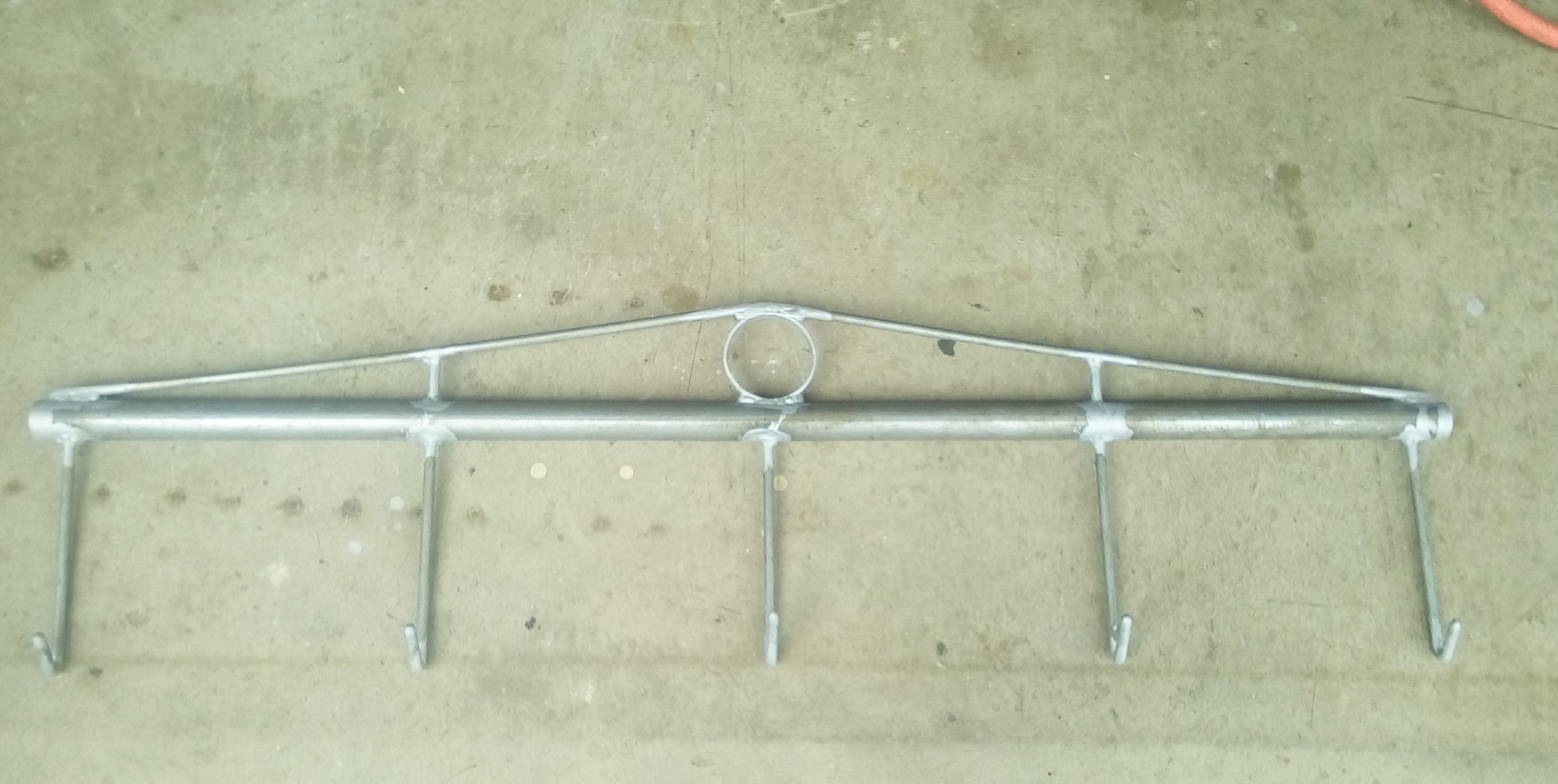

I built one several years ago to put up field fencing (hog wire as we call it around here). I think I had enough height to put a roll of barb wire on top and roll it off with the field fencing. One I get to a corner post, I would get off and close the clamping and us my tractor in low first, let the clutch out and kill the motor to stretch it tight. I only had a 240 MF with water in the tires. This might not be advised with a bigger tractor. When it runs out, put another roll on make the splice and take off again.
These pics are not the best since the clamping part is closed. It must be opened and pull the wire through it. It would take me a day or two, but I could likely get a few dimensions and another picture or two. There has been a few thousand feet run through it over the years. Several friends have borrowed it to use and to make them one. The last fence I built was about 16, 17 years ago.
