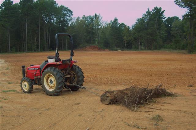

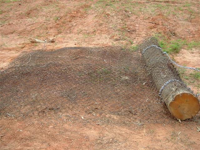

I wrapped the cyclone fence around an oak log. Then I hooked the chain to the ends of the log and looped the middle around my tow ball. This worked great for me until the log rotted out a few months ago. Maybe six years out in the elements.
Here's a few pics.
I'm going to make a new one from concrete. I've started buying the materials for it, and depending on the weather, might start on it this weekend.
