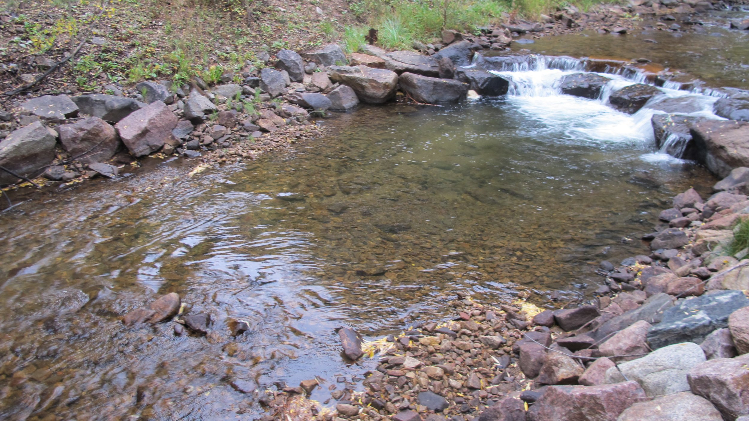

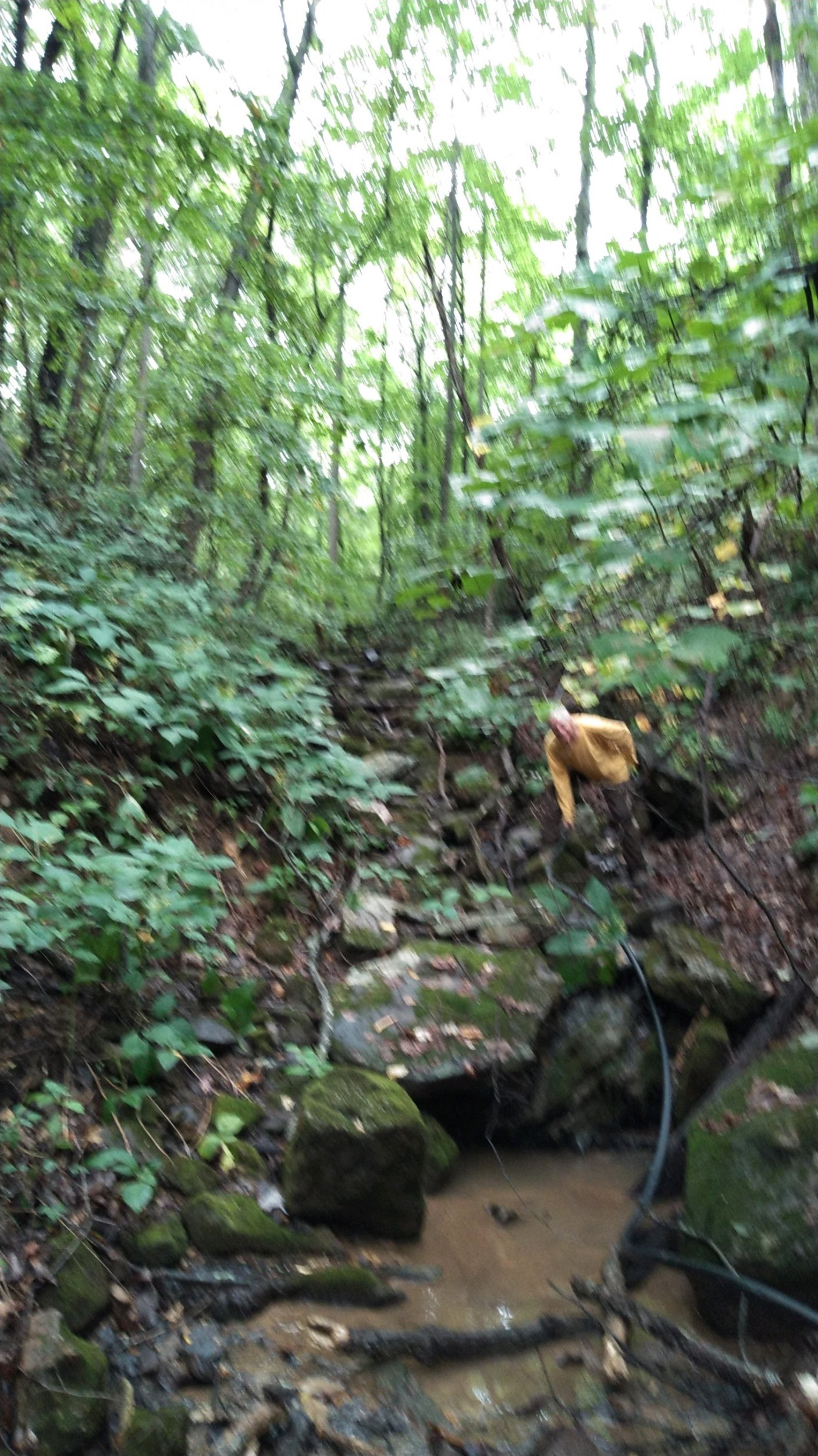

I get it....duh. My creek is only about 4' across and normally a fast Fawcett size stream. Over centuries of flashfloods where it gets 10' across and could sweep away a car it has made a pretty good gully. I've brought in loads of rocks to make a crossing for my tractor. It is above that crossing where I thought I'd make a 4x8 pond....flow thru.

If it’s enough to carry a car away twin 18” pipes probably isn’t enough pipe to carry the flow. I’m a retired land surveyor and worked for a civil engineering firm for 37 years. We designed lakes and dams and got them permitted. There is a lot of work that goes into that process. Normally small ponds don’t need a permit but it depends. Also most of the trees below the water level are cleared. For a lot of reasons I’m not encouraging you try a pond.

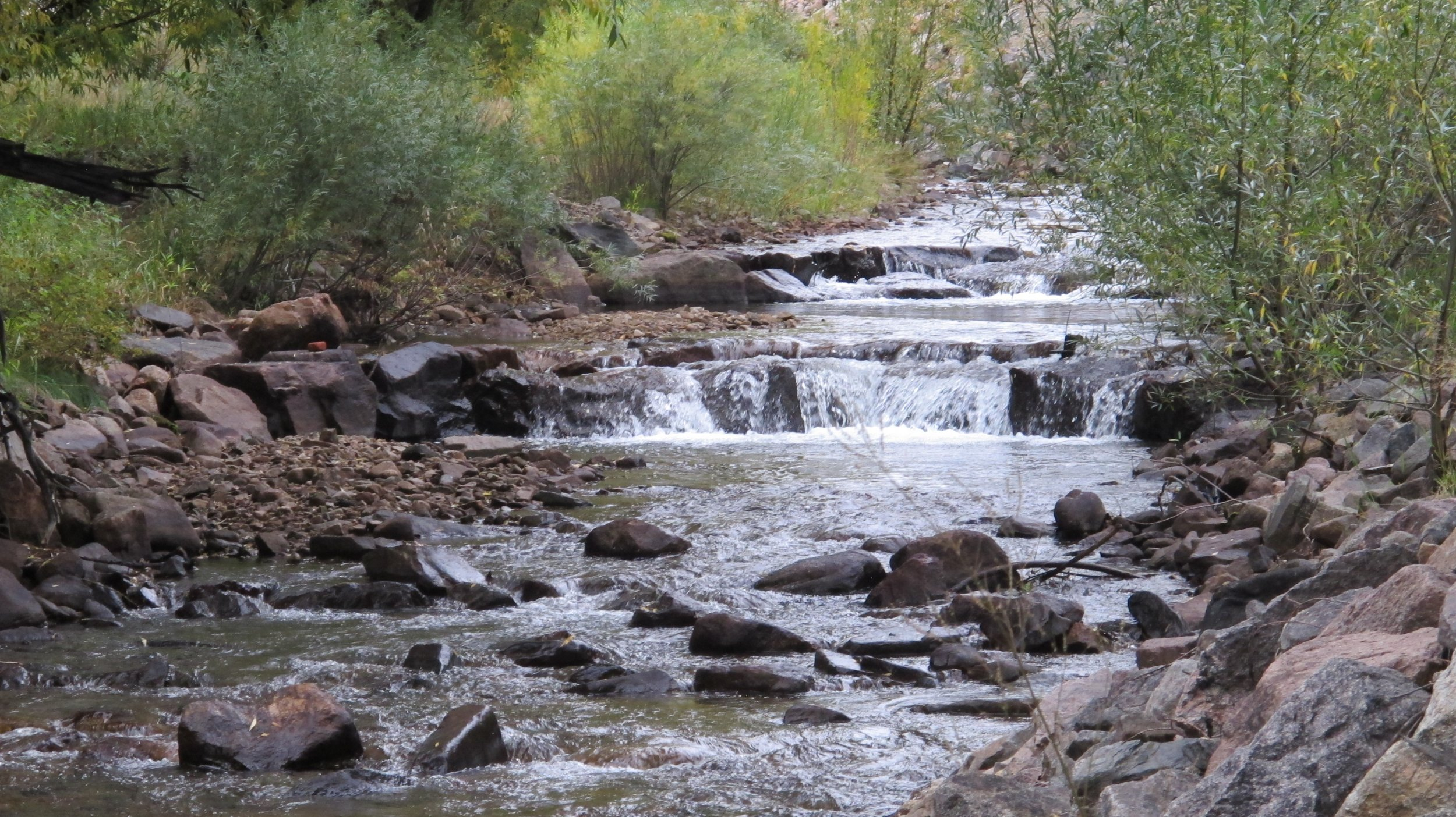

I agree, that is why I believe a "low-water crossing" as I described is his best option. It is also able to be constructed either without or with minimal permitting because it is not an impoundment above the flow level. A properly designed low-water crossing is simple to make by resisting the free flow as described. And if eventually he wants more pond, it is then simple to sit on the edge or the crossing and use a hoe to make it a bit deeper. That will eventually make a nice little pond, and the deepening does not put more water into into a higher pressure area above the plane of the normal flow.
A low water crossing typically has a stone topping so during higher flow the water simply flows over the top.
I've got 3 of them on my creek. After awhile you get the hang of building them so that there is a nice wide but shallow pool upstream and if you can get the water to drop a couple of feet as it exits the pipe it will eventually carve out a pool downstream as well.
Using the pipes allows the use of smaller rock and gravel because it doesn't have to resist the flow based solely on the weight of the fill. It is possible to build a low water crossing using large stone blocks with gaps between them and no pipes at all. I've got a couple like that for walking, but pipes make it easier for making the crossing wide enough for a tractor because then you can use much smaller material. Don't need the boulders.Building a Creek pond.JPG

that is beautiful rScotty. That's exactly what I'm hoping for. Thank you
