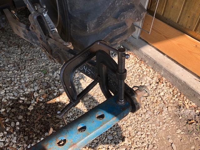

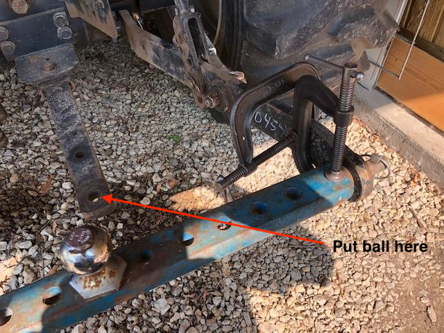

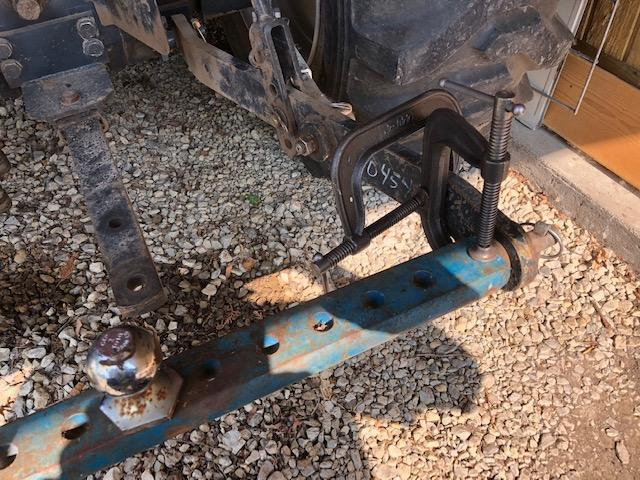

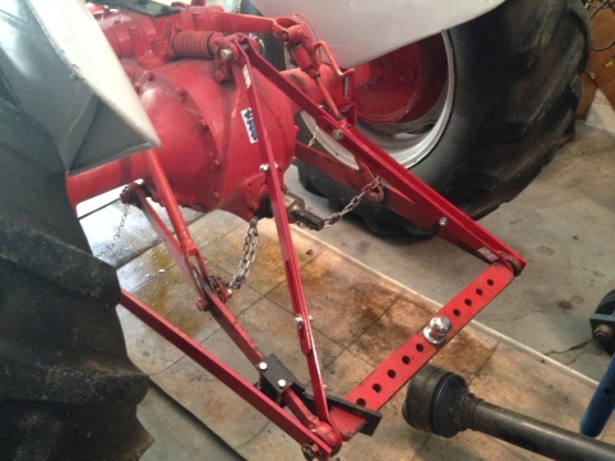

Perhaps not worth posting, but just a simple way to keep the drawbar from rotating while moving a small trailer.
Would like to see your method or perhaps aftermarket devices for doing the same.

Your "real" drawbar is right behind that bar. Just chain to it with enough slack to allow you to lift, perhaps
   / Makeshift Temporary Anti-rotate For 3PH Drawbar #4
You’ll bend the screw in the clamp. It doesn’t take much and then they’re worthless.
   / Makeshift Temporary Anti-rotate For 3PH Drawbar #5

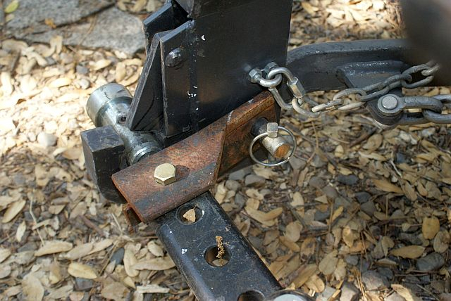

Really easy to ruin "C" clamps..
Slightly more permanent but remove's with horizontal draw bar....ITs just a piece of 2x2x1/4 angle iron...
dsc02317-jpg.704591

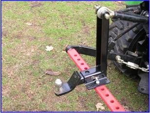

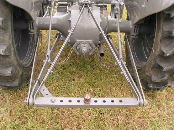

Not sure what is meant by your second sentence.
   / Makeshift Temporary Anti-rotate For 3PH Drawbar #10

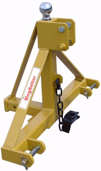

The chain keeps the 3 point trailer hitch from raising up too high and causing an accident as reported in many threads here in the past.
Should not be a problem with a empty lightweight trailer.
The chain and bracket attach to the tractor drawbar.
