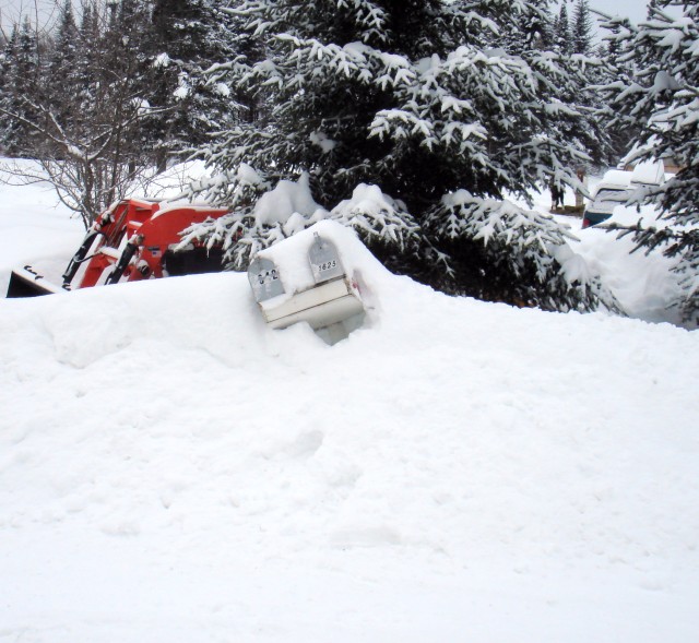

Hi,
Looking for ideas to improve my mail box's survival rate vs the town plow...
Typical rural mail on a post next to the road situation.
I made it 9 years on this mail box, a pretty good record considering how many mailboxes get nailed these days. I have reflective strips all over it and that seemed to help until now.....
Seems the town went from a 6 wheel dump truck to the new improved 10 wheel dump truck. The new one just flat out hauls butt and they seem to have given up on raising the wing when coming to drives or mailboxes...
So, who has a nice mailbox mounting idea that will survive the annual snow plow assaults???
I am have considered the telephone pole kind of post that will make the plow notice it just hit something. However the EMS part of my brain knows that trying to do the immovable object vs irresitable force is just not the right way to go. I would hate to come out some summer night and find a drunk kid in his dad's jetta wrapped around the unmoveable mailbox.
So I am starting to think about some kind of swivel/sheerpin setup that would allow the mailbox to swing away from the road when the plow monster hits too hard.
I suspect the damage is done by the wall of snow they throw at 60mph, rather than actual contact with the plow itself...
Thanks for any ideas....

I wouldn't be so worried about it getting hit if it was placed well out of the travel lane. A "drunk" or anyone else, has to pass many telephone poles, stone walls, oncoming cars, trees, other mailboxes and whatever else, before getting to your mailbox. Ours is hung from a 4x4 post w/ a cross arm, suspended by chains and works well.
/ mail box vs town plow.... #5
Put a steel pipe in the ground away from the road. Make a little ledge for another slightly bigger pipe to sit on. Then weld an arm to that for the mailbox. That shouldnt cost too much. I would put a soft stop or something on it so it doesnt swing all the way around and get smacked again.

I've seen ones like Dave posted but with a longer arm. The post sits further from the road that way. The key is an angled pivot pin that makes the arm always return to the center position. These are very common in upper Michigan.

Iron pole mounted in the ground about 6 feet off the road. A pole from the mounted one out to the road with the mail box on it. Welded between the two a large coil spring from a car.
As the plow hits the box, the coil spring flexes out of the way then springs back when the pressure against it is released.
Just don't stand in the way when it springs back.
