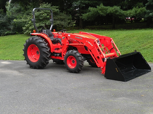

Well the tractor got delivered yesterday and has already tilled part of the garden. The tires are tubeless and the fluid is M100/ not beet juice.

Nice! That bucket looks huge on that tractor.

I really like those 5100's
That is a lot of power for physical size. Never had one but would be proud to have one, congratulations!

The bucket is only 72 inches wide. The camera angle does make it look big. It is .78 cubic yards stacked so it is bigger than the .48 cu yd bucket that would normally come with the tractor.
