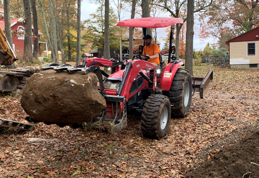

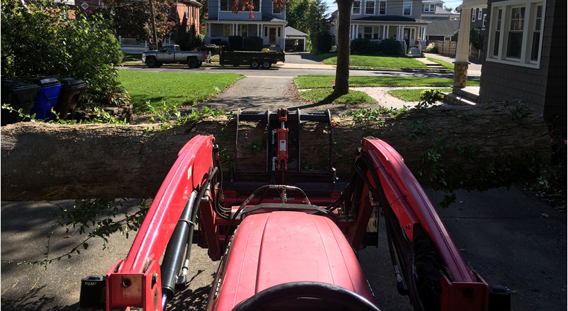

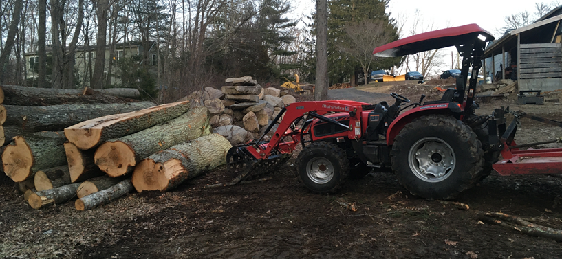

For my purposes, I went with basically the largest/heaviest machine I could tow with a pickup truck, and also has a hydrostatic transmission. For my uses, the hydro is far superior to a shuttle shift.
I think the loader capacity is pretty good in the real world, provided you have something pretty heavy on the back to counterweight. Your mileage may vary.

Interesting picture above picking up log in a neighborhood. There are zero neighborhoods in my area, (or much of anything else really :) ) just hills and ridges and small, narrow, creek bottoms among billions of trees.

This is a good post because it gives perspective on two fronts: 1. The visual itself proving the ability of the tractor 2. The aspect of hydro providing ease of use for the operator. I agree whole heartedly and this coming from a die hard shift guy. That being said;
The shuttle shift on the 3500 series makes it much easier but it is not "at your feet" control
I would reduce the size of the log just to get the hydro which is not offered in the subsequent higher numbered Mahindra line.
