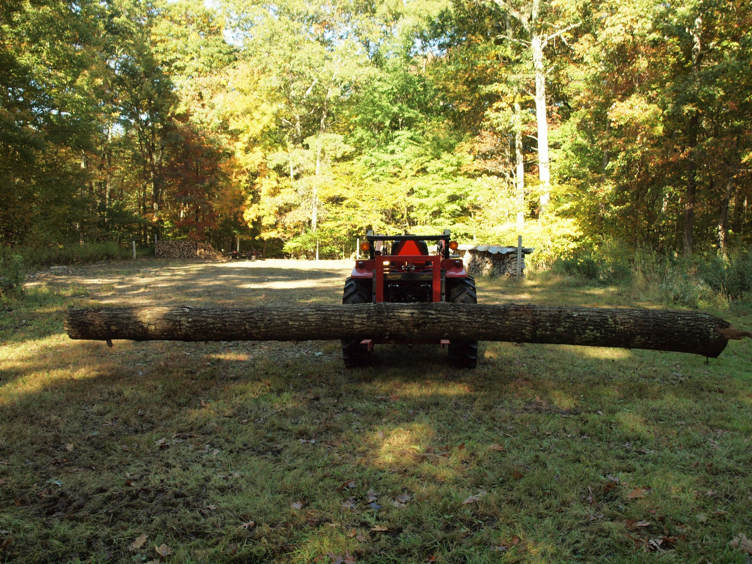

For what you've listed, I am uncertain why you are looking for a different machine.
That Kioti should do everything you're asking w aplomb. The Kioti fel is good for over 2500 lb lift.
The oak log pictured is 1800 lbs. You sure you wanna put something this large on your mill?

It's really simple: I was looking because I had a dead tractor since April. At my age, 77, time is even more precious than it once was? Plus we live on land and tractor is important here bouts.
I know log weights (woodweb.com has good charts for working in wood;) ) and have owned my WM LT15 sawmill for over 20 years-had a bunch of large logs on there. The mills frame width is well known too-28" and length w/o extensions is ~ 17'. I've sawed some larger by taking a slice here and there before and large logs are a chore on a manual mill so I use a chain hoist and nylon strap to turn the big boys. These mills are robust enough to allow any log that they might saw to sit there w/o issues. The off-grid cabin I'm building (when I have a tractor, which hasn't been since late April!) the foundation consists of concrete piers that have a connected assortment of oak 6x10 beams bolted to them. One particular beams weight is very well known to the ring finger on my left hand as it decided to squash that finger to about not much last fall while doing a two-man job alone. I drove my tractor out of the woods-~ a 15 minute run, then drove myself to our clinic to get whats was left of my fingertip attended to. I now have a decent newish fingernail.
That log pictured is far from my larger ones to be honest. I have a white oak that tipped which has a root ball thats maybe 15' in diameter and butt end is about 32". Extreme rainfalls for 3 years running has caused some big ones to no longer be held by thin hill soils. The biggest ones are around 135-150 years old on our place. I only saw for myself so I cut mostly falls.

If you are off loading logs, I'd want a larger machine as well.
That pic of my log went no higher than 36" off the ground when I used the front end loader to stack it. Don't trust anything higher than my head when sitting on the tractor.
