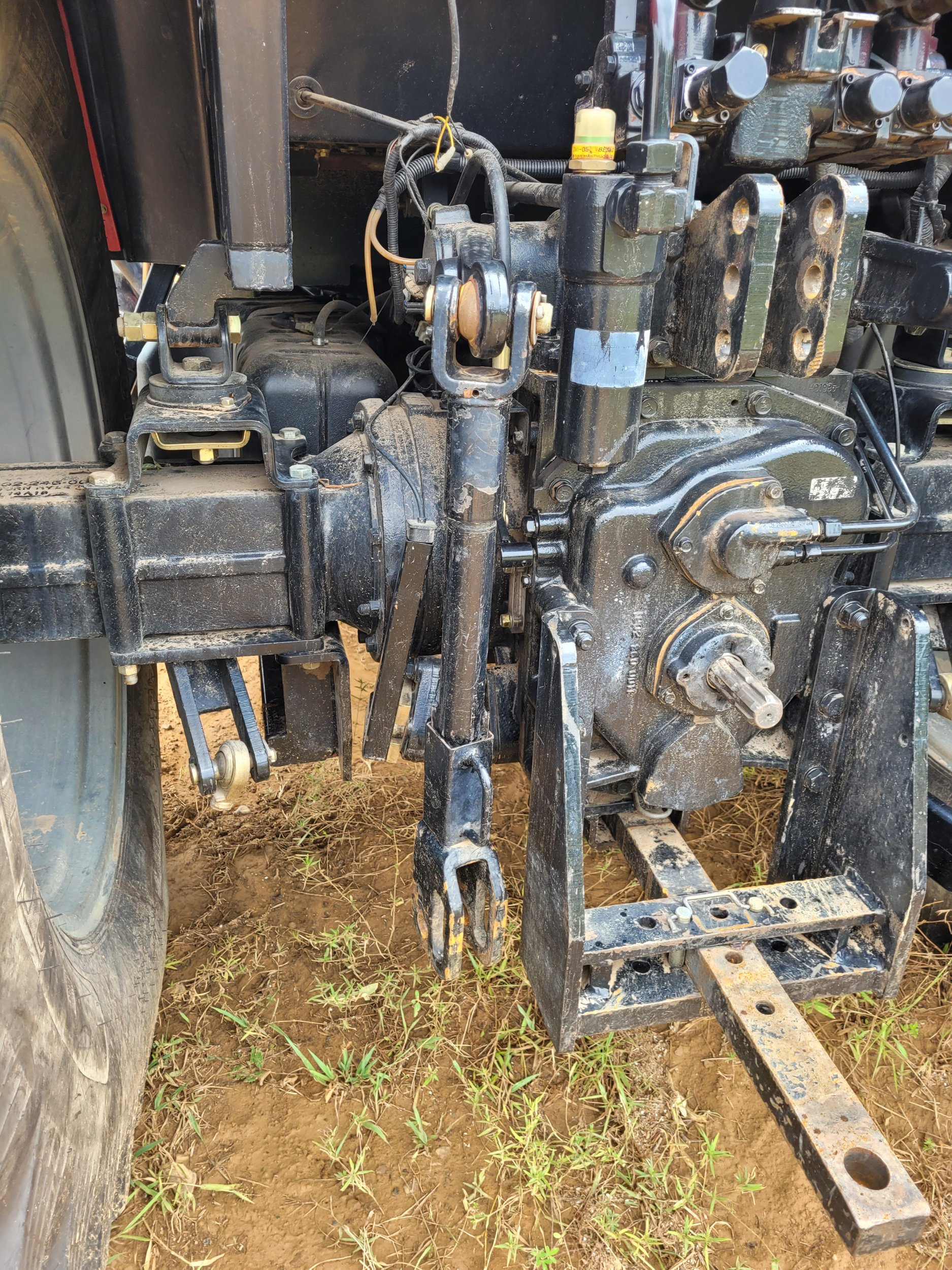

Hello Everyone,
I am glad I found this place. Plenty of great info.
To get one thing out of the way.... Yes, I am stupid. :)
The cotter pin that secures the big pin that connects the lift arm to the lower arm came out. That allowed the lower arm to drop to the ground. Not a huge problem.... Until I backed over it....
Here are some pics of the damage:

Ouch, may want to be sitting down when you price out the pin at the front. It's the draft sensor.
/ Mahindra mForce 100P - Three point trouble.... #3
Hey...you just added some "character" to your tractor. I have several of those of various origins on mine. ;)

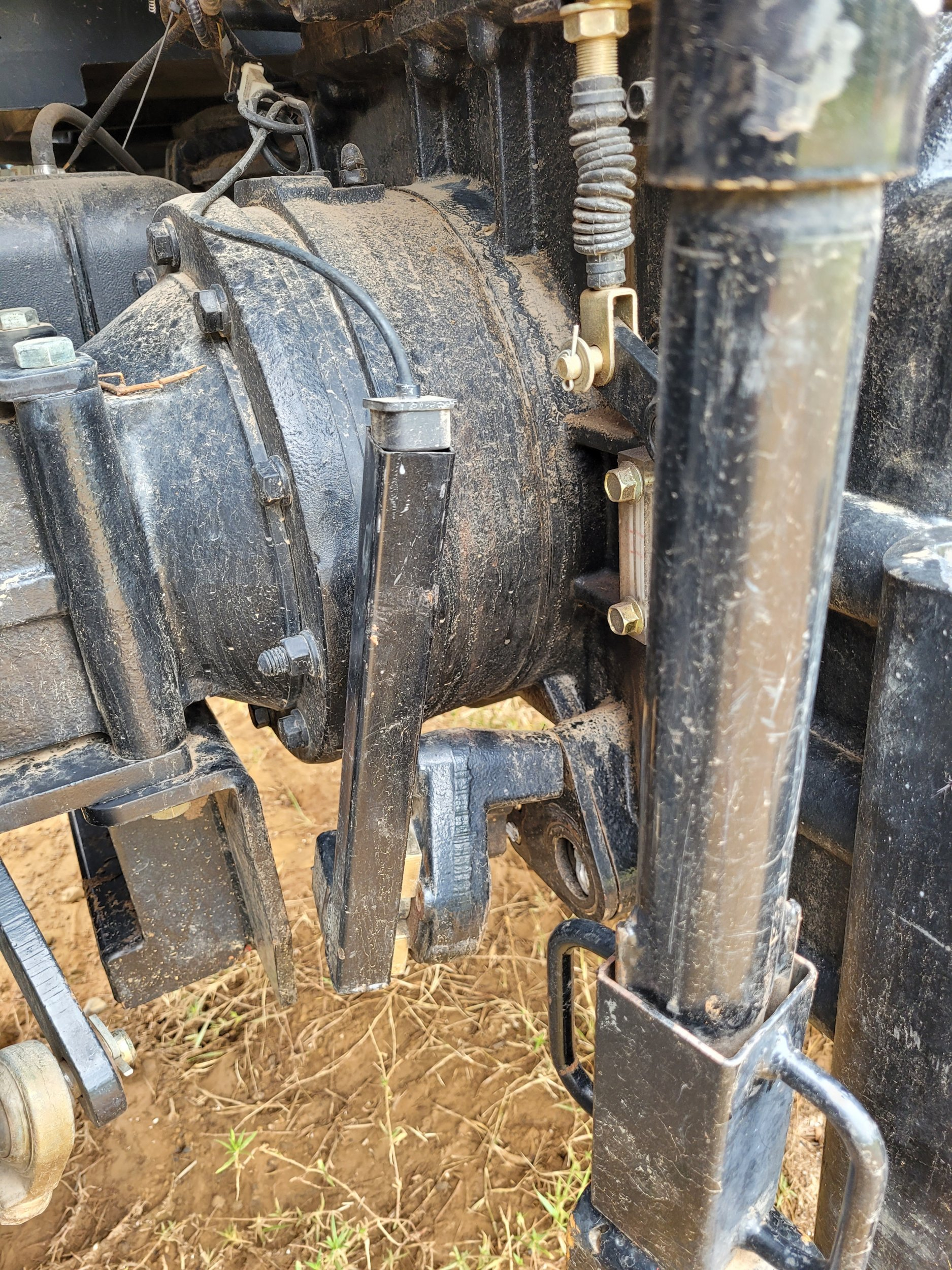

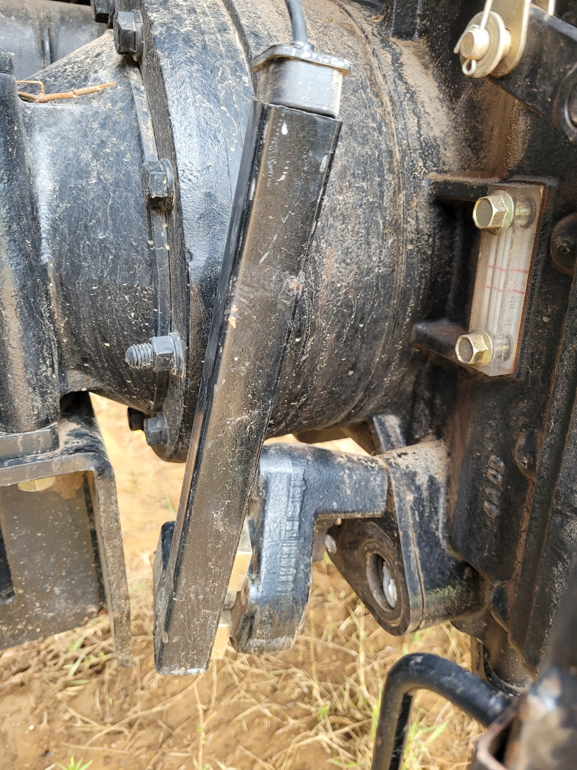

I feel pretty good about putting it back together except for one (BIG) item.
The shaft that the forward end of the lower bar pivots on sheared off. I know that shaft plays a part in some of the fancy functions that I don't currently use.
Splitting the case to replace the shaft looks like it would be a big project. Definitely beyond my skillset.
Could I fab a new "pivot" for the lower arm and run with it? Or will the sensors and computer get unhappy and refuse to play along?
/ Mahindra mForce 100P - Three point trouble.... #6
I wouldn't even worry about the draft sensor.
Getting the other bolt pieces out and praying that the case isn't cracked.
/ Mahindra mForce 100P - Three point trouble.... #7
As long as the hitch is still moving up & down, yes. Should only affect draft function. Only had that happen on one & that was years ago. They just bought the part since they used a mounted plow on it. Similar situation as you and it didn't crack the case. YMMV. Edited to add, that is a blind hole. Doesn't go all the way through the case.

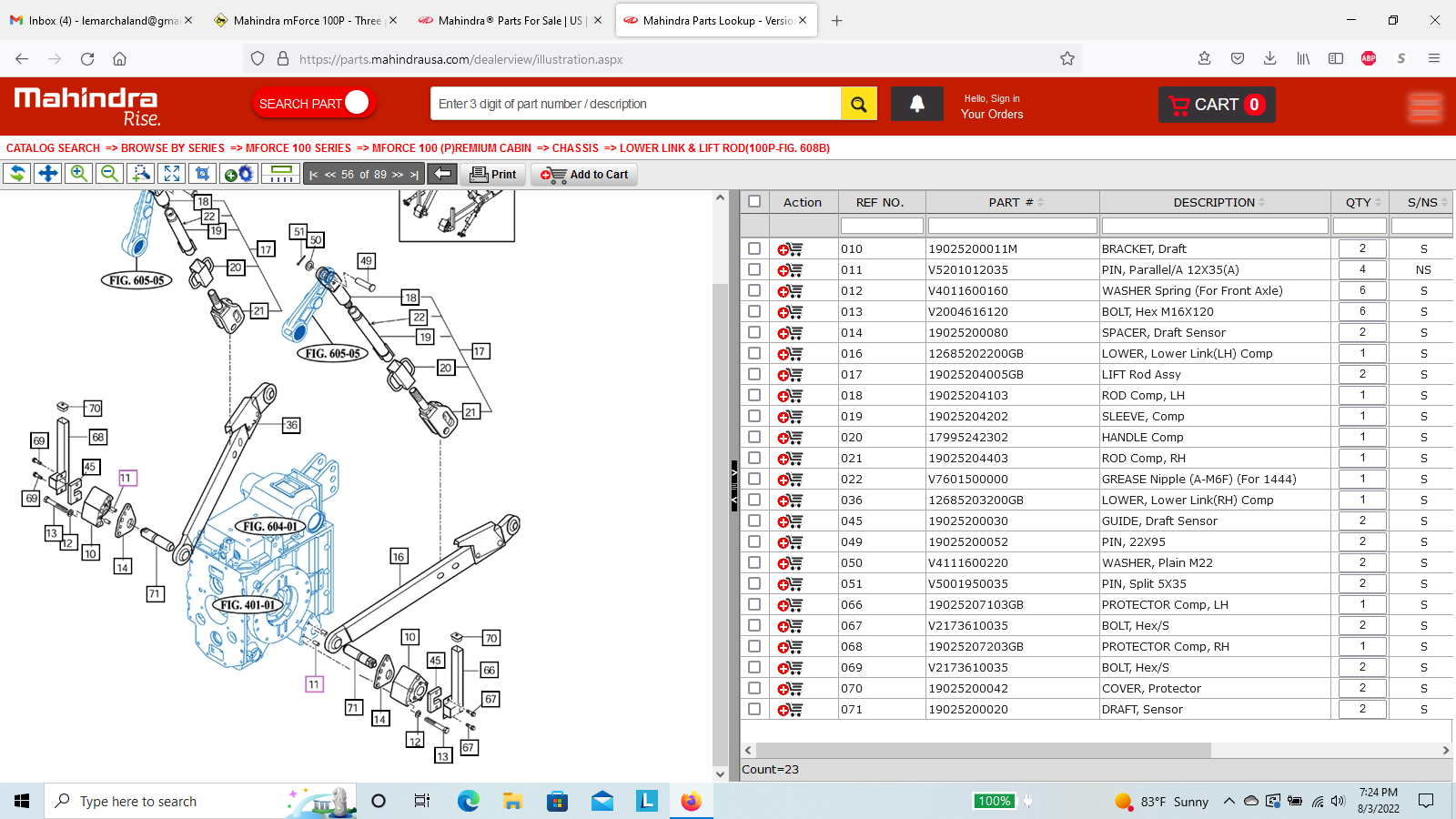

Here is an exploded view of your lift arms;
part #13 is a bolt M16x120 so almost a 5/8 x 5"long bolt,
then they are calling #71 the draft sensor which looks to be the pin that locates the lift arm.

THANK YOU!!!
The advice and the parts diagram are both appreciated.
It looks to me like I may be able to replace the broken shaft Without major disassembley.
Yes, #71 is the broken shaft I am referring to.
/ Mahindra mForce 100P - Three point trouble.... #11
Hope that pin slides out nicely for you.
May need to put some shim stock or something to protect the bore then weld on to the pin to pull it out.
Maybe you'll get lucky and a magnet will pull it right out.
#12
Does anyone a clue how part #71 comes out?
It looks to me like the only thing holding it in place is #10????
/ Mahindra mForce 100P - Three point trouble.... #13
It's just suppose to slide out after #10 is removed. Now, considering your situation, it may take cutting it out with a torch or drilling and tapping a hole for a slidehammer.
