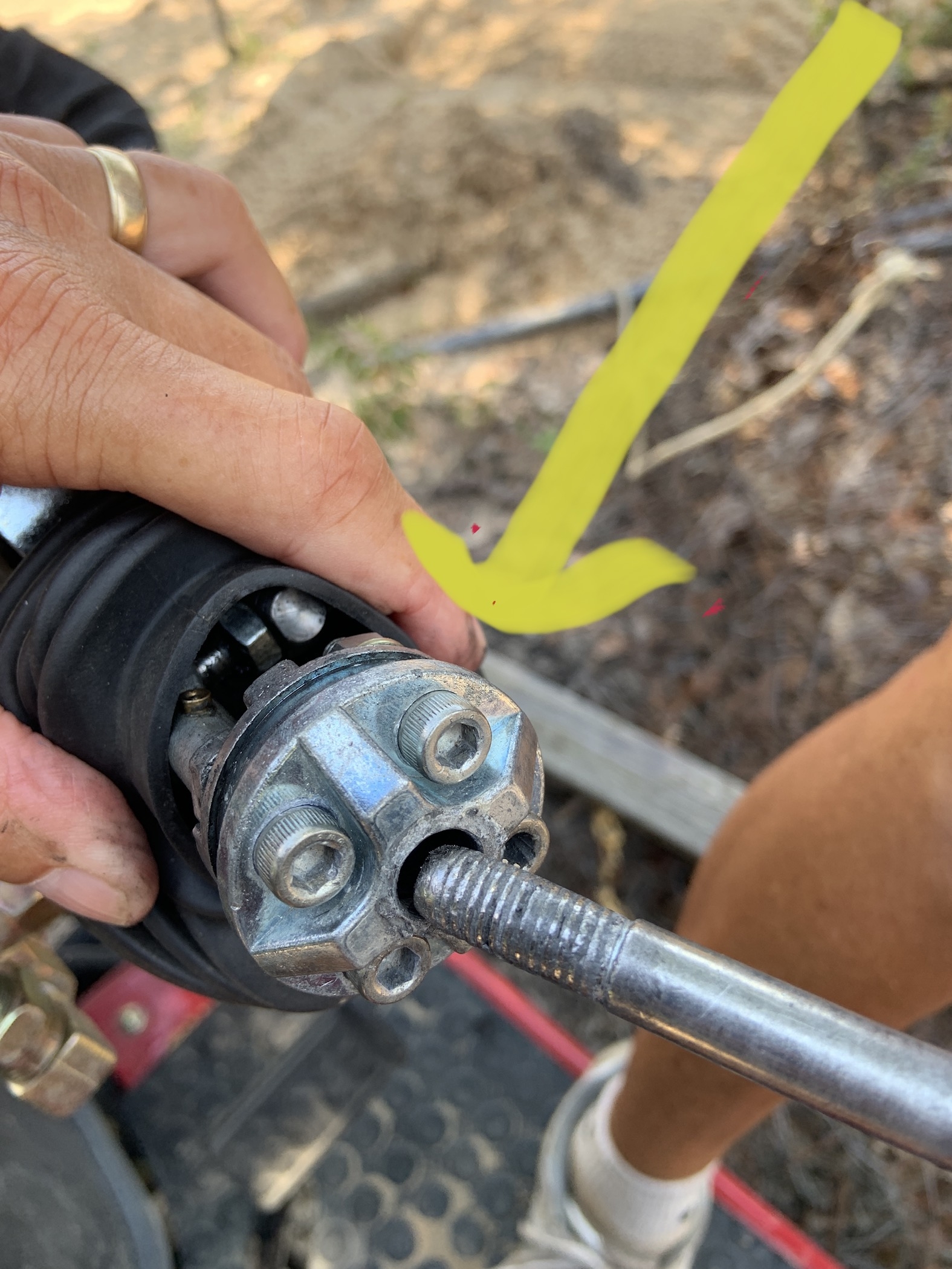

2021 Mihandra EMAX 20S with only 87 hours - the Joystick lever is already stripped and came out into my hand!!!! Has anyone else has this issue?
/ Mahindra EMAX 20S
#2
We were able to move it down, lock tight it and tightened the allen wrench bolts … so far so good but definitely sloppy workmanship

/ Mahindra EMAX 20S
Thanks - even though low hours it is a 2021 and the 2 year has expired, they did a “good will” replacement of a tie rod at 50 hours. I think we have come up with a fix using two Hoop Ring Adjustable Hose Clamps - fingers crossed 🤞

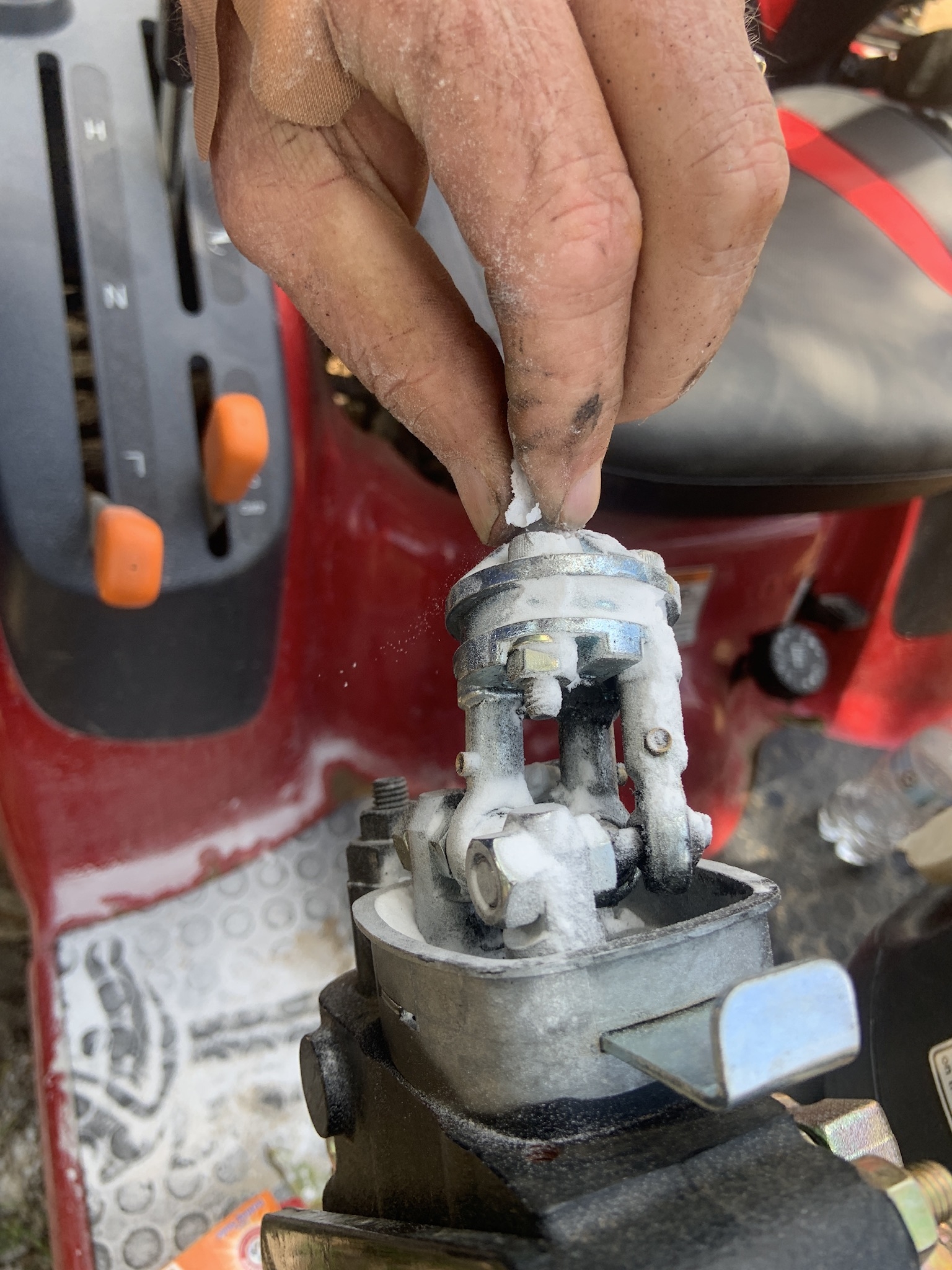

/ Mahindra EMAX 20S
Before
/ Mahindra EMAX 20S #8
Do I have to publish my questions a different way? I can seem to get any answers
No, not really. And no, you're not the first person to make that complaint. Joystick packages are all too often very lightweight structures for what they often endure. It's a common failure regardless of brand or model. Sometimes the damaged parts can be welded or reproduced if they can't be simply replaced. Many times a good welder/fabricator can build one that's stronger than the original.
Obviously I can't speak to your particular case, but I have watched some operators in action, and when using the loader they push or pull the lever as far as it goes then continue pushing as the loader is operating. It's like they think by pushing harder it's going to work faster, have more power, or something. Straining the bolts and threads on these units can often severely shorten the life span.

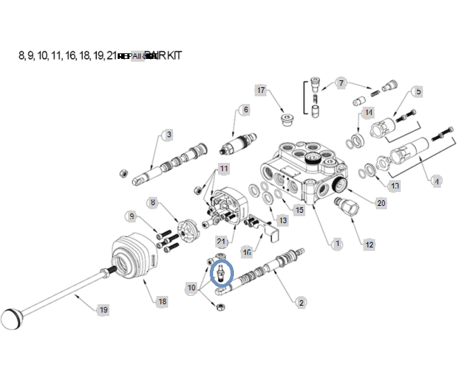

/ Mahindra EMAX 20S #10
I know this is an old post but when I had this problem I purchased a partially threaded rod (M8 or M10 threads on both ends) and then drilled out the base and put in a helicoil. The fix has been holding for about a year and a half. This whole control assembly is poorly designed. I had one of the studs in the linkage (see picture) break on me this weekend and it seems that instead of selling the $10 part I need Mahindra/ TYM sells a $150-200 rebuild kit. I don't know who manufactured this assembly but based on the dozens of complaints I have seen it's a major failure point!
