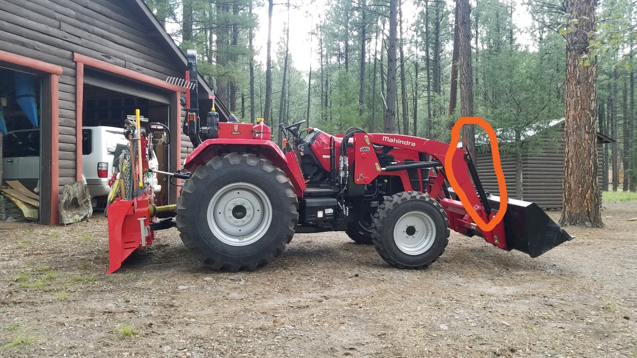

Now back to playing with my new tractor. Driving position is good and I like how the controls are laid out. Going to have to get used to the clutch. The depressing angle is different from my other two tractors and the clutch is lighter. No place for a mirror to watch equipment behind me. No level bucket indictor.

My level bucket indicator is in the photo circled in orange. For mirrors I got these and fitted them to the loader uprights. Photo before the mirrors were installed.
