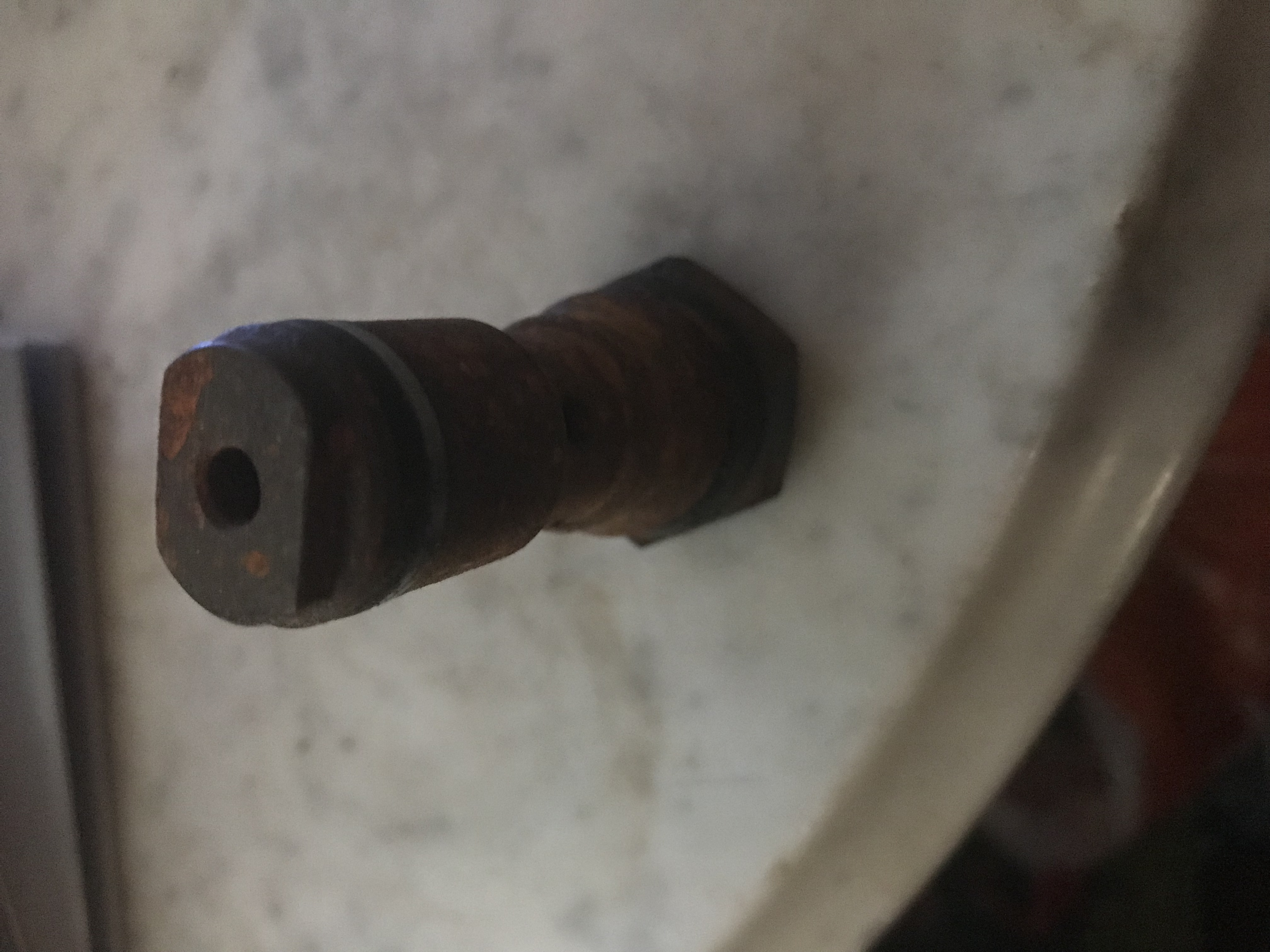

That is a strange one. Pictures would help. I think you have to have five post to post a picture. I would assume it is threaded. Are threads stripped? A new relief valve sounds in order but still need to verify pressure.
Below is a picture of an old pressure relief valve I had laying around. Does it look similar?
   / Mahindra 4530 blowing out pressure relief valve
Not threaded. Only thing holding it in is an interior snap ring set in groove of valve port.
