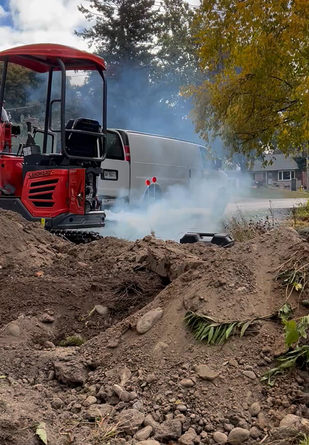

I have a mini excavator with a Kubota Z482-EF04 motor. I tipped it on its side today. After I up righted it I tried to start it but it would not turnover, I tried again to start it and it started but its blowing a lot of white smoke. I let it run at idle for about 45 minutes but its still blowing out the white smoke. it starts and rev like normal but when I try to used the hydraulic the motor stalls. Pic attached.
Any ideas.

Any clue from the smell of the smoke? Unburned diesel? Burning oil? Burning coolant? Each has a unique smell. If you are luck it will settle and burn off over time. If you are unluck it was hydrolocked and your attempt to start it busted something internal. Unburned diesel would be the most likely result.
People use different terminology, so let me ask some more about what happened when you first tried to start it. You said it wouldn't turn over initially. Do you mean that the starter couldn't rotate the engine, and stalled, like it would if you had a low battery? Or did it rotate but just not fire off?

No it would not turnover just like a low battery, on the third tr it started. Strong diesel smell.
