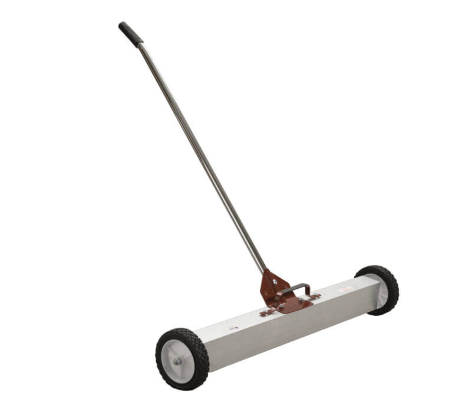

I have a 36" one that I have adjusted for the concrete floor and it is great.
I have tried it on the gravel driveway and grassy areas without adjusting the height of the wheels. The 7" wheels made the thing quite bouncy over the ruff ground and grass would rub the magnet and occasionally catch and pull something off. But a couple of passes over the same area seamed to get it all.
Had I taken the time to raise the wheels to the highest setting it probably would have been just fine.

I bought 2 at Harbor Freight. Probably the best HF tools I have. I bought them when I hired a few friends to do my roof at our old house. I told them I'd handle the ground work. These magnets were great, and actually picked up old steel (nails) that were embedded in the ground well before the roofing project.
HF is a gamble, but these are worth it.

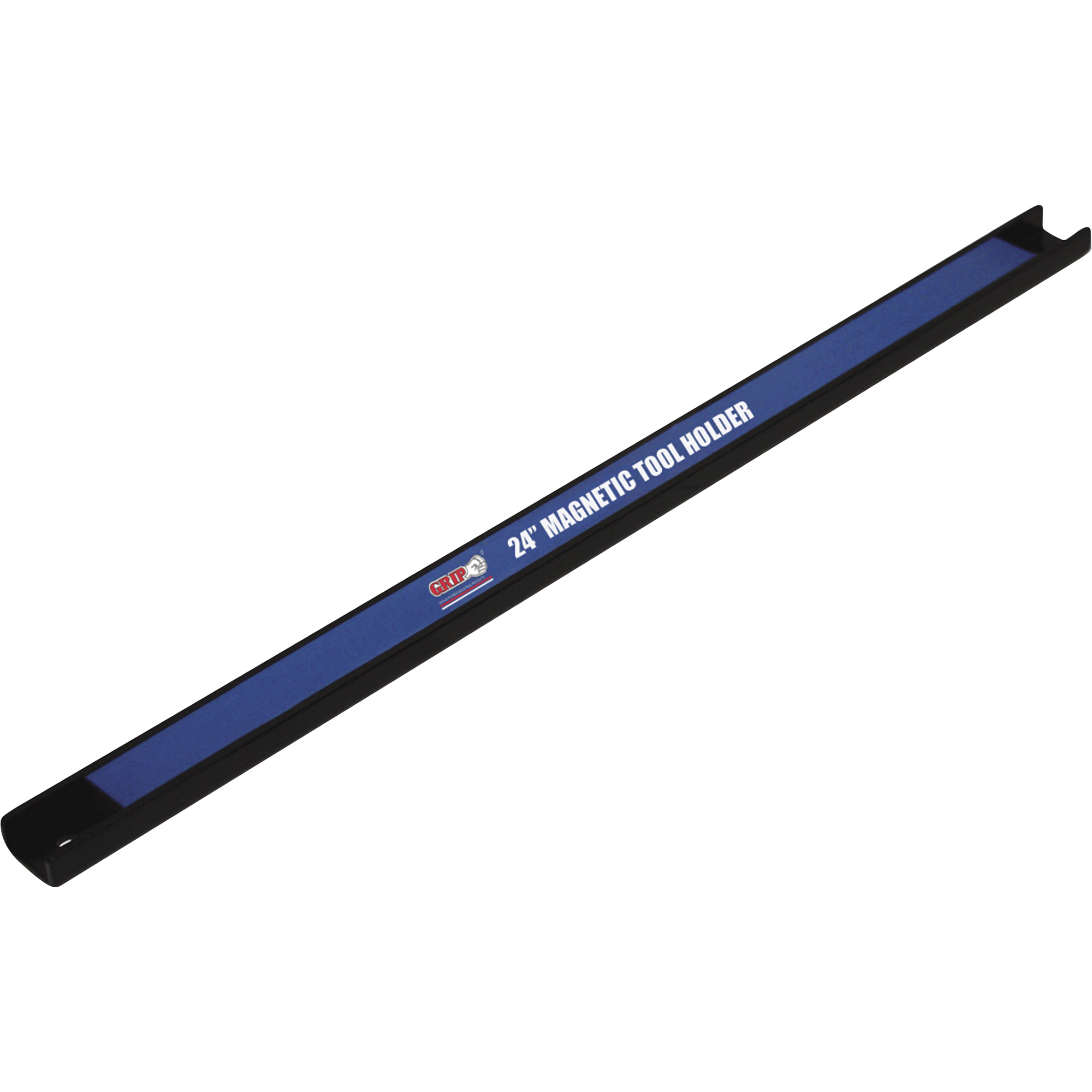

I don't think you need an actual 'magnetic broom' unless you plan to use it as a hand-operated broom later. If you do a temporary thing on a tractor implement it would be cheaper.
For example, if you have a landscape rake, 2-3 of these wire tied to the tines near the bottom, would do it and be a total of $45. Could run rake spun around backwards too.

I can't help with the relatives but I can provide feedback on the HF rolling magnetic "broom". I have acquired 5 of them over time since they work so well indoors and out. They work fairly well on gravel as long as you drag them and not push them ( tends to dig in). Also work fairly well dragged on grass so long as the grass is not more than 3" tall. The wheels are not big enough dia for "broom" to work well. When grass is 3"+ then picked up items tend to get wiped back off, particularly if small nails/screws) or the "broom" hangs up on lumpy ground. I have put 2" larger dia wheels on the one I use in grass around the house.
