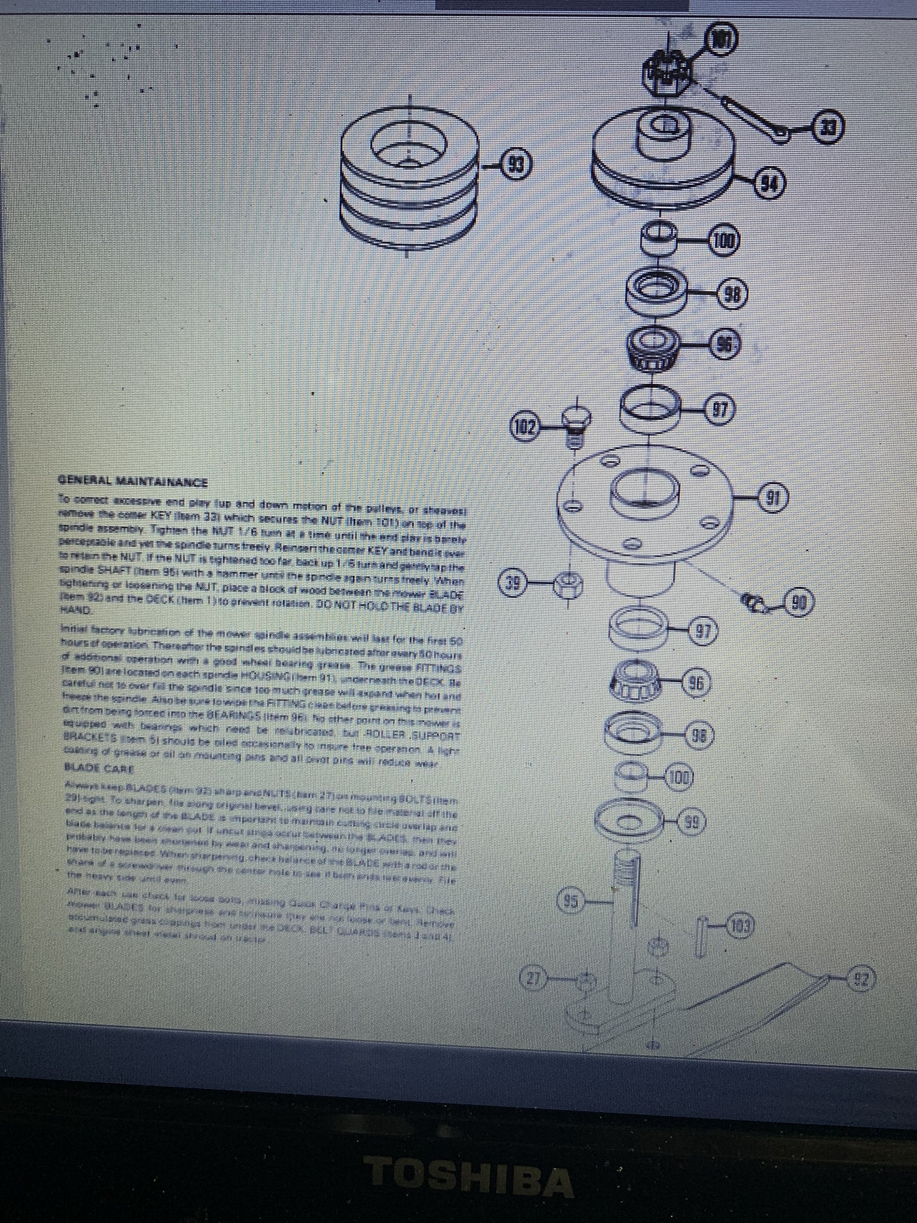

Any of you guys have any experience rebuilding mower spindles?
I’ve got one out of three spindles possibly bad on my tractors mower.
Lots of up and down play that I don’t think any amount of tightening is going to fix. ( could be wrong)
What typically causes this kind of wear?
I’ll have to figure out how to remove the top 3 groove pulley first.
I’d assume some type of bearing puller maybe?
New one is 400 plus so I am motivated to save this one.
Here is a schematic from the parts manual
I’m gonna guess that these mower spindles don’t change much from one manufacturer to another

Make sure outside bearing doesn't have wear and still snug.
/ Spindle #3
A puller on the pulley is the best. Not hard to rebuild. Very similar to a wheel bearing repack.

Rebuilding takes a press to move the shaft through the bearing inners.

Have replaced bearing in a couple of JD spindle's in 2 different mower decks.... JUst break it down, get number off bearing and order new bearings and reassemble.... But these were sealed ball bearings and not tapered bearings...

Have no clue about the spindles in general but...If you rebuild them with new bearings and I presume new grease seals and the replacement bearings come with seals, remove the inner seals on both bearings prior to installing them and make sure there is a grease fitting (or drill and tap in a grease fitting) on the spindle body where you can access it easily and fill the void in the spindle with good quality grease prior to installing the assembly back in the deck and on a reqular basis. Take your grease gun and replenish the grease in the spindle cavity until you can see grease oozing out of the bottom bearing seal.
Sealed beaings will die a slow death in any spindle where they aren't regularly greaseable. There is always a heavy load demand on mower spindles so the bearings require a constant supply of fresh grease and that don't happen with sealed bearings.

Just inspect the bearings to make sure that the grease seals are only on one side. Typically, sealed bearings come with seals on both sides which work in non critical not heavy load applications but don't work in mower spindles at all.
If there are 2 seals, remove one and place the side with the removed seal inward (or upward on the lower bearing) and inward (downward on the upper bearing). Remove any old grease from the housing and pump in fresh grease (with the spindle fully assembled) until new grease starts to show out of the lower bearing. It will most likley show there first, before the top bearing, but the grease in the filled cavity will migrate up into the upper bearing during operation anyway. Just pump in grease into the spindle cavity on a regular basis, I grease mine about ever 20 mowing hours.

If you keep them greased and you installed good quality bearings, they will last as long as the mower lasts.
Most manufacturers never remove the grease seals from the spindle bearings when new and that is what causes premature failure.

I have rebuilt 3 spindles on Kubota mowers. They are not hard, but you will need a puller for the pulley and good quality snap ring pliers to remove the snap rings on the top and bottom of the spindle. You will also need to order two roller bearings and two oil (grease) seals for the spindle. I would advise that you also get a new blade attachment bolt. The last rebuild I did was two weeks ago and parts ran around $200 per spindle. You might be able to source the bearings locally and maybe save a few bucks, but everything else will have to come from Kubota.
