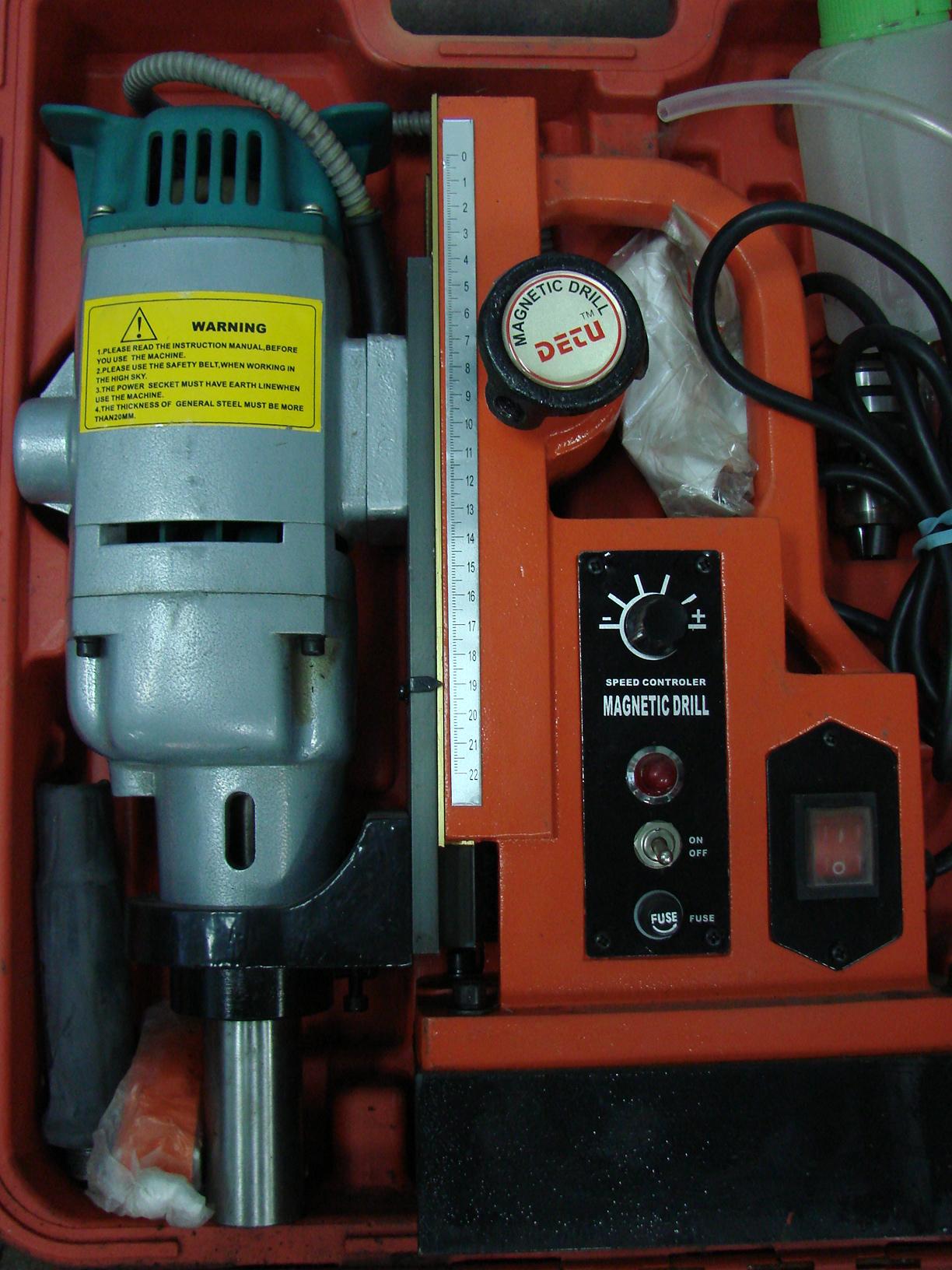

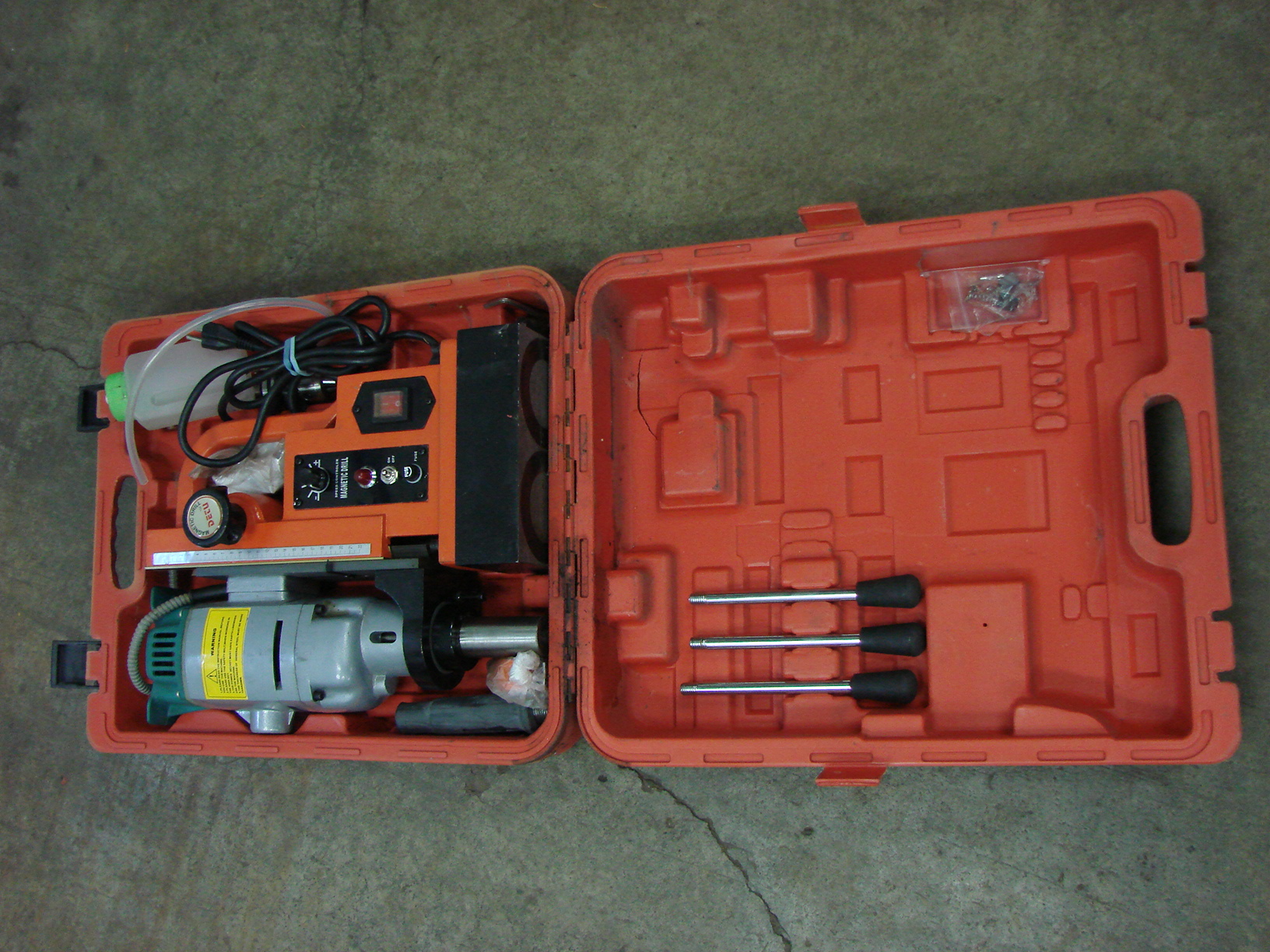

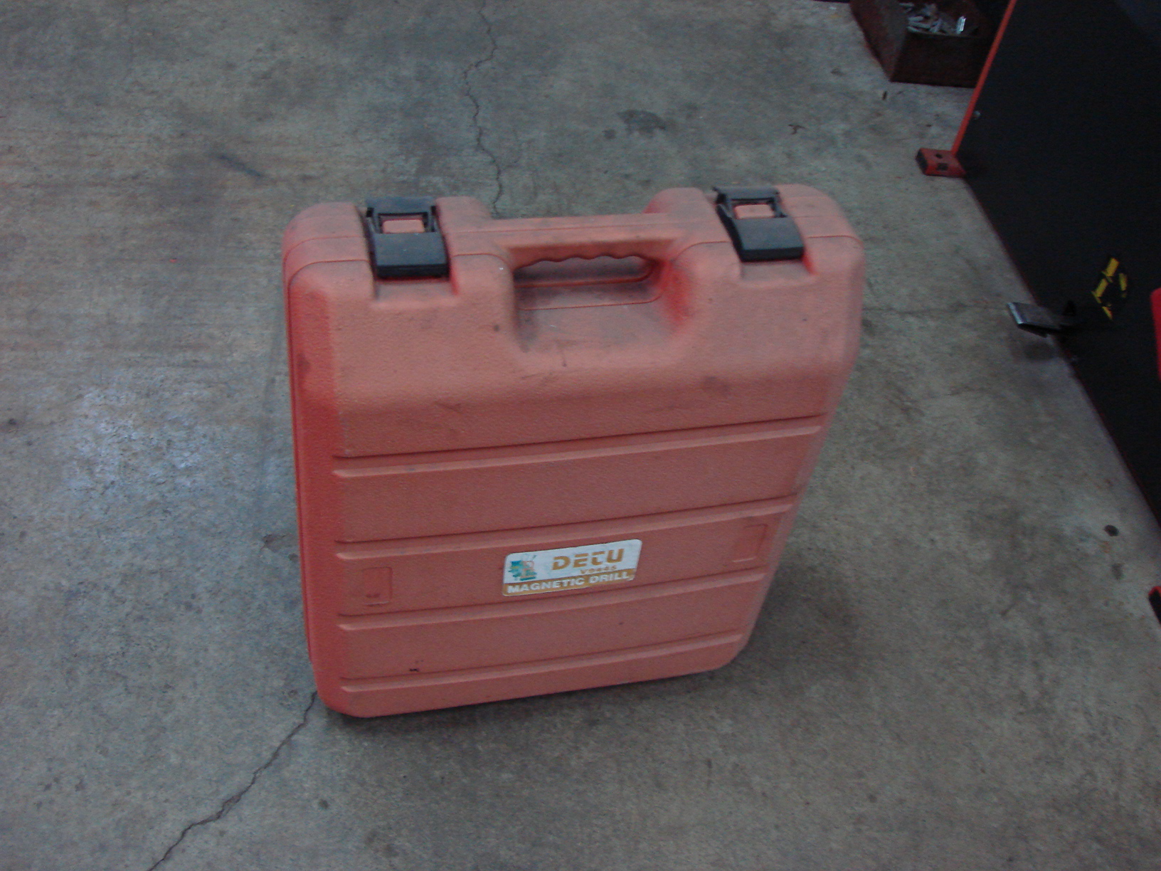

When I was out hunting for a Mag drill I wanted one with variable speed and be able to put a chuck on it when I wasn't using annular cutters. I found one that fit the bill. That being said you have to make sure your power cord is in good shape and not able to be unplugged especially if your stuck on the side of some structure. I use a lockable cord and attach a tether cord to the drill just in case I lose the power for some reason.
My main use was when I was out mobile welding. I would take it along with me. I also don't find them much good if your trying to use the magnet on thin metal such as 1/4". The thicker the plate the better. Mine gets very little use. I had to look around here to find it it's been that long since I used it :eek: good luck with your new drill. I'm sure you'll really enjoy it from the first time you use it.
