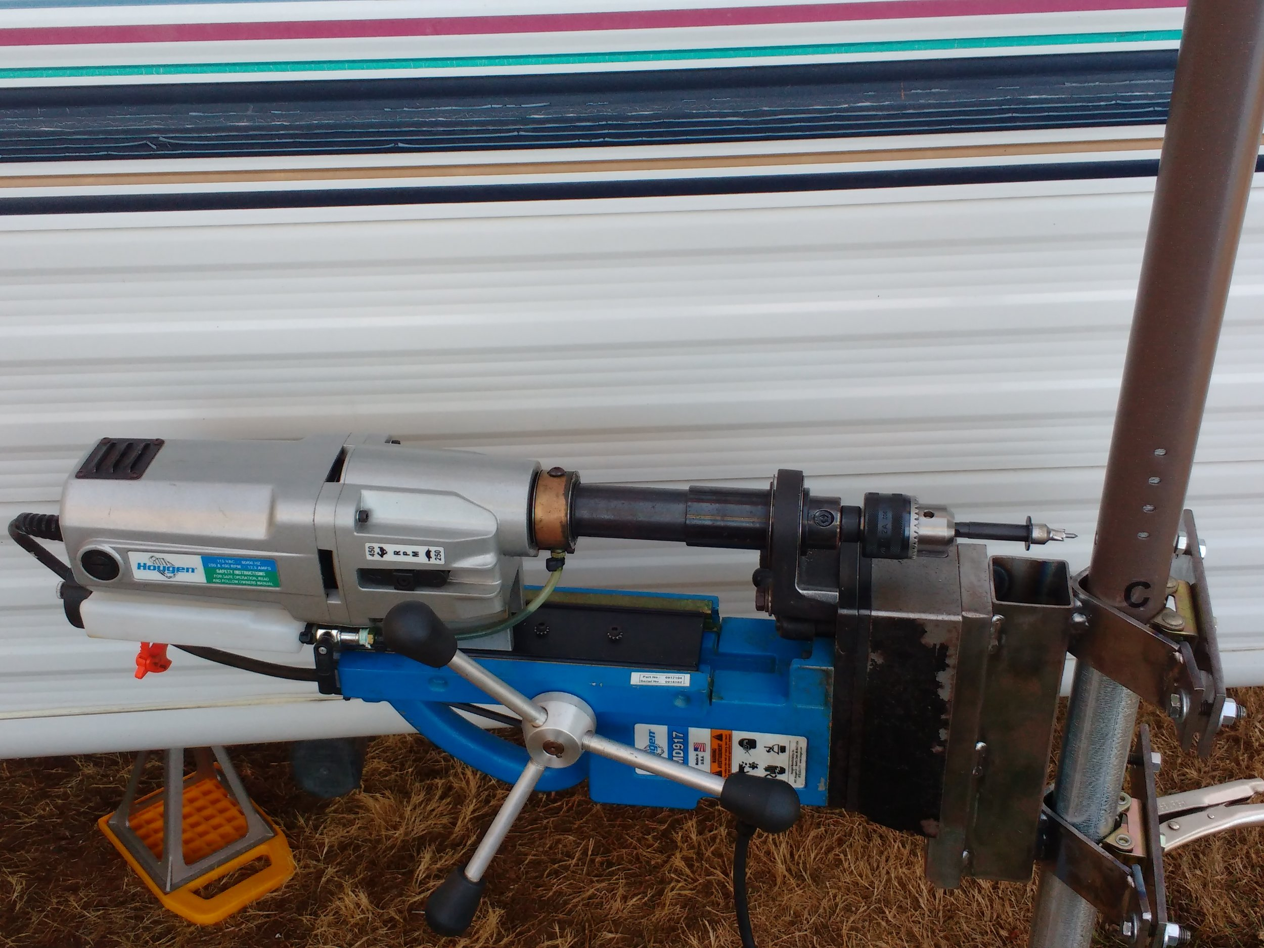

Here's one DIY add-on that can drill pipe from about 1" up to at least 5" - pics show it using the Jacobs chuck adapter and a "mini-mag" aka Blair rotobroach kit - the mag base sits on a spare chunk of 3/4x3 FB -
Not sure where the pic is, but I also used my 1-1/2" annular to put a "window" in ANOTHER piece of 3/4x3 FB, I can either clamp that piece onto thinner stock or just place it BEHIND the thin stock. Works fine either way.
For vertical drilling, my drill is the Hougen 917, has quite a bit more pull than smaller drills - I've drilled .120" wall tubing without the magnet pulling off (mostly 5/8" holes)
I've had good luck with the Evolution HSS cutters, the ones I've used the most have several hundred holes done and STILL cut a 5/8" hole thru 1/4" wall tube in about 23 seconds. Other thing I like about the Evo cutters is that a LOT of 'em use the same size canister, made it easier to come up with a stand for 'em (see pics) - Just a scrap piece of 2x6 and a snug fitting forstner bit in the wood shop's drill press (uniform depth setting) ... Steve

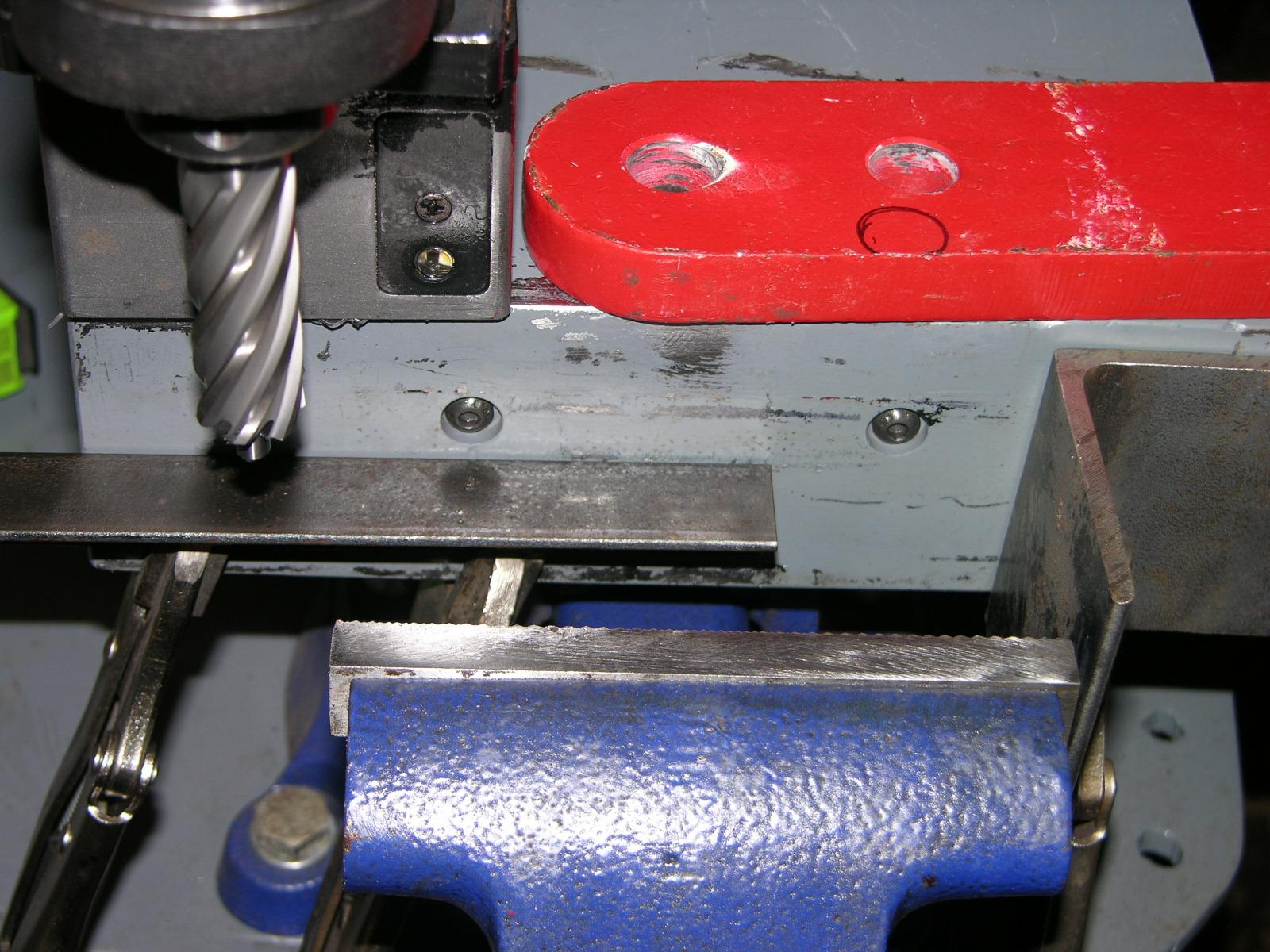

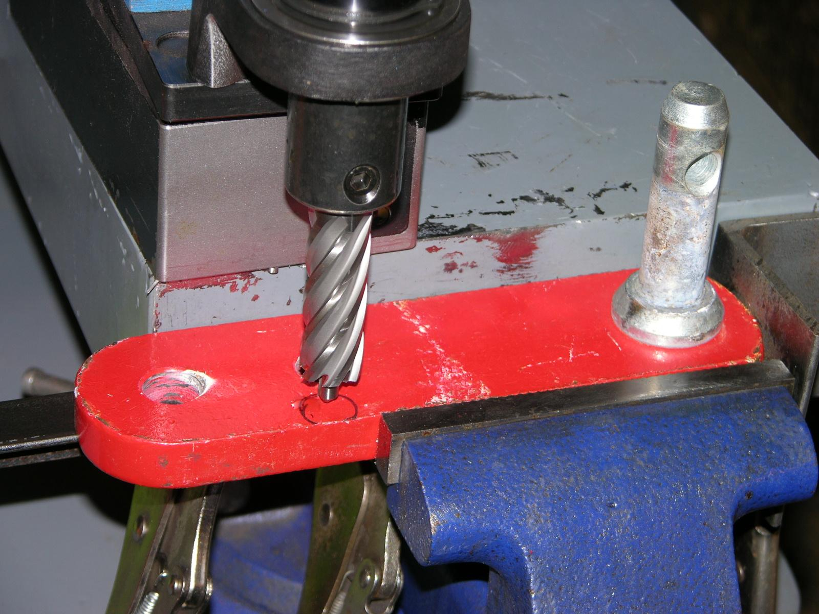

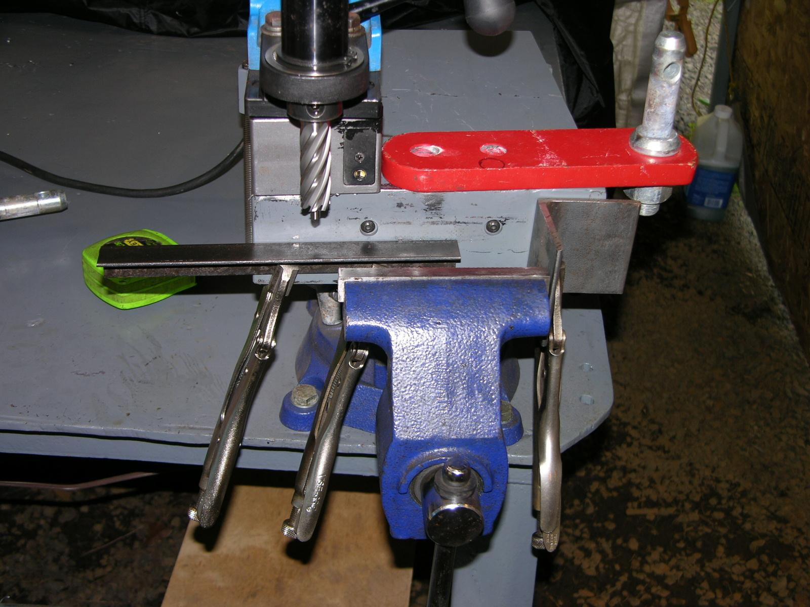

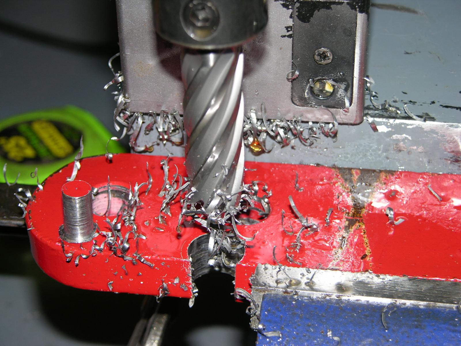

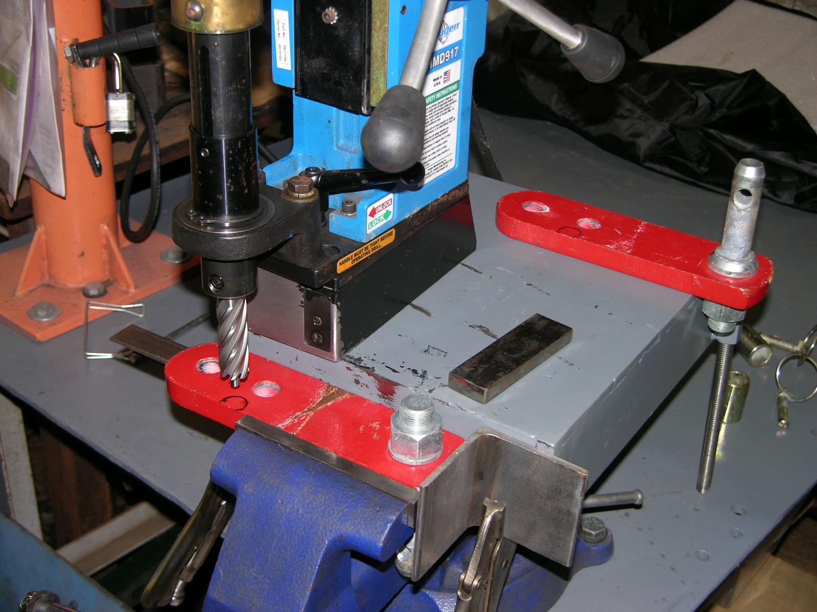

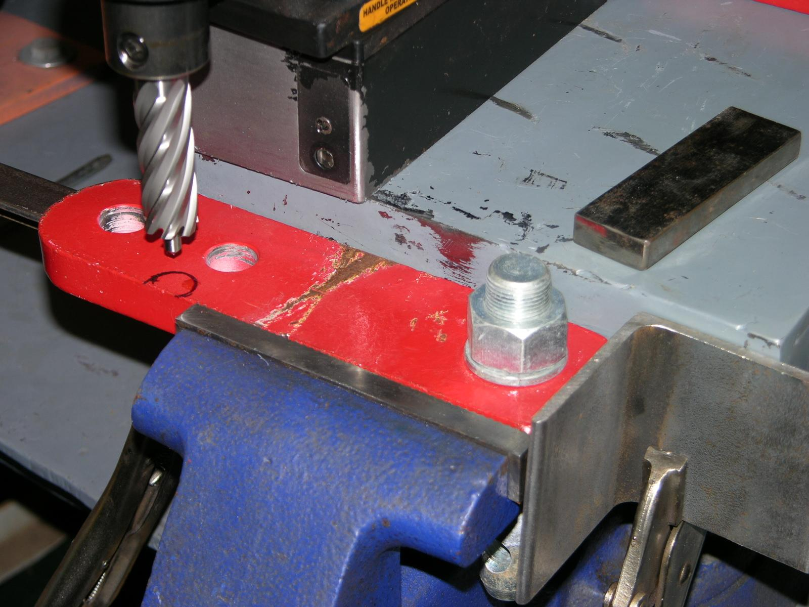

"Can annular cutters be used for “half a hole” drilling?"
Lenny, I'm not sure about exactly half but I did "3/4 of a hole" for a mod to my flail mower's "float" linkage on the lower mounts - the bars are beefy enough I wasn't worried about weakening by effectively decreasing their width -
My thoughts on why I got away with it - the "more than half" that I cut kept the cutter from being able to easily jump to the side, so minimised any side loading (DEFINITELY a cutter killer)
I've not needed a "half or less" hole in anything yet, but I would think long and hard before trying it - anyway, "pics or it didn't happen" - plus, if you're gonna build a dedicated mag drill area I have a LOT more pics of the way I did mine, just ask if interested... Steve
Pics 4 and 5 show one of my methods for ensuring that duplicate parts REALLY ARE - the table is a 12" piece of 10" C channel, overlaid with 1'2
[ plate for more magnetic pull. After welding the plate on I surfaced the whole thing on the mill for maximum magnet contact. Oh, and that vise is a reversible Wilton - haven't needed the extra jaw opening yet but if I do... (y)
