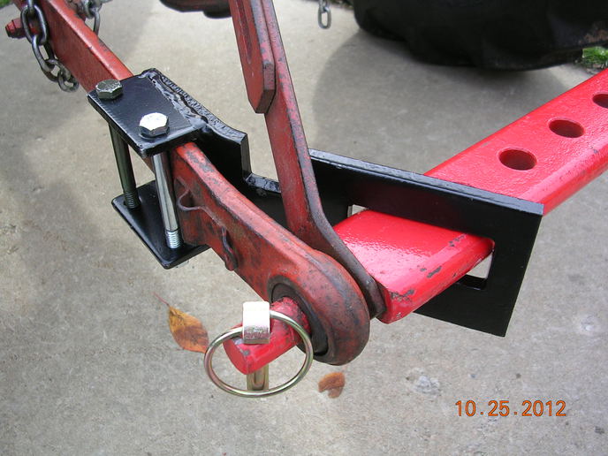

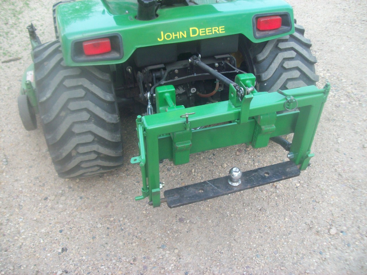

Jan 19, 2015 / made o quick hitch #1 dixstir Silver Member Joined Dec 8, 2009 Messages 229 Location fairmont mn Tractor 2305 jd cub farmall home made tractor made a quick hitch for my 430 Attachments quick hitch 005.jpg 314.2 KB · Views: 593 Last edited: Jan 19, 2015

Jan 21, 2015 / made o quick hitch #6 ecbaatz Silver Member Joined May 1, 2014 Messages 169 Location Honor MI Tractor Branson 2400H Nice job, one question, what keeps it from turning? I could not tell from the picture.
Jan 21, 2015 / made o quick hitch #7 Chad450r Bronze Member Joined Dec 15, 2008 Messages 50 I would say when it's attached to a trailer it will not twist around. Nice job
Jan 22, 2015 / made o quick hitch #8 RPW Veteran Member Joined Aug 12, 2009 Messages 1,105 They do and will without some sort of restraint. Will tear up a hitch in no time. I found out the hard way.
Jan 22, 2015 / made o quick hitch #9 bcp Super Star Member Joined Jul 8, 2009 Messages 14,997 Location SW WA Tractor Kubota BX2360 Those drawbars were intended for use with a clevis hitch and pin, not a ball. It will rotate forward or backwards until the ball shank hits part of the coupler, then it will try to pry itself out of the coupler. A couple of drawbar locks, to prevent twist: Drawbar Lock-Category 1 | Agri Supply #63963 Bruce
Jan 22, 2015 / made o quick hitch #10 Chad450r Bronze Member Joined Dec 15, 2008 Messages 50 I'm just saying that is a lawn mower with a 3pt. Have to be hauling one heck of a load to tear that up. IMO :-0 not that it means much
