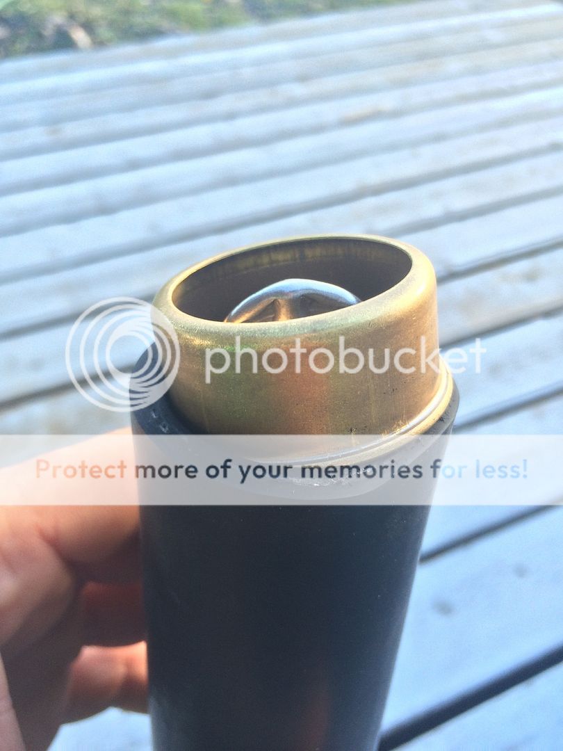

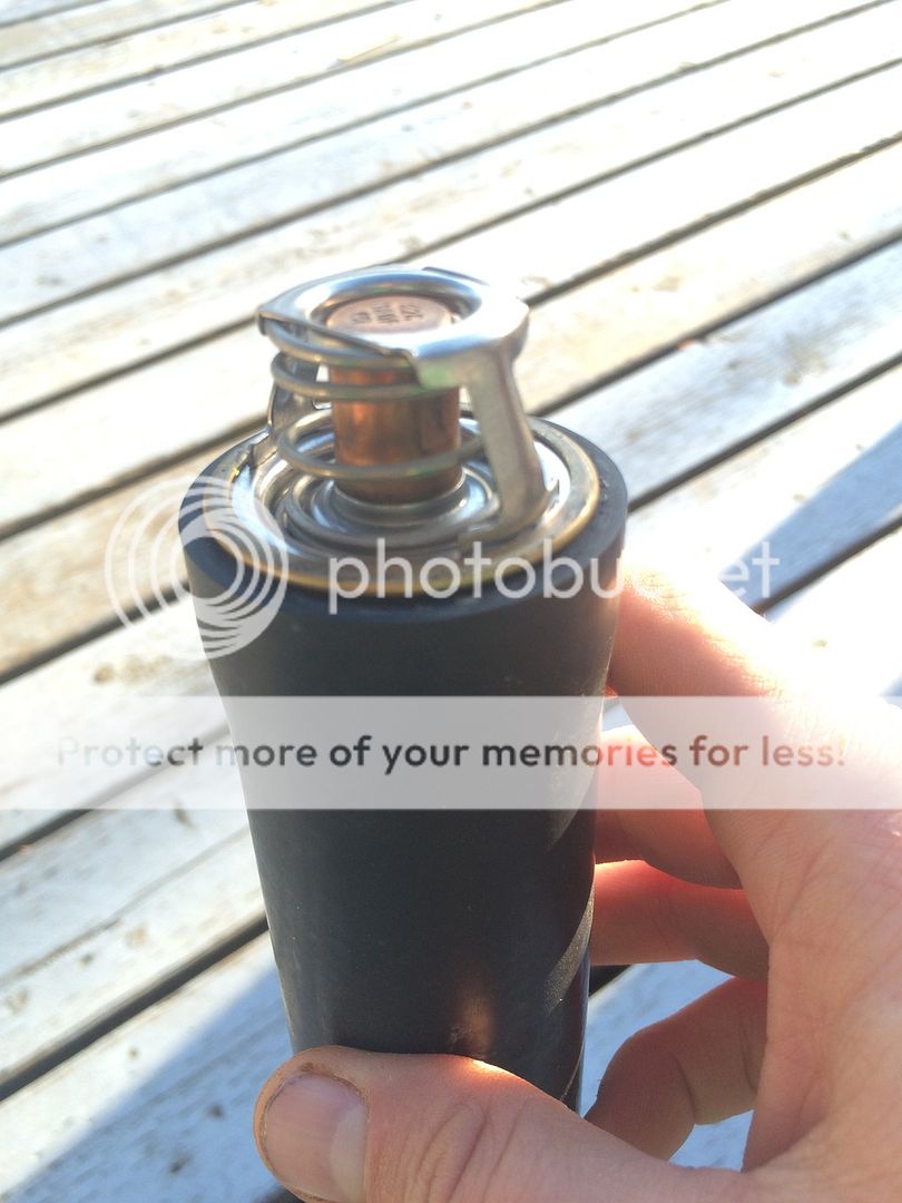

Ok guys, can't for the life of me figure out how this thermostat is supposed to fit in the rad hose. It seems way too big. I can get the one end in, but I can't get the lip in to get it into the actual hose. Anyone tried this type of thermostat before? Is it just a matter of oiling it up and continuing to work it in or is there some other trick?

Hmmm... Maybe heat the hose up some, then put a little Vaseline inside. Then wiggle or tap in in with a 11/2" pvc pipe or something?
