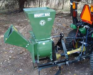

/ MacKissic Review
Did some more work on the Mac and finally had to remove the screen to get an errant piece of wood that was stuck in it making some noise but otherwise not causing any harm.
The Mac screen is a lot lighter weight than the very heavy ones on my old Troy Bilt. The one on the Mac for my Gravely was similarly light. The Mac screens bend a little when you pull a pin at one end. It makes getting the pin back in a little harder than on the Troy Bilt, as you have to spring the screen a little bit to align with the pin.
Everything on the Mac is actually lighter weight than similar metal parts on the Troy Bilt. The Troy Bilt is built like a tank by comparison. Think the hammer assembly is virtually the same and probably the chipper blade. These are very heavy.
Looks as though the rods on the hammer assembly are held in place by cotter pins. These ought to be easier than the troublesome roll pins that hold the rods in place on the Troy Bilt. The spacers on the Troy Bilt rods were maybe a tad light, as some of those would occasionally get bent a little. The ones on the Mac look similar.
Shredded up 3 more truckloads of leaves this afternoon. Got quite a compost pile, and it's cooking already.
Attached is a pic. The pile behind the Mac is about 2' higher now.
Ralph
