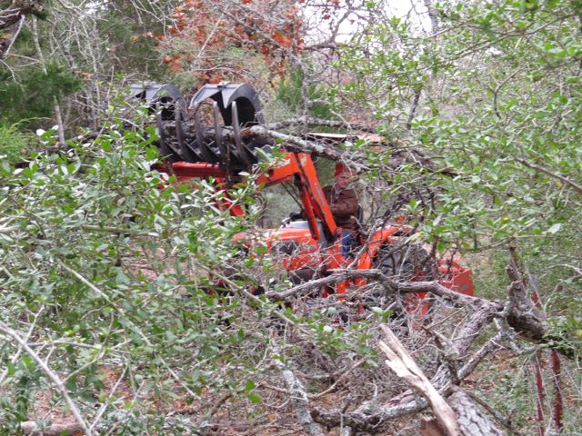

I agree in regards to opening the trails. There's not much way to eliminate manual labor if your goal is a trail you can safely drive on. I built most of mine prior to having a Grapple. I would add, trail maintenance is an Annual event.

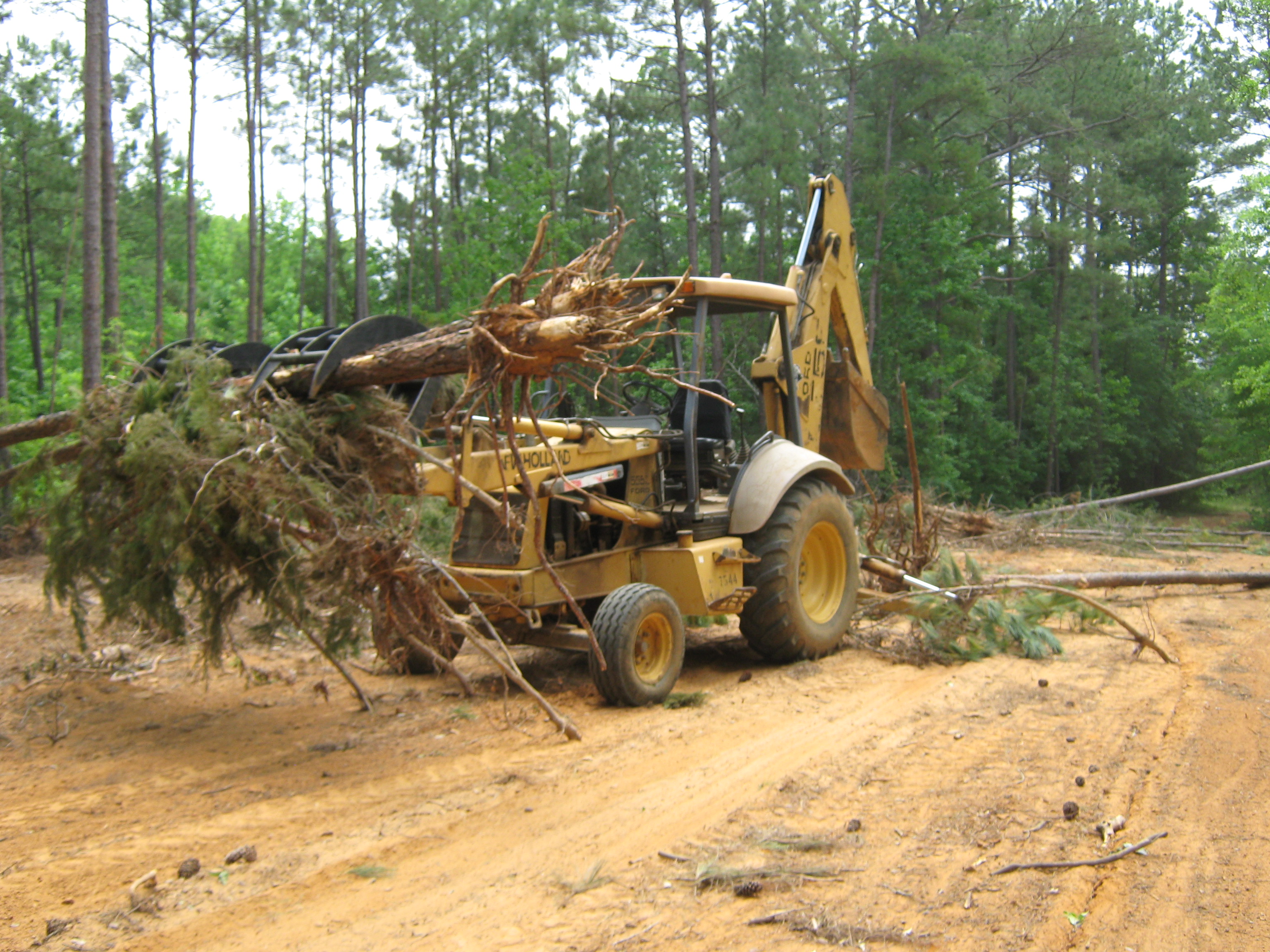

I have a fairly good sized dozer at 170 hp that can do a lot of damage going through the woods. When I first got it, I was all excited to clear some trails through the jungle and open up my land. Call it rookie thinking, or just naive. Either way, what I learned is that it's amazing fun tearing up the countryside, seeing trees fall and working your way through land that was too thick to walk through. But then reality set it. First, the mess was unbelievable. The dozer pushes. It really PUSHES!!!! And what it pushes, gets tangled together into something beavers would be proud of. You either just leave it there to rot away in twenty years, or you get it to the burn pile. Since this was before I had a grapple, it was all about wrapping chains around the mess and dragging it out. Usually there was a lot of chainsaw work involved too.
Another lesson learned over and over again, was to NEVER drive over any debris in a dozer. The tracks will twist and drive the smallest branches in between an opening and destroy something. I lost numerous hoses that way, and even had a small pine work it's way into the engine and take off my oil pressure sensor. Fixing these things always meant chainsawing away the trees that where in the way, and then working in very uncomfortable conditions. Dozers are for smoothing and spreading dirt, nothing else.
Then one day a light bulb went off in my head and I realized that using the backhoe to take out the trees and saplings was faster, easier and it left the ground in better shape. I didn't even need the dozer to smooth out the ground after taking out most of trees, and where the bigger trees came out, a load of dirt from the front bucket and back dragging worked better then the dozer!!!

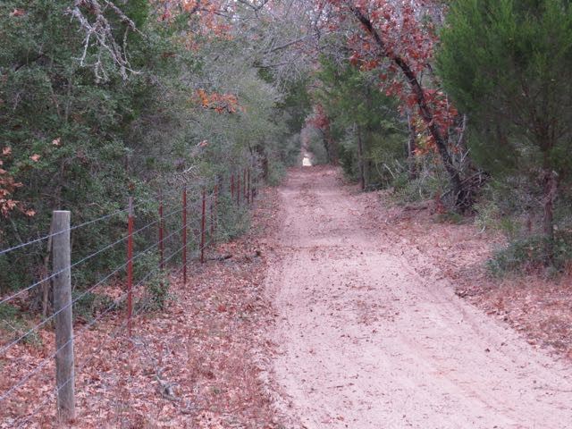

I'm clearing my fence line. I've removed every tree, 50 feet from the property line with my backhoe, and carried almost all of them with my grapple. A few had to be dragged because the loader can only pick up 4,000 pounds. I'm getting close to have all 68 acres cleared, which is in the neighborhood of 6,000 feet. Not once did I use the dozer, or even consider it. I will use it when I'm done to grade some of it, but that's less then half of what I've cleared.

The value of this testimony cannot be overstated. For anyone considering the purchase of a dozer with no operator experience, take heed!!!!!
If a land owner has a large dirt project such as building a pond or terraces, etc., a dozer is valuable.
For the topic of this thread Eddie's backhoe has made his dozer unemployed. Not prying into his business but he probably has more money invested in the dozer than the backhoe.
Lastly concerning a dozer. A LOT of guys can "run" a dozer, myself included. Very, very, very few guys are dozer "operators". Huge difference. Side effects are described in painful detail by Eddie above. :(
