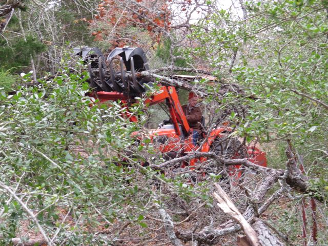

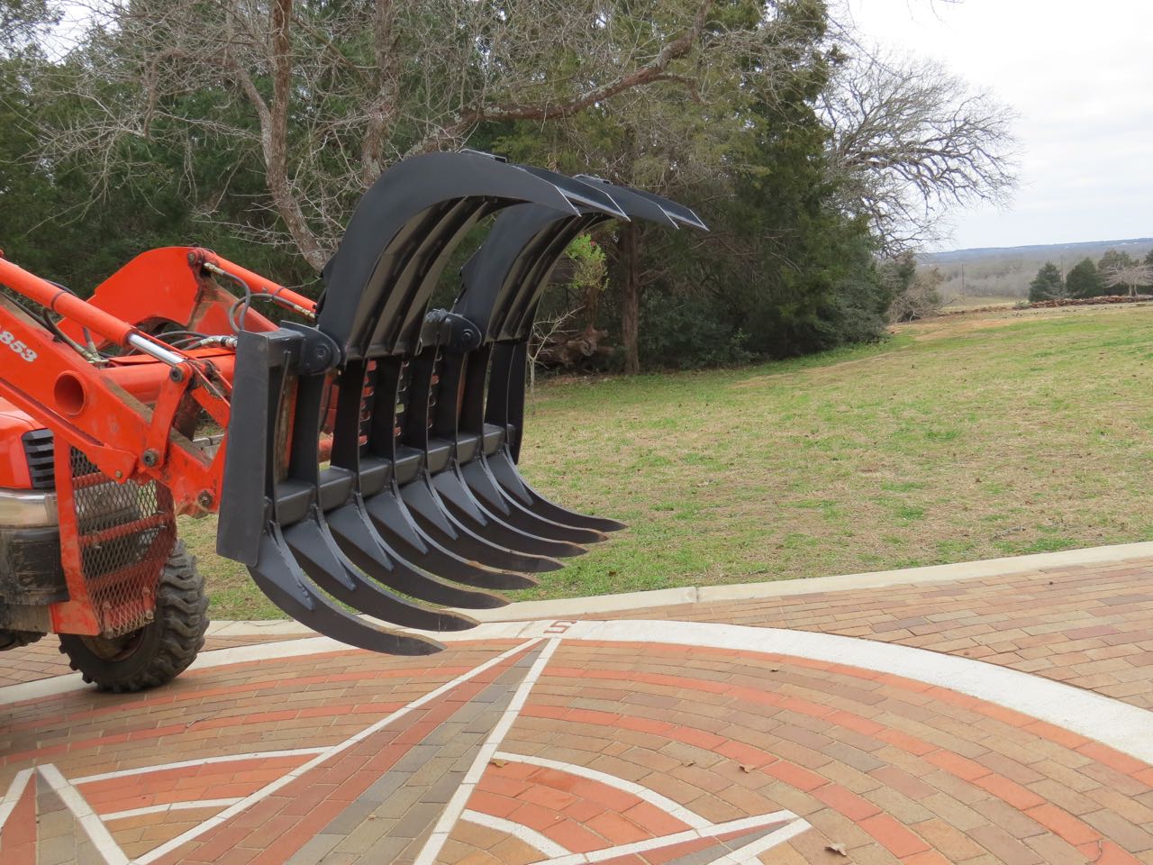

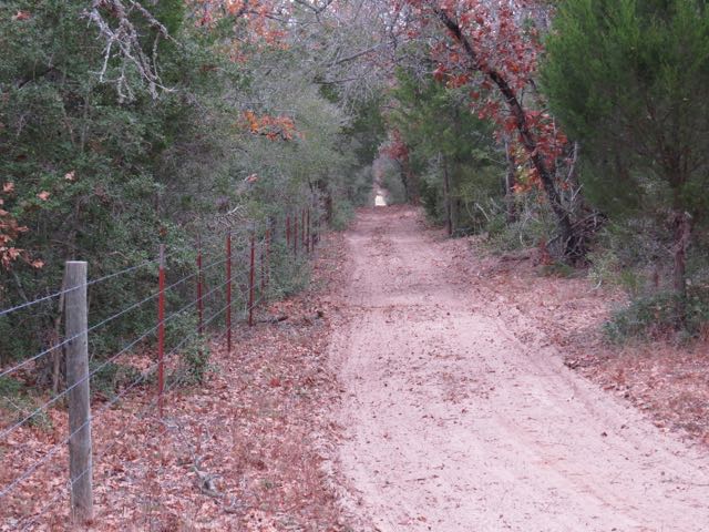

Have you thought about a good root grapple to pop those shrubs and trees less than 6" out of the ground. The one I have works pretty good and it's fun. Then go back over the trail with a box blade.
