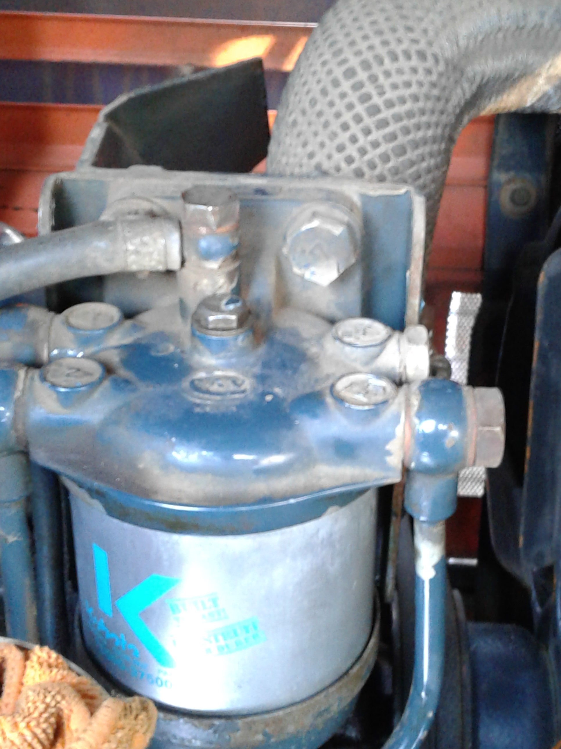

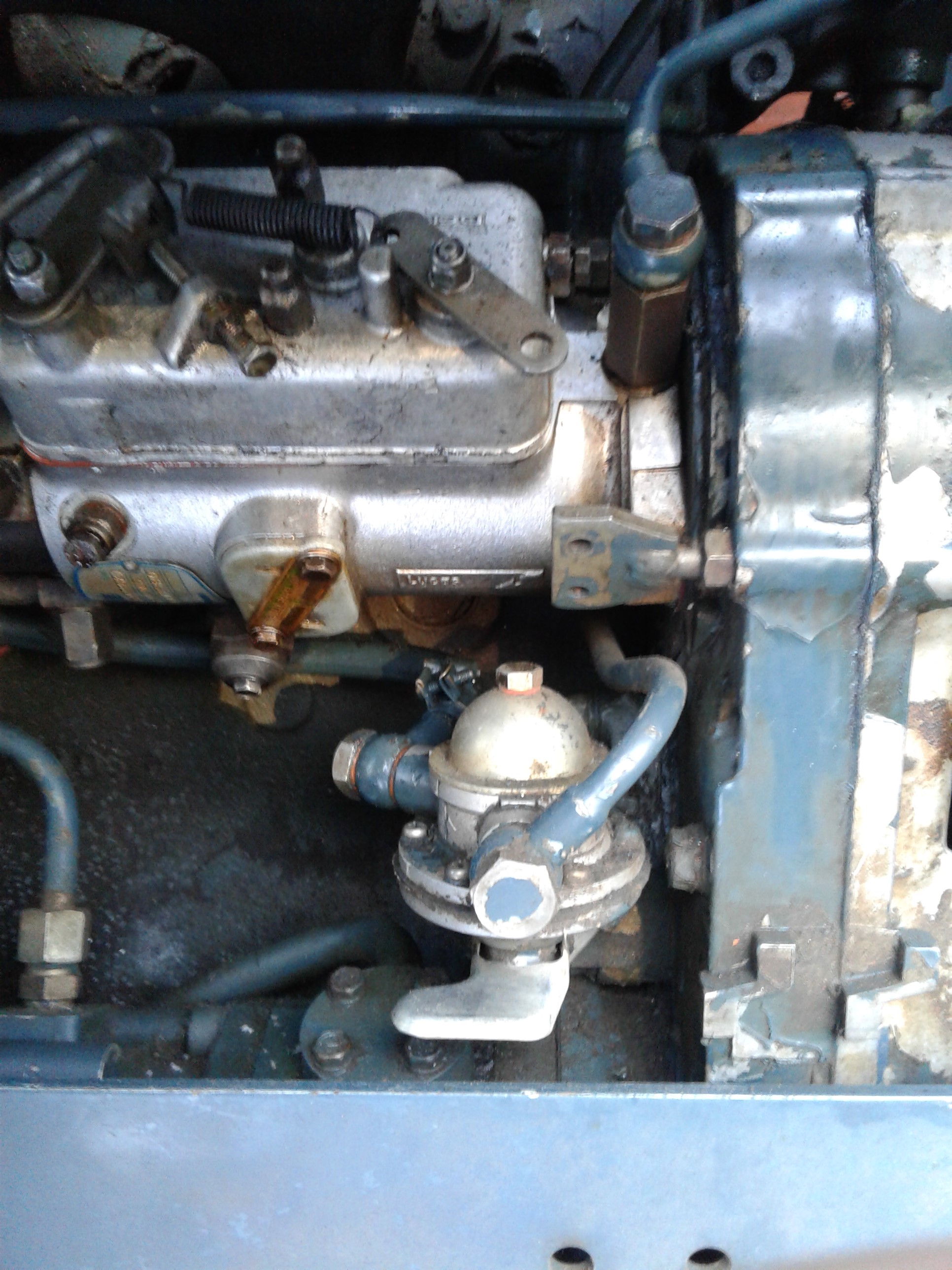

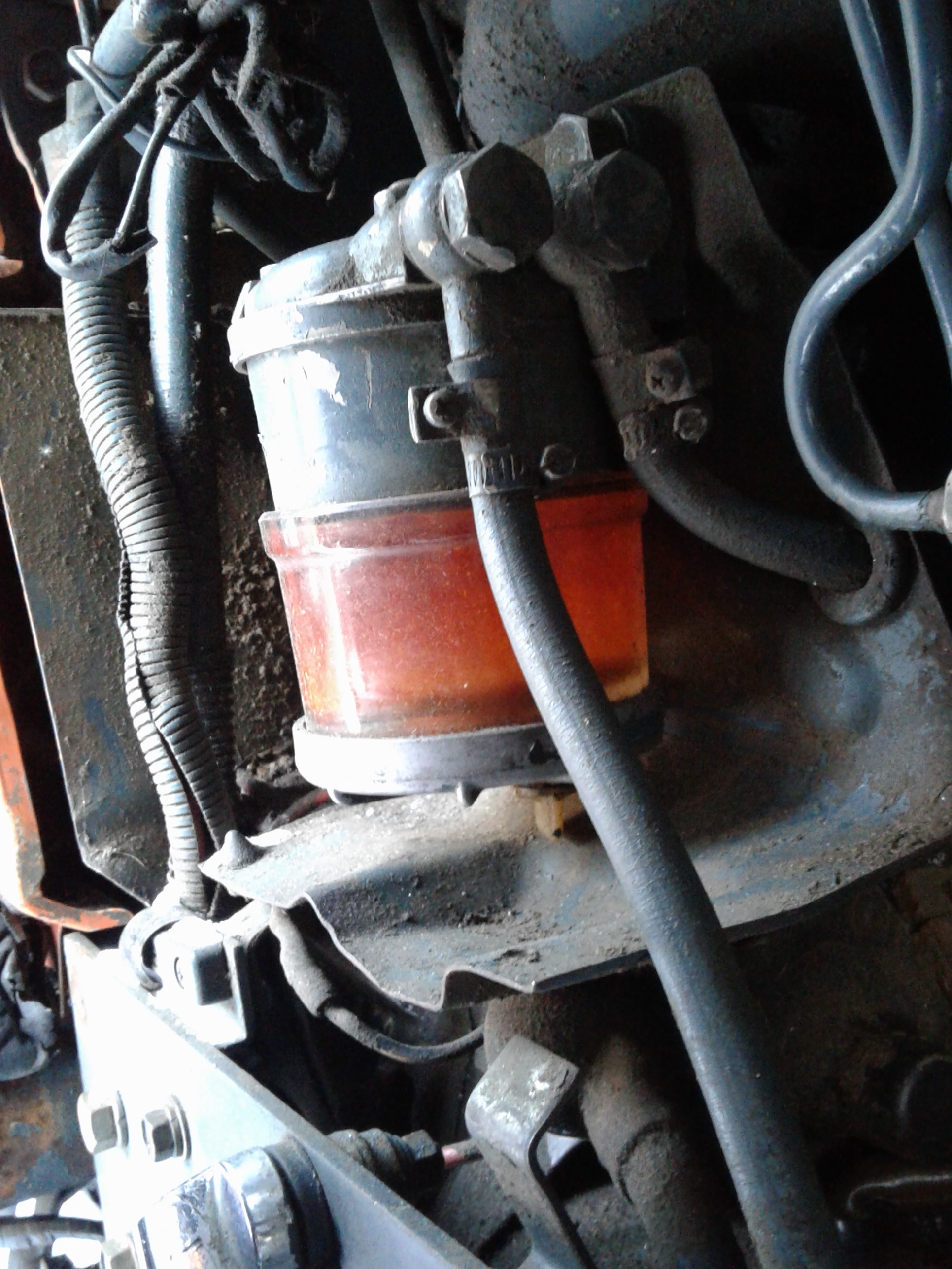

Good Evening, I am seeking a fuel system diagram for an M7950 DT (or similar model). The non-OEM (scanned version) of the service manual does not seem to have one. This machine has a water separator, a priming pump and a fuel filter. I am reluctant to cut away the strapping on the bundles to follow the various pipes/tubes and hoses.

I'd use the factory parts list diagrams for your model Kubota Tractor Corporation - Illustrated Parts List The M7950 has two tanks, a sedimentation system, etc. - the diagrams should give you a good idea of how it all connects. Troubleshooting info might be harder to locate - although diesel tractor fuel systems have a lot in common from brand to brand.

Do you have problems with the fuel system?

Does it have a C.A.V injection pump or is it a japanese license? Suppose this engine may be based on a FIAT design.

AGVG: Yes, Thank You. The fuel lines are frozen, I replaced the filter, checked the water separator, freed the fuel hand pump and added 9-1-1 along with localized heating with heat gun. I discovered the second tank as mentioned in first reply though not sure what it's purpose is. I have enveloped whole tractor in tarps and will apply heat via kerosene heater, once it warms up a bit. The fuel pump says Delphi but I think it is a Lucas design. All work is on hold as it is -28 c/ -18F (-37c with wind chill factor). It is not urgent as I have other machines still working. Thanks again.

-28 and bleeding diesel systems is not much fun, have tryed several times...
Smal tank, is it for thermostart preheating?

This beast has a cab so won't fit in my garage or tent. As to the tank, I don't know, hope to ask the shop later today. My Kioti and my C/IH do not have one nor do the two neighbors who also own Kubotas (smaller, though). I will let you know what I find out.
