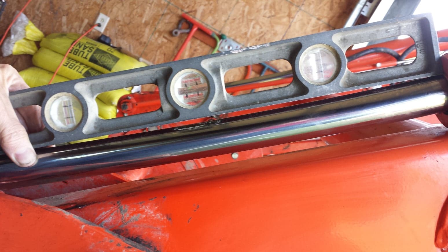

I'm afraid I bent my curl cylinder(s), I realized my curl function was slow to dump, and then stopped about half way through the dump cycle, (so the bucket would be about flat on the ground). I realized this morning that the chrome piston or compression rod on each cylinder is getting hot leading me to think that they are binding inside the cylinder tube. I swapped the boom lift and curl hoses on the loader control and have the same symptoms. I then freed the cylinders from the lower connection pin near the bucket and extended and retracted the cylinders. The left side cylinder is getting hung up about half way through the cycle, as well as retracting slowly, and becoming hung up until the right side cylinder is fully retracted, then the left cylinder fully retracts. The right side chrome rod is also quite hot after a few cycles. I'm seeking advise on my diagnoses and options for repair.
Updated: I extended the curl cylinders all the way while reassembled to the loader arms and was able to clearly see the chrome rods bowed. (see pic)
Thank you for any help,

Oh, yes. That's not good.
I would order the parts online, and have a competent local hydraulic shop OR Kubota dealer and repair the cylinder. Just remove the cylinder, and give them the parts. They can even pressure test it, and cycle it.
Take the loader off so you can still use the machine.
A lot easier than taking the whole machine down the road...

I had a brain fart and back dragged my grapple with the curl cylinders fully extended, I did not realize what happened until shortly later. Not my best moment, but thankfully not my worst either!

Rods on these cylinders are easy to press straight if you don'r have a press any machine shop should be able to do it for you.

Update: Fixed
I trimmed the corners off of a 4x4 and my son adjusted the bend by moving the 4x4 between the loader arm and cylinder ram, while I operated the curl function. He used an 18" level to keep checking the rams as we slowly worked towards arguably perfect, time will tell.
