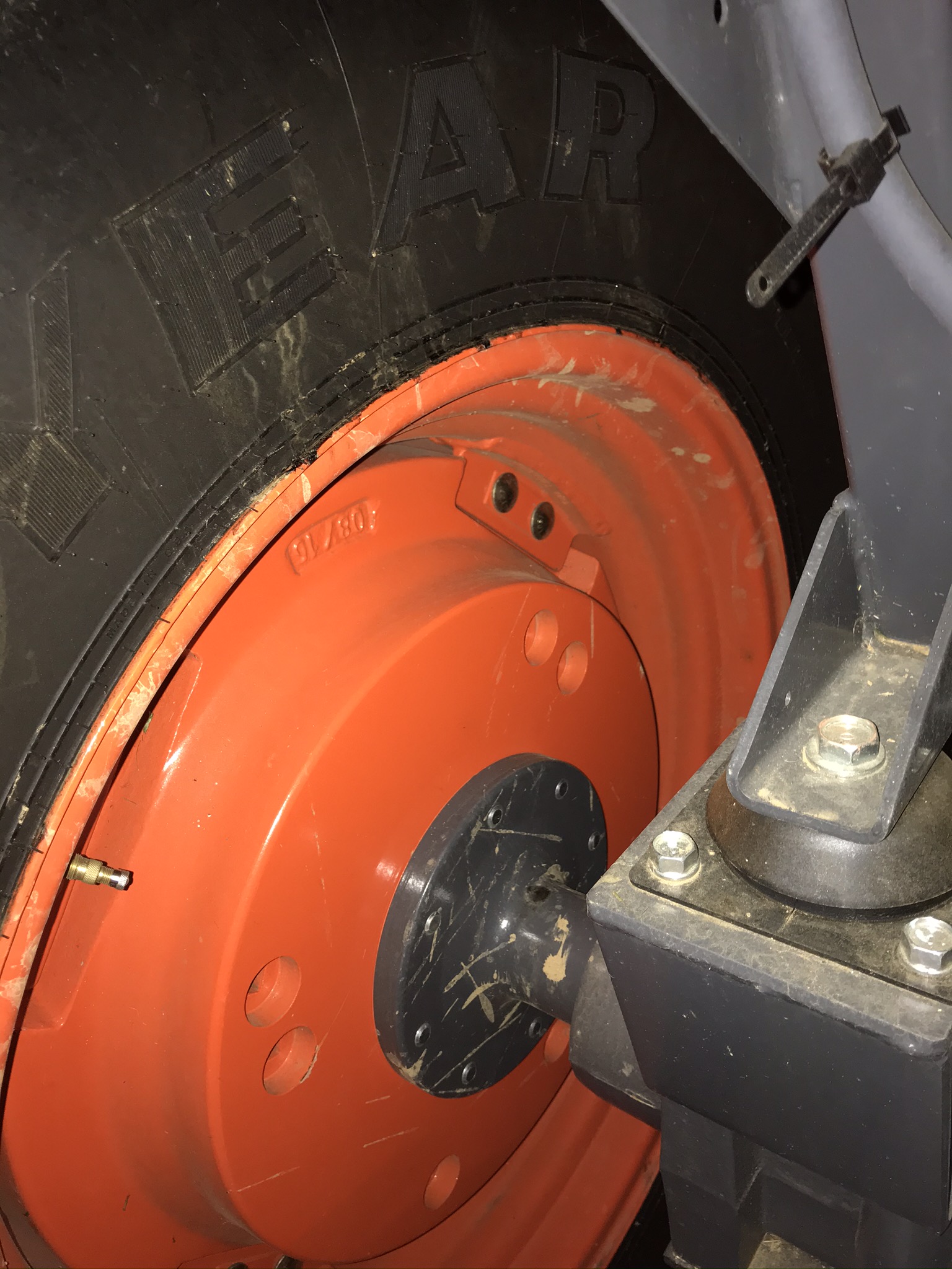

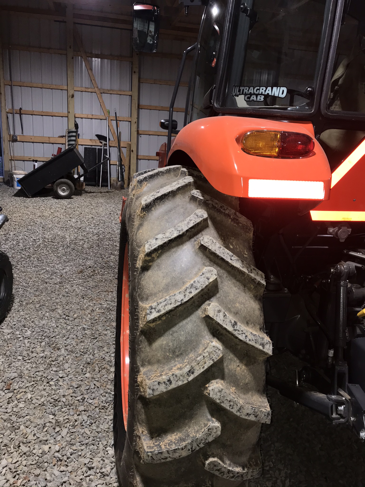

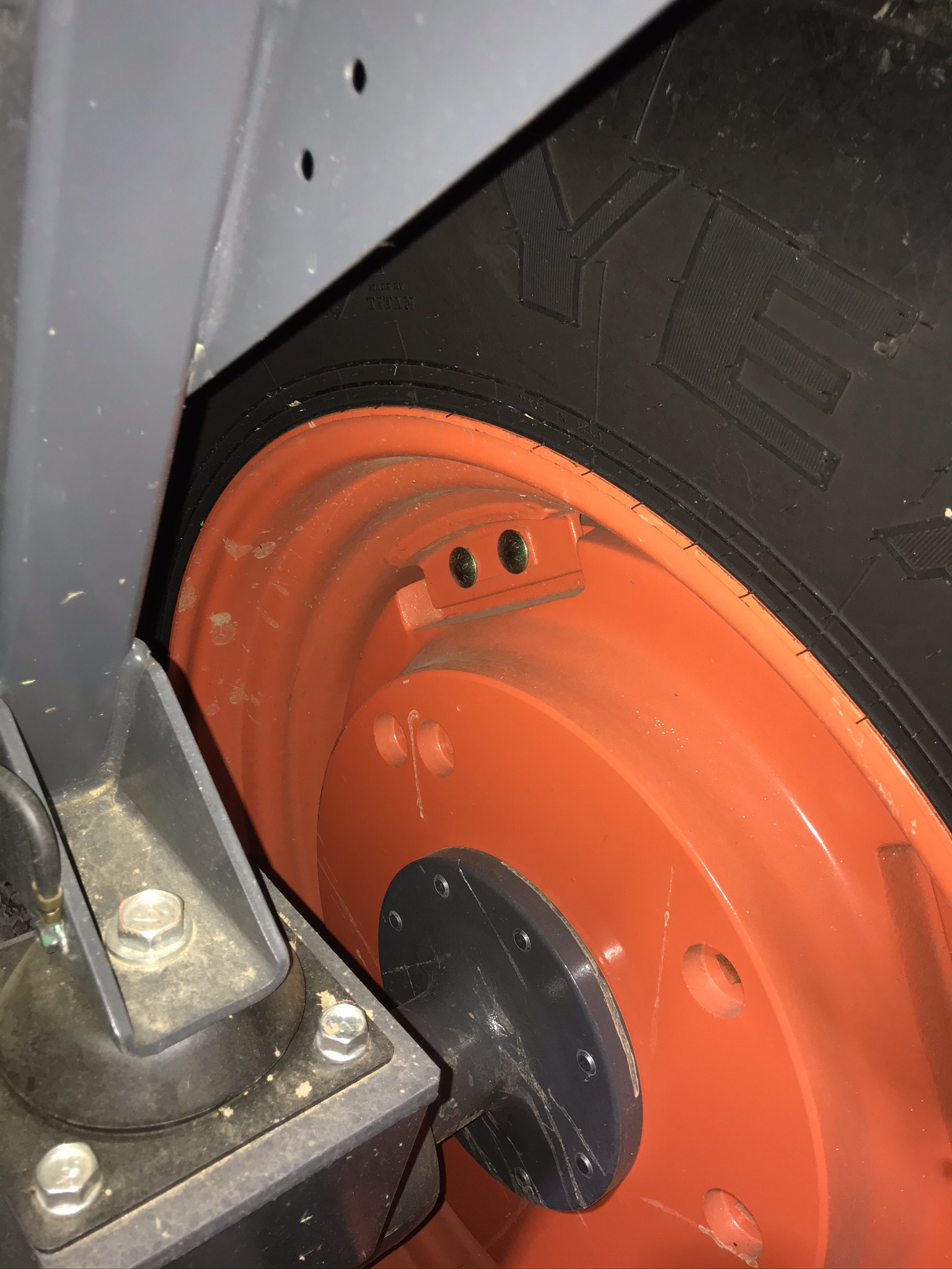

There was some interest in this setup. The outside width is about 84".

Been considering doing this to my cab tractor. What is the difficulty level of flipping the tires? Other than a heavy duty hydraulic jack, any special equipment needed?
   / M7060 Cast wheels at wider setting pics #3
Just don't dismount the center (if you can avoid it). The lug nuts are special items on the cast centers and if you do remove the centers from the axle flanges be sure to relieve all the weight with a shop crane before starting the nuts back on as the like to cross thread easily. Because of what I do, I keep my wheels in the innermost position all the time. No need to space them out.
The cast centers are very heavy (around 350 pounds each) so don't assume you can unbolt and lift off manually. Not gonna happen. Same with the rims with the tires mounted, very heavy even not loaded. Loaded, they are stupid heavy and must be kept vertical at all times. If one gets away from you and starts to fall, get away quick as it will crush your foot or break your leg on the way down,

Yeah, I knew about the centers and really the size and weight of the tires and rims is what's kept me from attempting it already. I'm a little over an hour northwest of you (Howell area) so I'm not sure Spec Tire would be an option for me. I'll definitely check locally to find someone since you've convinced me to leave it to the professionals. Thanks.

I had mine done by the dealer at the time of purchase so no idea on the difficulty. My wheels are also filled so there's no way I would have attempted to reconfigure on my own. Too heavy and not worth getting seriously injured or damaging something over.
I'm satisfied with the width as it feels stable on hills I need to mow. It has never felt light in the rear with this setup either. It's a beast in this setup.

The offset on your rear tires looks exactly like what I have on my M6040. Except I have ag rims. I was going to move the tires in one notch. Then I got to checking the weight of the rimguard + tire + rim. They are perfectly OK the way they are.

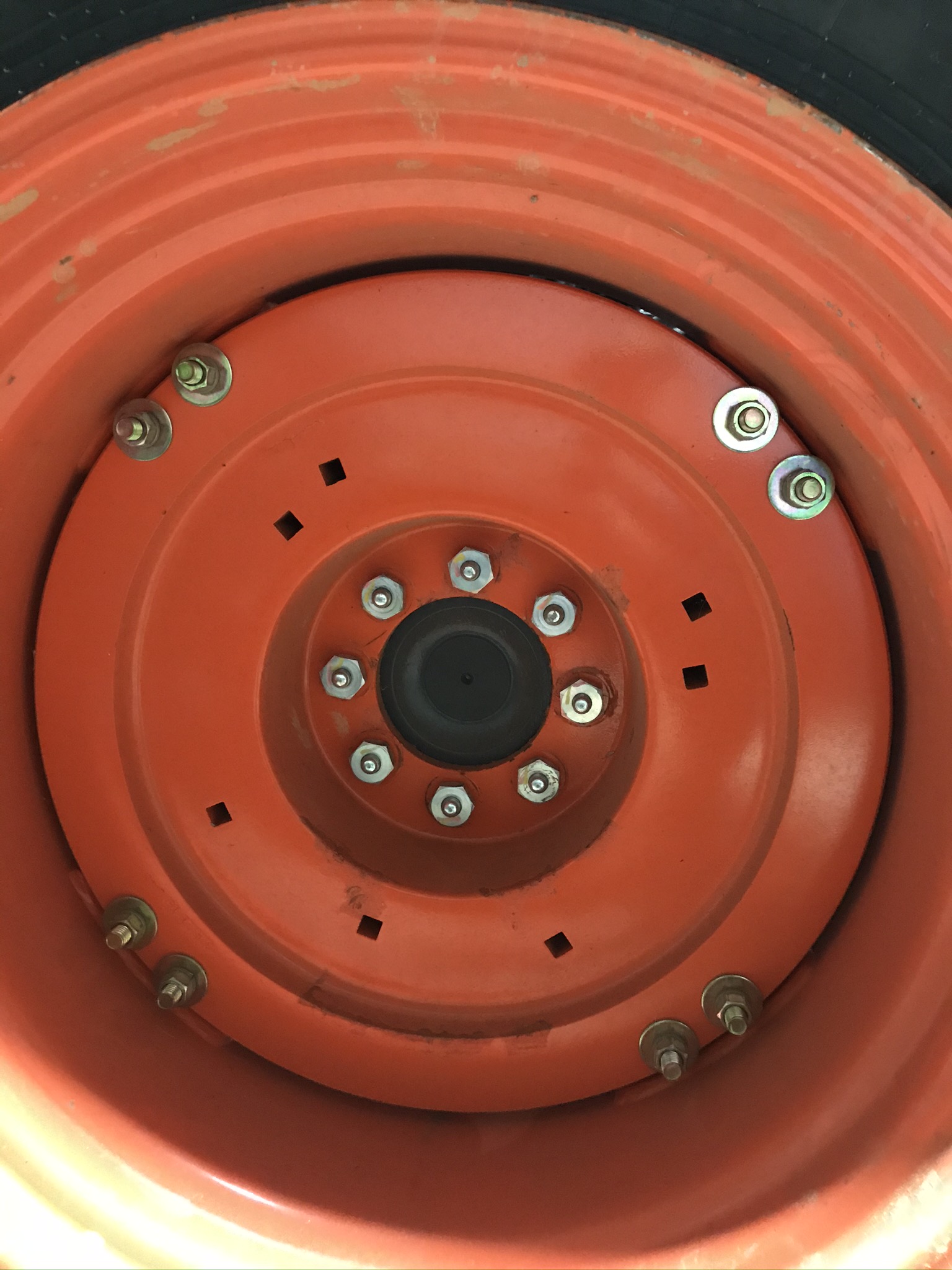

I was hoping to get to this task later this week but have wood to do now so.... maybe next week!! However, i think the rims can only go 'one way' due to the raised spot on the tabs on the rims, so these will end up on the 'outside' of the cast disk, not inside like yours, making them about 4" wider overall from yours. ( that could make it wider than my 84" bucket...) I'd like to get a rim apart and see if this is indeed the case.....
