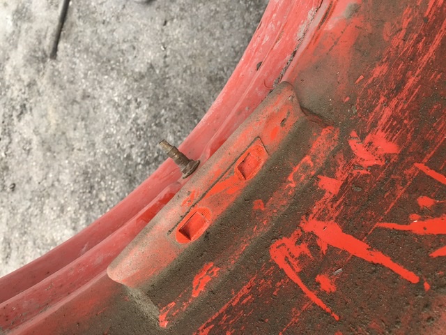

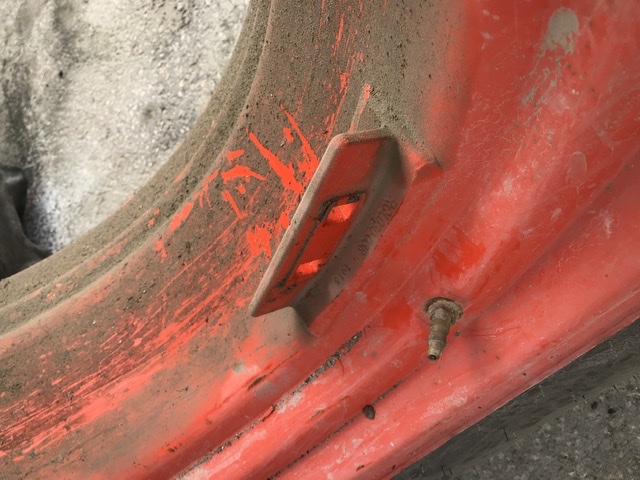

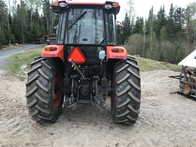

so finally got around and got some help...
My tires were at the narrowest setting. Once taking the disks off the rims, you can see both sides of the tabs on the rims have this raised spot so it don't matter what side goes against the disk meaning the cast wheel set up has 4 different width possibilities. We set these up like Herky did, #3 if you will.... Wheels are ~83" outside to outside, same as my bucket. could feel the difference immediately on the highway.
It took a lot of grunting, prying, jacking and use of the loader and someone who's changed many semi and loader tires who's smarter at this than me to make it happen. I'm glad i didn't try to do it on my own!! 6B8BFF7F-563D-400F-B88A-90C2A47450AE.jpeg933BB697-C384-4BA8-AB58-68AD26A89917.jpeg96068970-4B32-4215-AB7E-D49B3467F63A.jpeg
