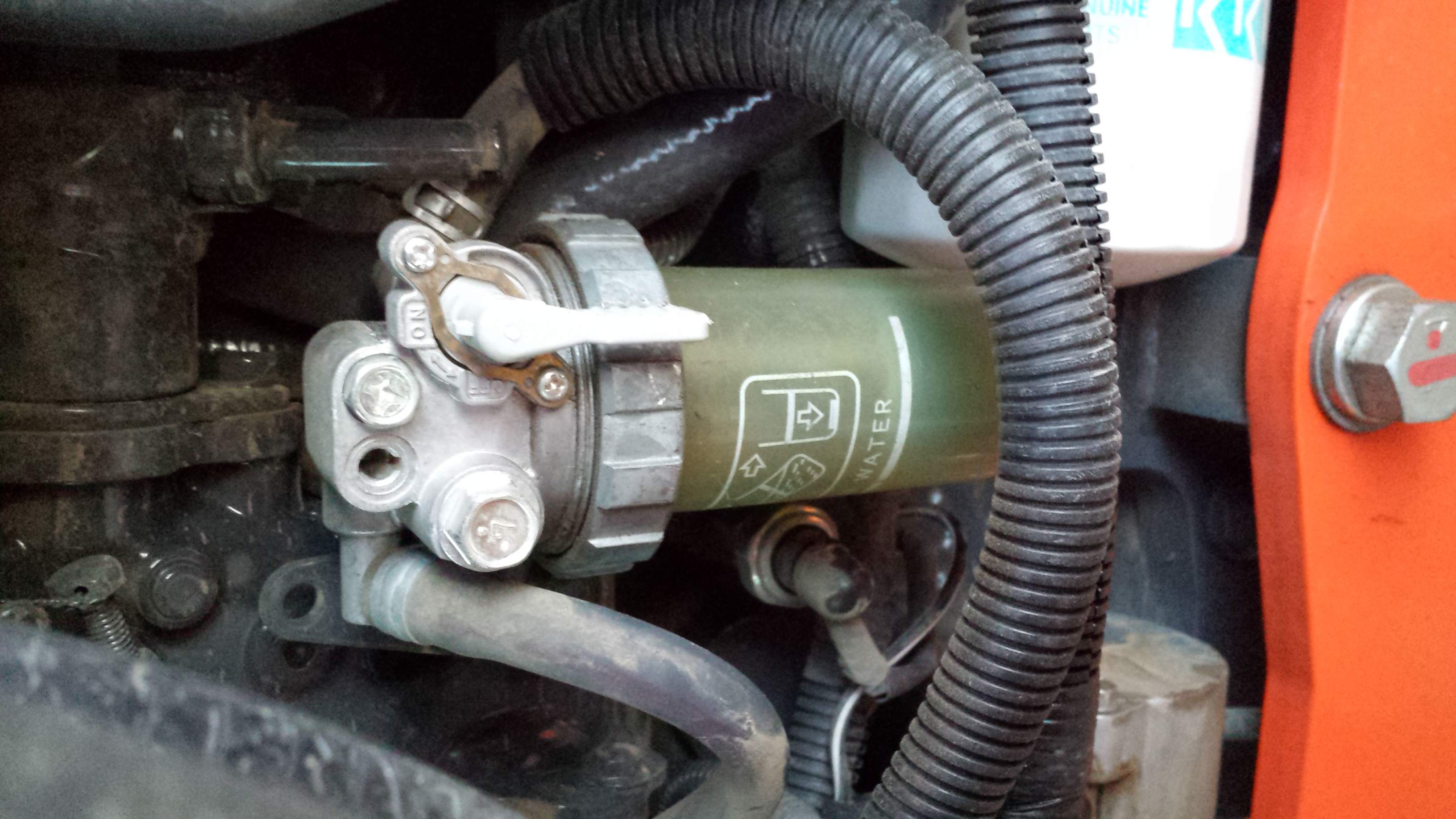

No idea what the galvanized screw is to the right of the shut off valve? It's maybe 10mm and a philips head.

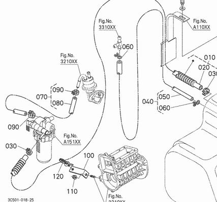

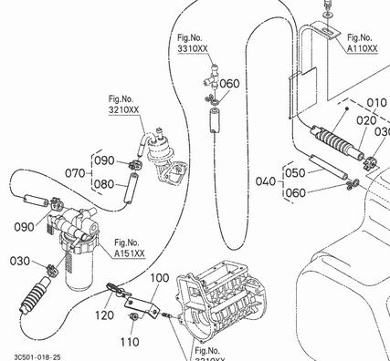

Here is a schematic. I think M7040 doesn't have a valve similar to what you refer to on the inj pump.

Here's a picture. Its actually above the valve. (sorry was working from memory)
Can not find the video again. I believe they shut it after the tractor was running so maybe the pressurized fuel is supposed to bleed the air from that point?
I came across the video trying to find one of a m7040 at idle. It surely doesn't sound like a skid steer etc where its just a smooth running sound. The engine itself is smooth but its got a pronounced cackle like an old tractor. I cant seem to hear it on youtube video's.
Another thing I noticed is that when its cold I HAVE to start it at half throttle. Some guys on here seem to start fine at idle. If I do this it will most likely start but its a gurgling mess for about 30 seconds before it can build rpm. Below 20f I'm not sure it would start at idle.
(I've replaced the fuel filter already and sorry the picture is sideways?)

its a bleed screw, loosen and pump primer till fuel comes out

I agree with screw OP inquired about being a bleed screw BUT if his engine is truly running bad loosening that bleed screw won't correct the problem.

So if you remove that screw you loose suction from the tank. Not sure what its purpose is but its not to bleed the system. I think you can use it to drain the bowl back to the tank before removal? Anyway, after messing with it and priming, I no longer have air bubbles in the top of the bowl while running. Noise never changed but I think all is good.

its to bleed water filter

But its the suction side?
/ M7040 fuel system bleeding #20
Are you concerned that water filter is between fuel tank & lift pump? My M7040 is one of the easiest diesel engines I've ever owned/worked on to bleed the air out of the fuel system and get it to run.
