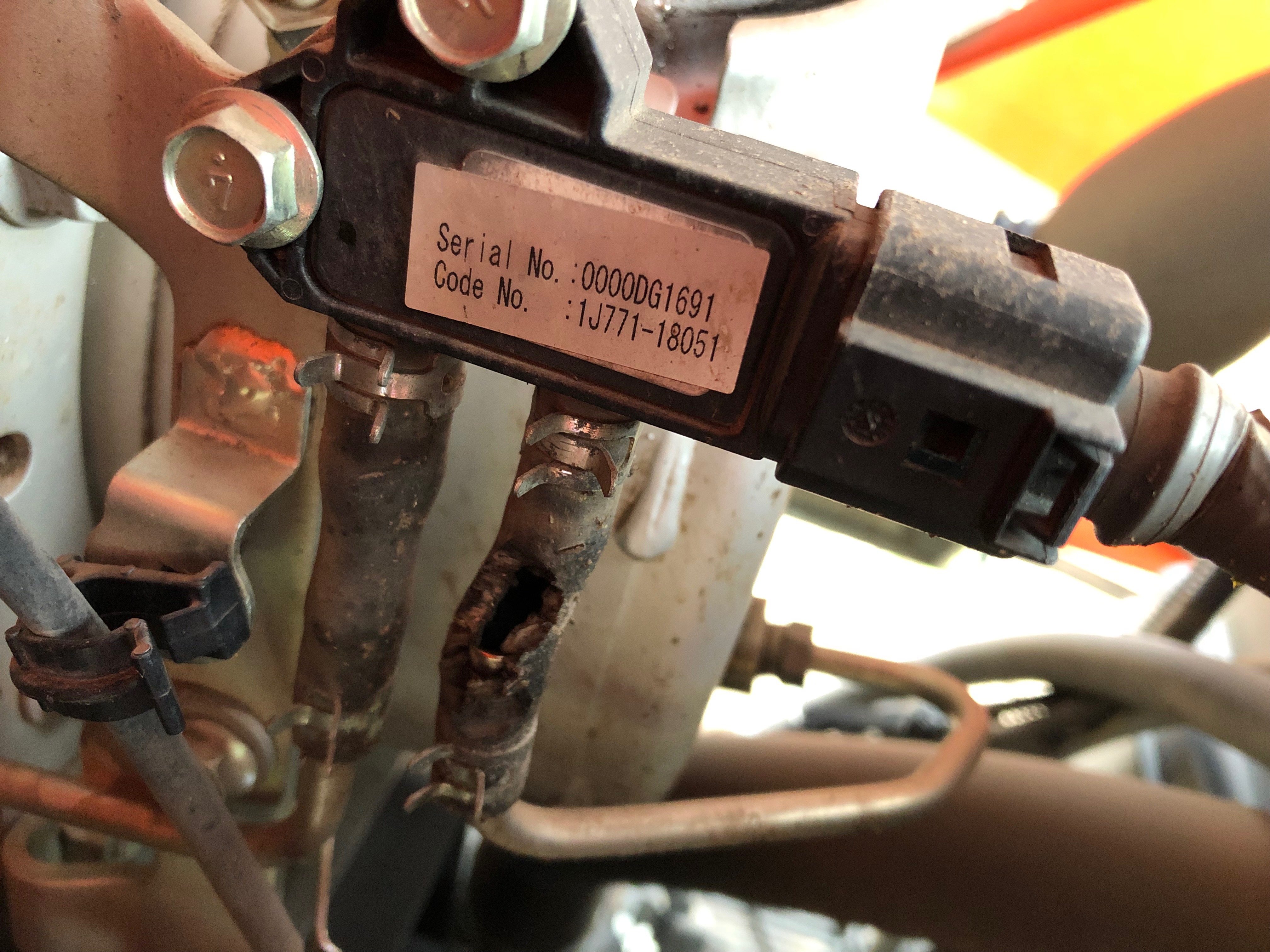

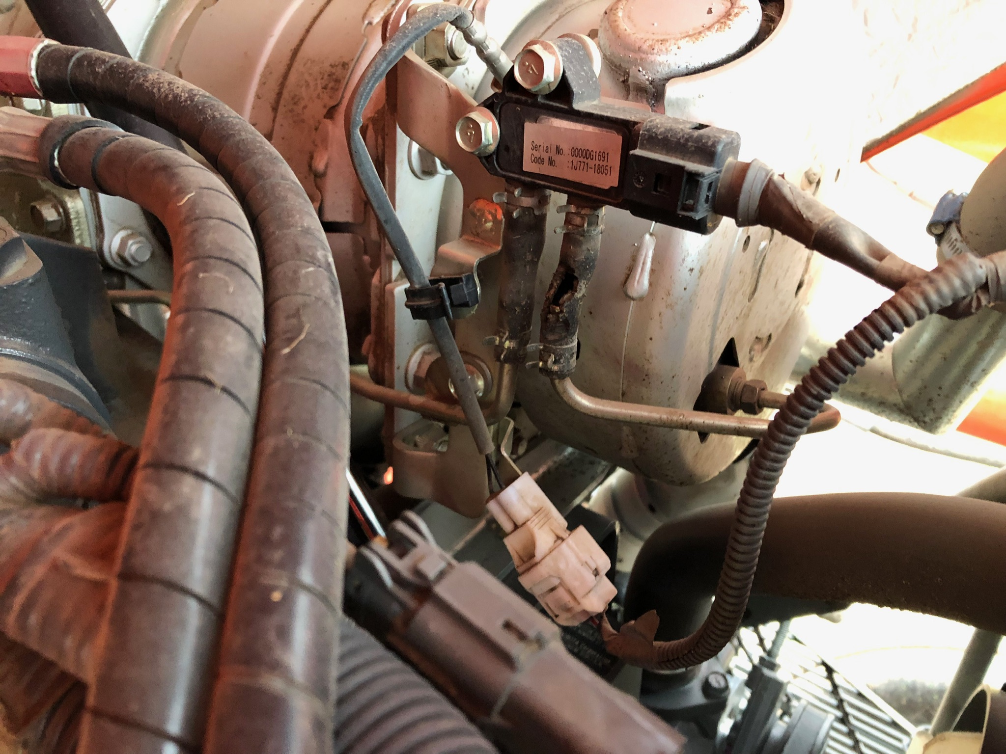

Guys worked the tractor hard yesterday and today... This morning I noticed the red light on the dash turned on. It was showing an emission fault. Tractor was running perfect but decided to head back to barn and check it out..
I was hoping a loose wire or connection around the DPF. After close inspection, I found a rat had chewed a hole through a rubber hose coming off the DPF. I had some old fuel line laying around so 10 min and it was fixed..
Man I was sweating it.. thinking the worse...
It ran the day before fine so rat must have done the damage in the night hrs... Any idea what this hose does? Sensor ?
Just a reminder to inspect the tractor before you call a mechanic.

The part can be seen under the Engine section of the parts drawings. See 378400 MUFFLER SENSOR
Part Description
SENSOR / SENSOR
Part Number
1J520-18600
Stock Status
2 in stock
Messick's Price
$192.36
See item 50 in the attachment

Hey, thanks for looking it up.. Figured it was some type of sensor..
I got lucky on this one...
