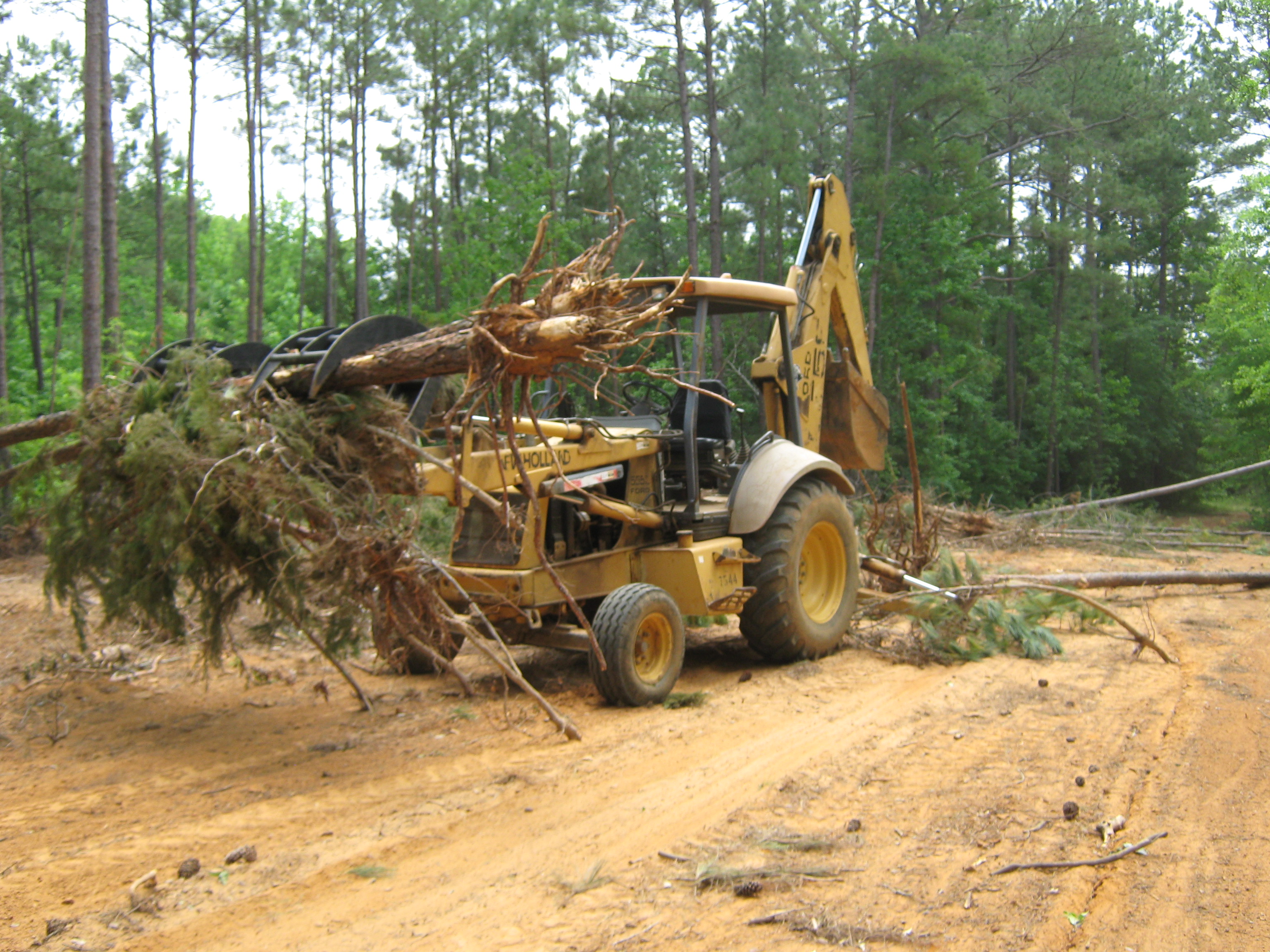

Every brand has a version with a removable front bucket. Most of them call it a tool carrier. You can remove the bucket and attach a grapple, pallet forks or even a hay fork. I modified my 555E to a quick attach so I could have a grapple. I can't think of nothing more useful for land clearing then a backhoe to dig out the trees, and then the grapple to pick them up and put them on the burn pile.
I'm thinking this is where I'm at. A M59 is going to take the whole budget by itself assuming I even find one that cheap. I could spend 15-20k on the full sized and have some money left to convert the front and buy a grapple.
