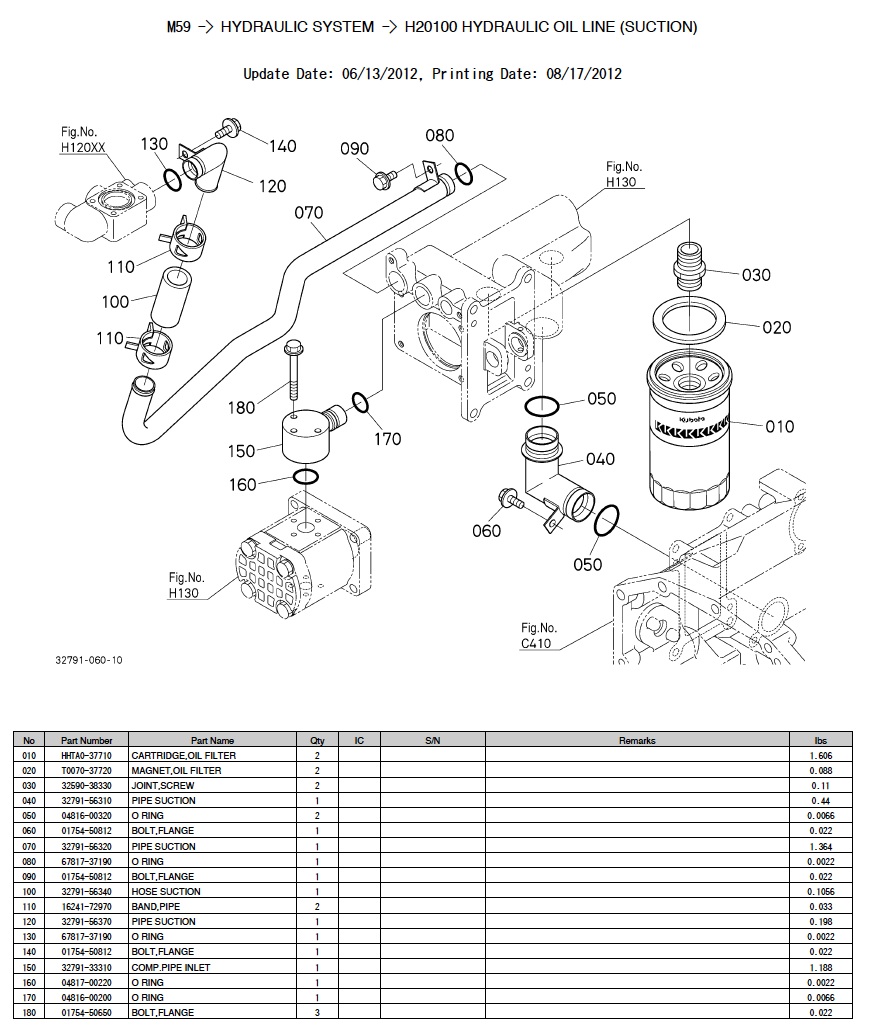

Is there anyway to keep the m59 hydro oil from being infused with air? I think its a big problem of mine. My tractor starts off digging good but loses power after it is worked(still!) So I took a small sample of fluid after being used and put it in a clear plastic container. It was milky with air. After it set a couple of days it was normal looking, no air. So the foaming has to be bad. I am running the new synthetic Kubota fluid. Maybe change to new fluid?
A cloudy appearance could also indicate water contamination, however the symptoms you report sound more like air entrainment. You can test for water contamination by putting several drops on a hot plate; if water is present it will sizzle.
Possible causes of air getting to the system are 1) reservoir level too low (probably ruled out), 2) a leak in the suction line anywhere from the tank to the hydraulic pump, 3) a damaged return line with fluid pouring into the top of the reservoir instead of discharging below the top level. The first thing I would check for would be 2). All it would take is a pinhole to get air entering the system during operation. A small leak would result is air entrainment and spongy oil; a large leak could cause pump cavitation and eventual destruction of your hydraulic pump. If there is any sign of static leakage around the suction line (when the machine is turned off) that would indicate a possible problem. Conversely if oil is placed on a clean joint or connection in the suction line, and it disappears during operation, that would indicate a point where air could be drawn into the system.
<img src="http://www.tractorbynet.com/forums/attachment.php?attachmentid=277104"/>
I'm sure it's air,mill take a pic tomorrow and post. You would think with all the testing they did they would find it. The oil clears air after it sits, that makes sense that it starts off strong but gets slow. Thanks

as of now i have smeared grease all over the pumps and suction lines, atleast all i could reach. this is what dealer said to do. no help. has anyone else ever noticed thier fluid when changing it? could this be normal for the M59? im trying to get it in the shop but absolutly need it every other day but will get it in befor 11/20 when warranty is up.

Thats where I get my samples, from the oil fill. I use a fluid extractor that looks like the tail end of a grease gun and extended the clear tube on it with 3/8" pex. It reaches the bottom of sump. if my tractor is sitting and i draw some out it is clear. start it and let it run for 5 min and the oil is entrained. with 20-30gpm and such a small sump on these things maybe this is normal.
