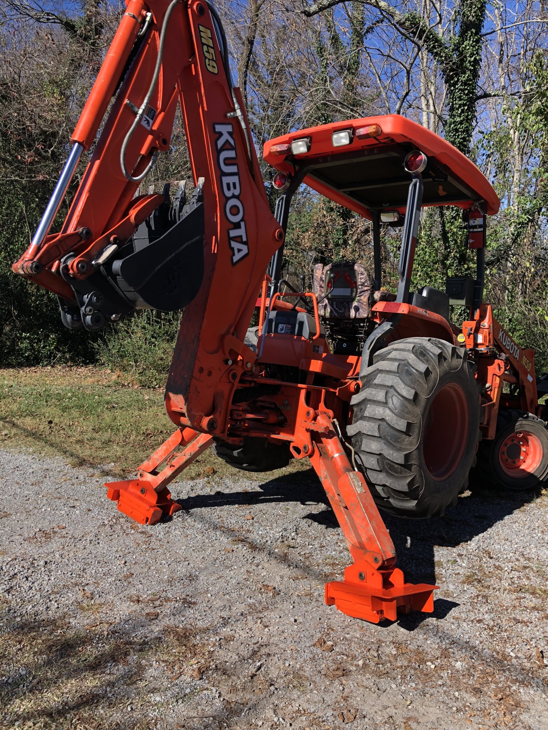

Had to take a second look:)
I really like the guard shield built into your mounting system! Clever.
A plan to steal🤪🤪🤪.
I often carry a chain saw along. Been electric now that they have gotten stronger:).
I carry chains all the time. I do plan on fabbing a couple of tool carriers for it.
It is now at the Kubota shop for some needed tlc and adjustments????????
Just hoping for good outcomes!!!!!
I’ll update when ever I find out?
There is a post of its fabrication evolution. Made to be easily removed yet tree fighting strong.

One of the best modifications with guidance of fellow member ā€œM59ā€ was to convert to KX Kubota QA excavator attachment coupler. Had to modify pin-on thumb. Coupler made by USA Attachments. We both have posts on the conversion. Consideration for future thumb. KX quick attach simple, easy strong and buckets are cheaper and more readily sourced.
If I’m seeing it right the bucket curdles a bit higher and the thumb is then a bit short with the different bucket adapter? That adapter allows for more and lower cost easier to find buckets? I looked up the USA attachment item and saw a thumb. Is that what I should have been looking for?

Kubota offers all the parts to convert to Kubota excavator buckets as well a thumb that is compatible. Common option on new M62. Too expensive for me to retrofit.
My M59 had a thumb with pin on bucket. Used buckets are impossible to find. Kubota buckets were also prone to breaks on the bottom plate. Pin on with thumb tedious to change. Some M59s had their own unique qa. Ears were expensive to adapt other buckets.
Mr. M59 found a solution that I copied. USA attachments, PGC-100, pin grab coupler M59-KX040, $921. We both had to modify our OEM thumbs.
How that coupler differs from Kubota’s version is not clear other than cost.
Sold my used Kubota bucket for nearly the cost of a new KX excavator bucket. At the time USA Attachments offered free upgrade to ESCO teeth from CAT type teeth. Smaller, sharper, longer lasting and better for lower hp M59.
