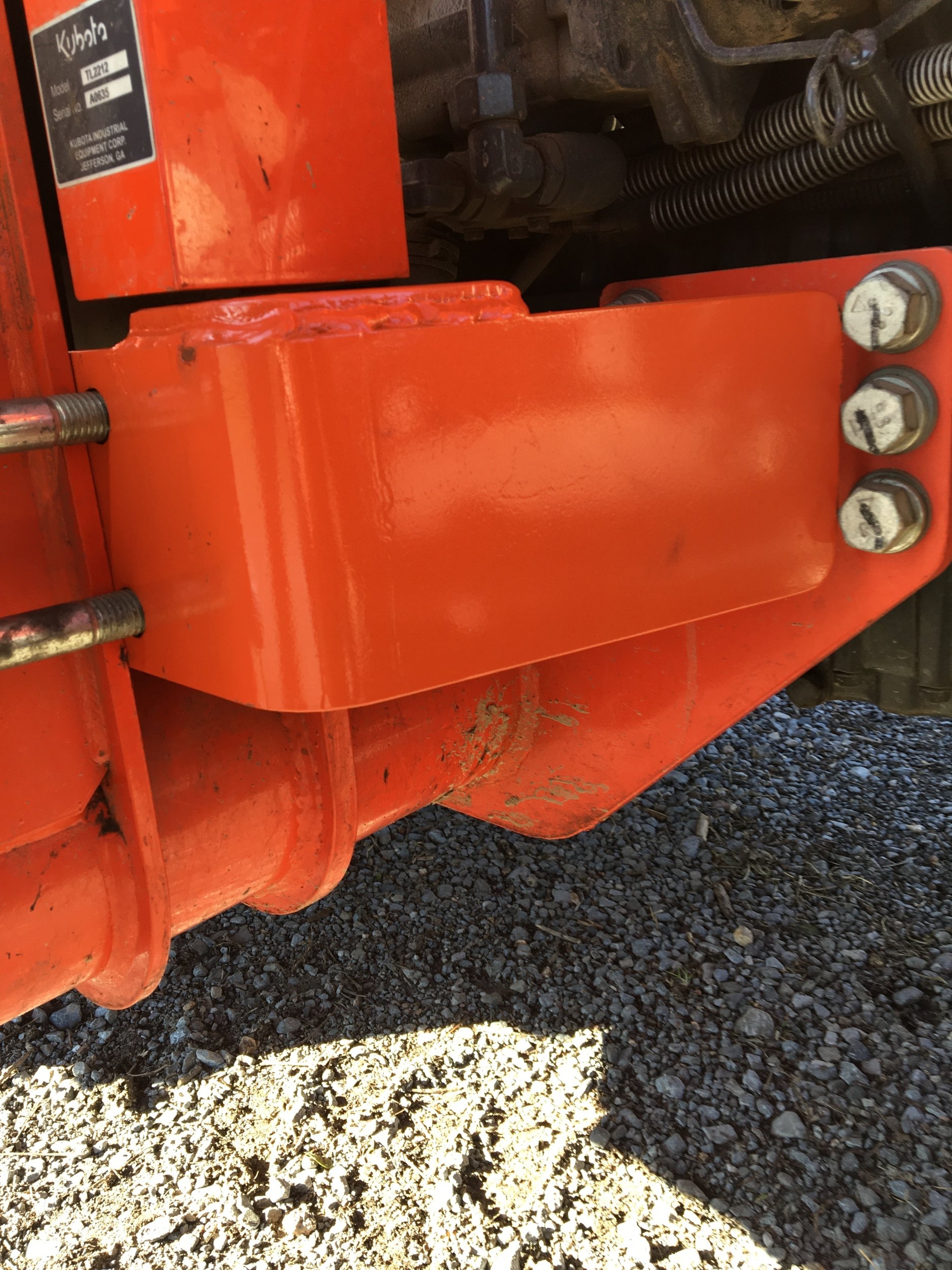

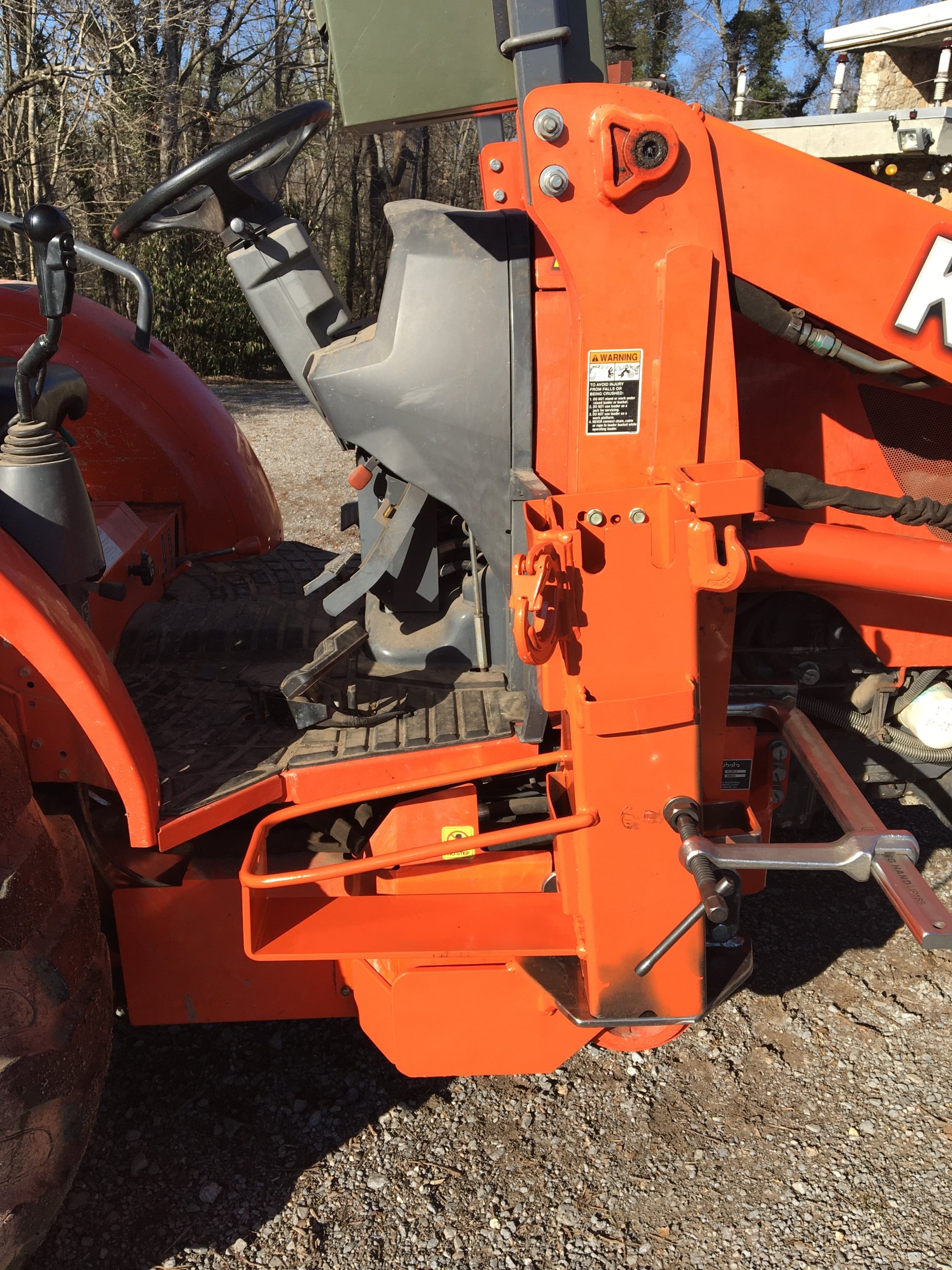

I really like the guard shield built into your mounting system! Clever.
A plan to steal🤪🤪🤪.
I often carry a chain saw along. Been electric now that they have gotten stronger:).

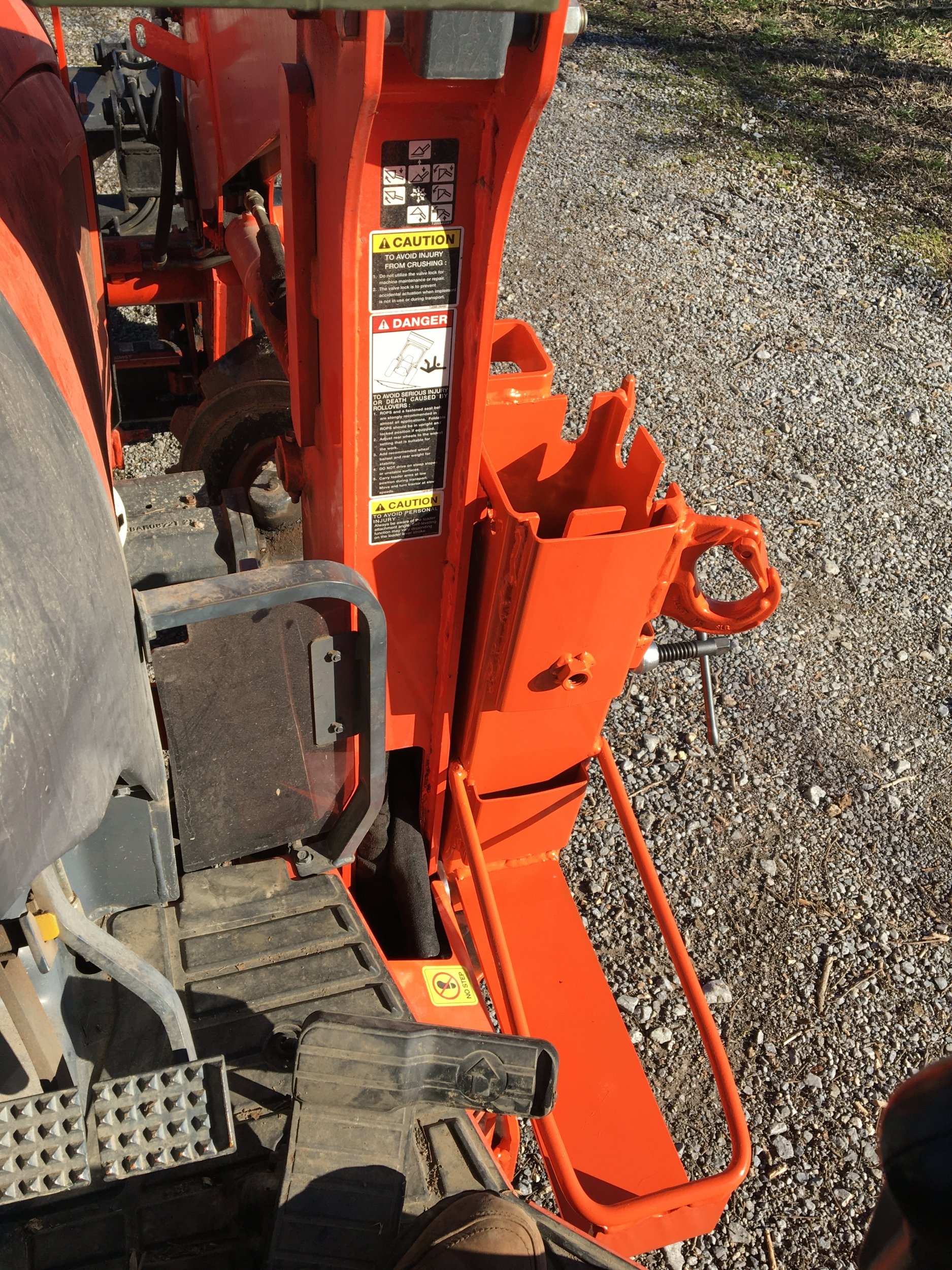

I carry chains all the time. I do plan on fabbing a couple of tool carriers for it.

There is a post of its fabrication evolution. Made to be easily removed yet tree fighting strong.

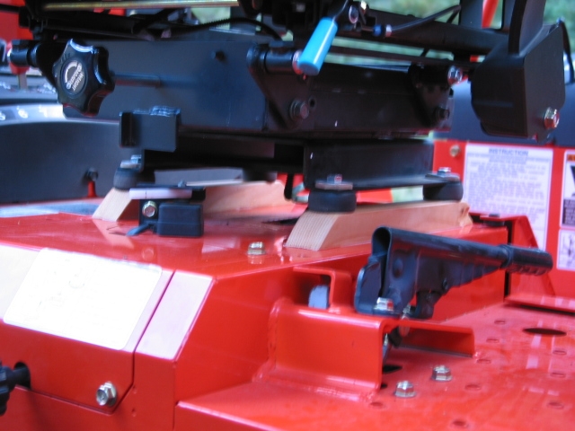

Both seat and parking brake have various switches that will have to be figured out if changes are made.
For example, on the M59 it is necessary to push in the clutch to start the engine when facing forward, but pushing the clutch is not necessary when in the backhoe position. There is a switch under the seat that tells the engine starter controller that the seat is reversed. If you raise the seat; raise the switch.

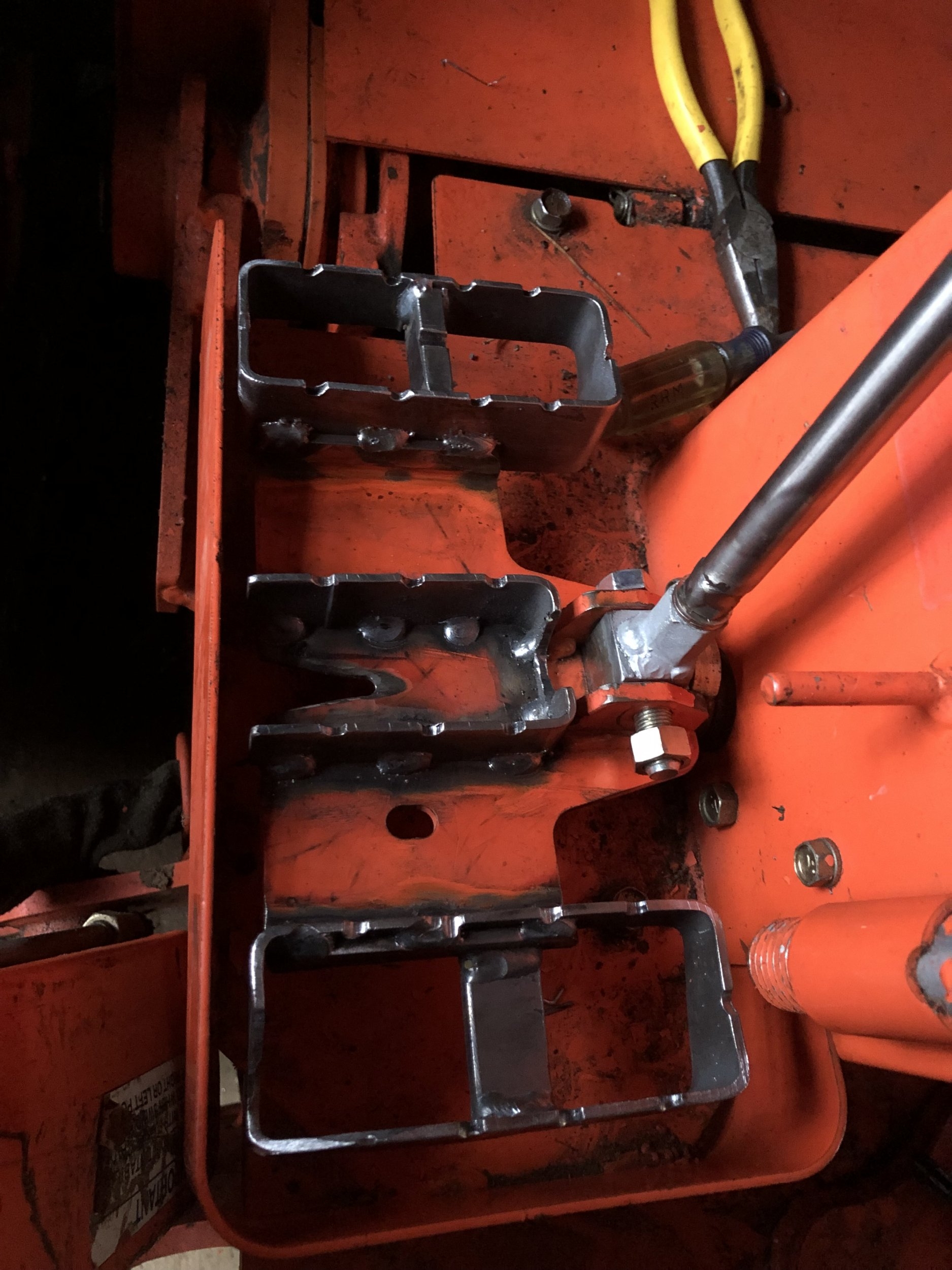

I like bolt-on chain hooks with backing plates. There's an outfit on TBN that sells them.
The backside of the backhoe control upright is a good place to hang a fairly large toolbox.

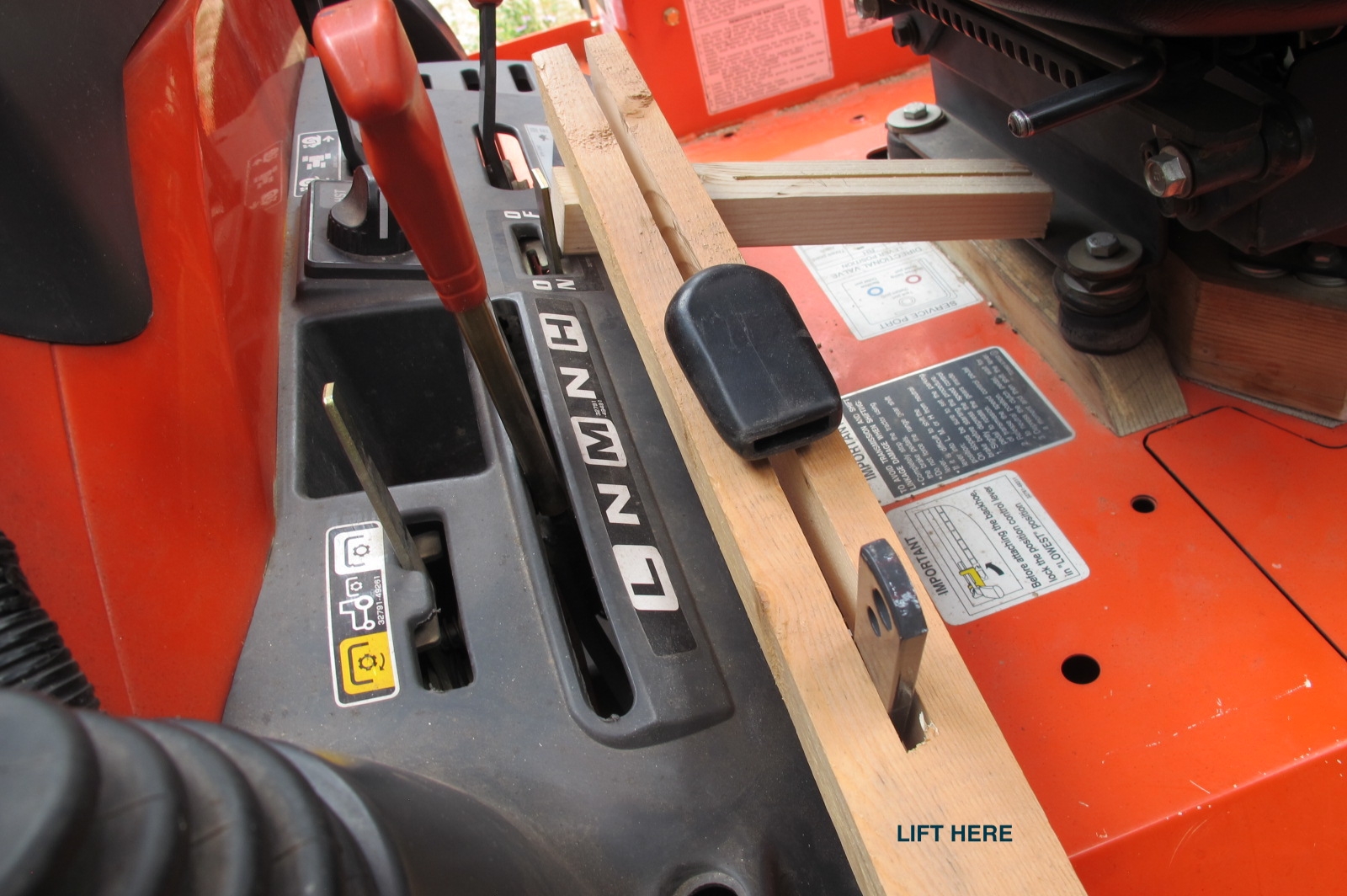

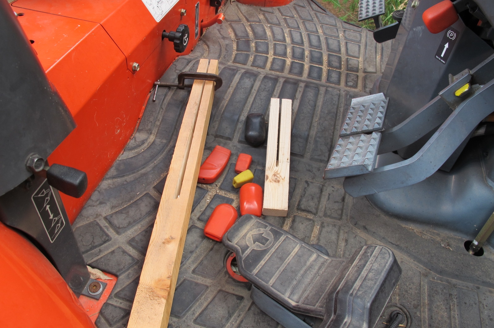

I'll attach a picture of an inexpensive seat mod for the large and tall operator.
There's a lot to discuss about backhoe thumbs. In fact, that's worth starting another thread so that the search function can find it in the future.
rScotty

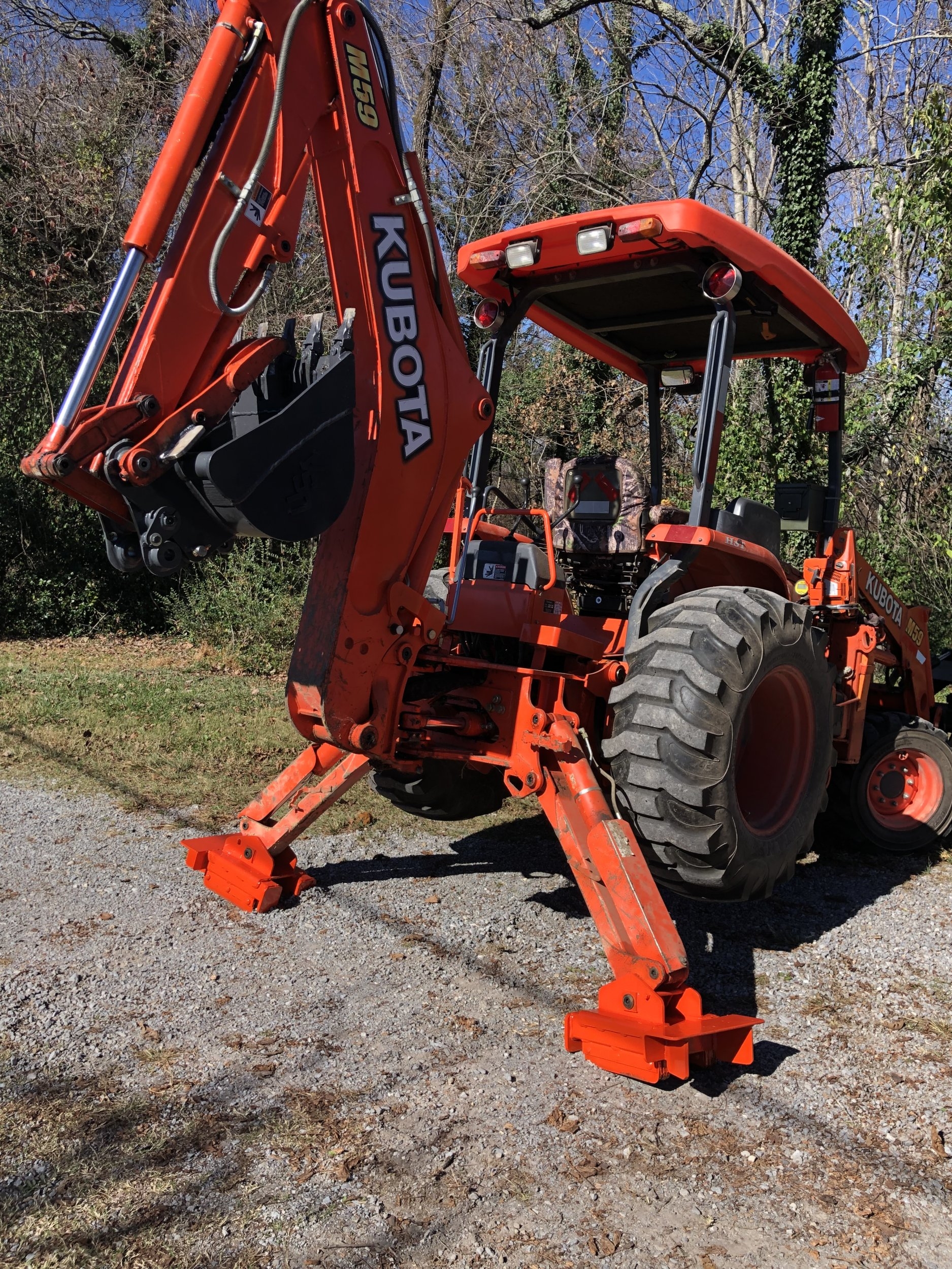

The M59 has been a fun platform to customize for our use. Compact, powerful, versatile and thoughtful ergonomics. Lends itself well to owner tweaking to meet their needs. Can’t think of anything that is perfect out of the box.
Grapples for handling trees and brush. 5’ long bottom, high back bucket with piranha edge is great digging and grading bucket. Like not having a wide bucket in tight spots.

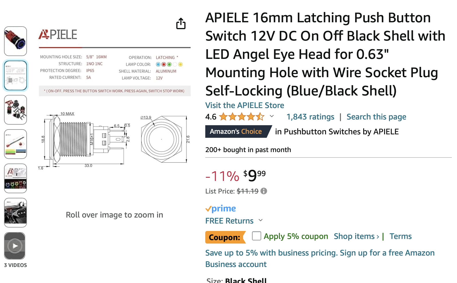

TM controller stands for Transmission-Motor Controller. 2 on the unit. Have not found them yet but could be the issue or the fuse powering them? TM explanation is not in the operators manual:(. About 80$ if needed. The ECU is 750$.
I will write of finding as soon as I get word.

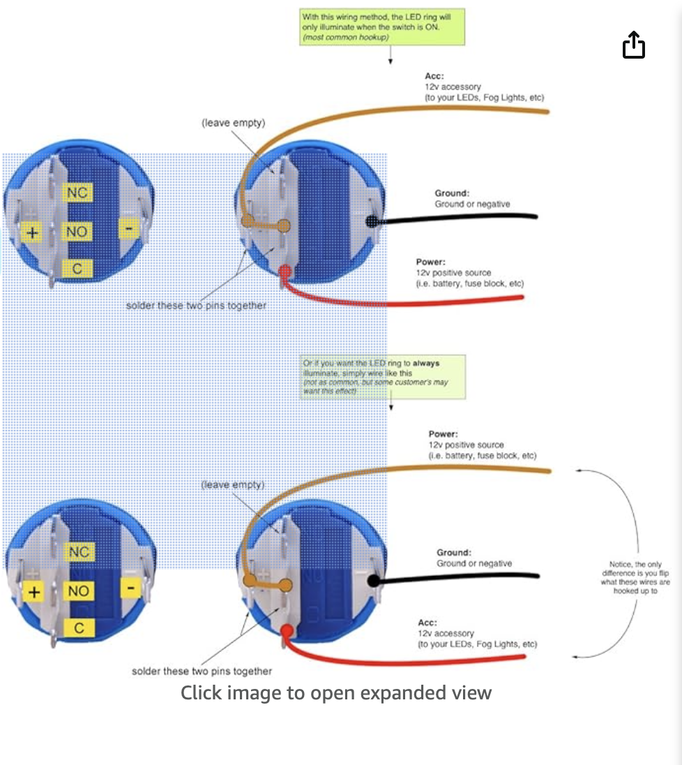

Yes, I have found those lock out switches and have set up switchable bypasses on the two icky ones:).
More work coming .
I will be lifting the seat in some fashion and removing that crap rear brake in hopes my big feet will fit through:).
I’ve seen the bolt on hooks and they are ok but I can weld 10 on in many places for the price of 2 bolt ones:).
Just have to be careful to pick good spots?
/ M59 HST no go? #58
You can weld the hooks on. I used to, but is the lip thick enough owhat do you do for a backing plate? Most loaders that can lift as much as the M59 have a thicker FEL bucket top lip. Still, a welded hook is just as strong. It may bend the bucket but it won't come loose.

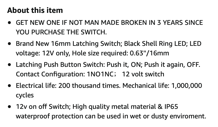

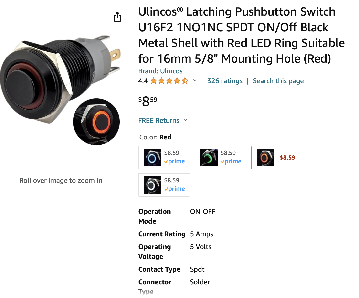

Update on what a TM Controller is?
Can not find it on the Coleman Electrical site? Other sources say there are 2 but I have not found them—-only the ECU.
Next week the service place says they will start on the unit. 🤞🤞🤞
