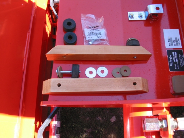

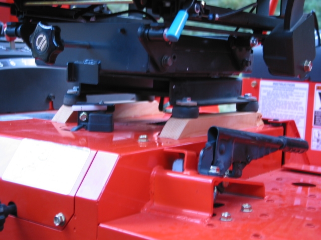

Both seat and parking brake have various switches that will have to be figured out if changes are made.
For example, on the M59 it is necessary to push in the clutch to start the engine when facing forward, but pushing the clutch is not necessary when in the backhoe position. There is a switch under the seat that tells the engine starter controller that the seat is reversed. If you raise the seat; raise the switch.
I like bolt-on chain hooks with backing plates. There's an outfit on TBN that sells them.
The backside of the backhoe control upright is a good place to hang a fairly large toolbox.
I'll attach a picture of an inexpensive seat mod for the large and tall operator.
There's a lot to discuss about backhoe thumbs. In fact, that's worth starting another thread so that the search function can find it in the future.
rScotty

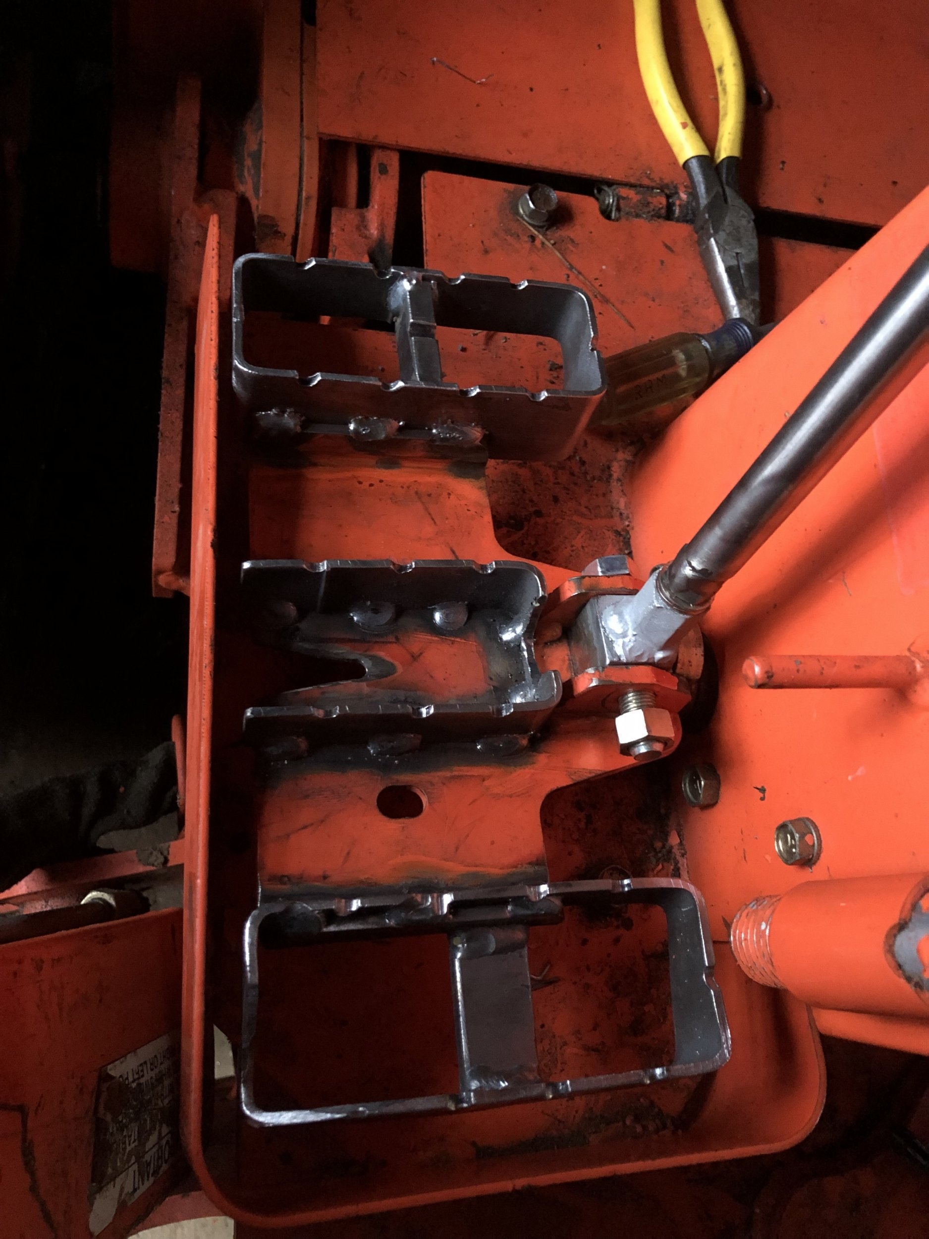

Haven’t look recently, but think there are two thumb options offered on the M59/62 depending on which QA option selected. Think the KX version has slightly wider and longer thumb for clearance for KX040 type QA.
The M59 foot control for thumb was awkward for me. Added better cleats and hand control lever. Improved my fine control and was easy to do retaining OEM features.
